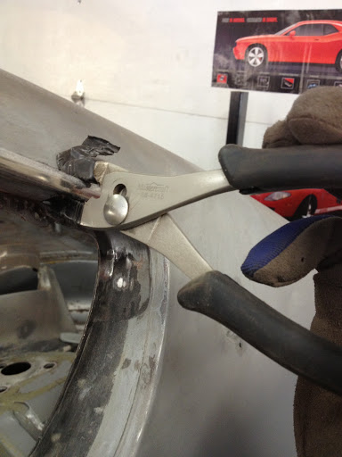

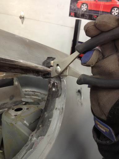

Yesterday I did the last few things needed to spray the high-build primer, including pulling the drip-rails off:
I used a pair of pliers that I've ground the teeth off of and wrapped with electrical tape, but I've also used an old-school bottle opener for this job which also works well!

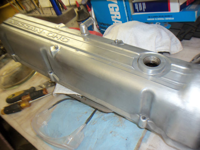

Valve cover done -

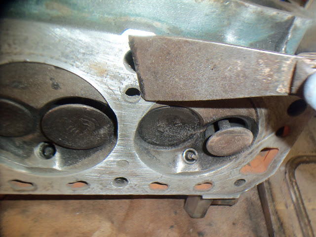

Cleaned up and re-installed the head today -
After utilizing all these tools to clean the surfaces I went over the head and block surface with a hard block and 220 paper -
I couldn't believe what happened next: as I went to blow the junk off and out off the heads orifices, a good amount of OLD GAS came out of the three valve pockets whose intake valves were closed. This is a car that has sat for 15 years, before being torn apart and being apart, for another 3 years! It certainly shows some very WELL-SEALED valves!!
A little oil squirted into each cylinder to guard against a dry start...
