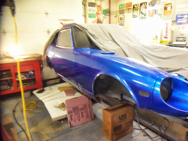

October 17, 201311 yr comment_433882 Looks great! I really like the color.Could you tell us what exact color did you paint? product code?Also, did you spray clear? Link to comment https://www.classiczcars.com/forums/topic/33358-e-tek-racing-71-parts-car-resto/?&page=18#findComment-433882 Share on other sites More sharing options...
October 18, 201311 yr Author comment_434019 tamo3 said: Looks great! I really like the color.Could you tell us what exact color did you paint? product code?Also, did you spray clear?You bet! It was done with Dupli-Color's "new" Paint Shop paint system, which is a DIY color system you spray right from the can - no mixing, reducer or hardener required. I used about 4 (quart) cans of their Deep Blue Metallic and 4 cans of clear, which are about $30.00 a can, so the total for the paint was about $250. Compare that to about $1000 for 2-part paint from a local supplier.I sprayed it from a $120 HVLP paint gun in my own shop, after draping the surroundings with plastic and watering down the floor. (Of course even doing so, the floor is now blue!) The paint went on easily, just make sure you have a cross-flow (fans sucking air through and out) and a GOOD "Organic Vapour/OV' rated mask. I used a P100 rated mask, which is not quite the same and got pretty high near the end....After a week or more you will need to buff it all out with a power buffer, which can be just as much (or more) work as the paint process to make it shine. That'll be down the road for me though, as I have a couple other project to get done ahead of it!Hope that helps - if you have any specific questions, fire away! Edited October 18, 201311 yr by e-tek Link to comment https://www.classiczcars.com/forums/topic/33358-e-tek-racing-71-parts-car-resto/?&page=18#findComment-434019 Share on other sites More sharing options...

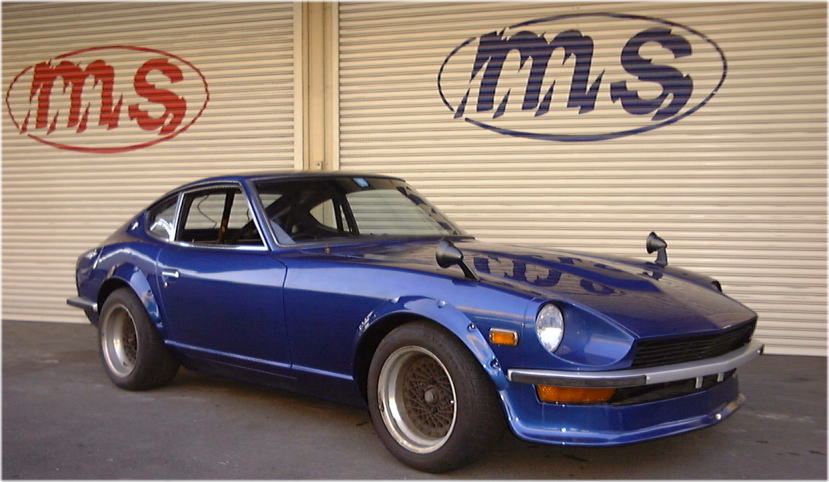

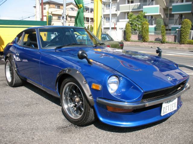

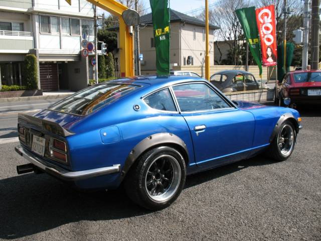

October 23, 201311 yr comment_434292 Thanks E-tek. Look forward to seeing the final results. In the mean time, I want to see more pictures. The color looks like a bit lighter. but some area shows purplish blue. Can you post more photos? I like this level of dark metallic blue But this level of metallic blue is also look nice. i wonder mixing with BSP210 - Midnight Blue with BSP204 - Deep Blue (Metallic) can make the color darker easily... Regards, Tamo3 Link to comment https://www.classiczcars.com/forums/topic/33358-e-tek-racing-71-parts-car-resto/?&page=18#findComment-434292 Share on other sites More sharing options...
