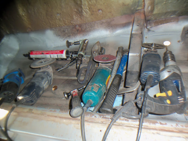

February 19, 201312 yr Author comment_415380 Fitting and trimming inner fender. Perfect butt weld gap Tools. Dash is perfect, so I'm trying to keep it that way. Link to comment https://www.classiczcars.com/forums/topic/33358-e-tek-racing-71-parts-car-resto/?&page=6#findComment-415380 Share on other sites More sharing options...
