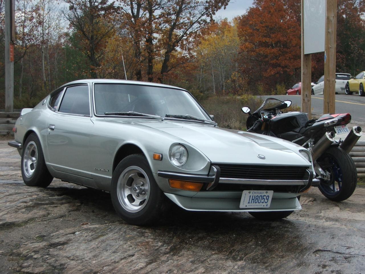

March 13, 201312 yr Author comment_417671 This is Zedyone_kenobi's ride and mine will be a near clone of his. Same color, same wheels. The only difference is that I have the full front air dam on mine. Dupli-color has already supplied the paint for it! Link to comment https://www.classiczcars.com/forums/topic/33358-e-tek-racing-71-parts-car-resto/?&page=8#findComment-417671 Share on other sites More sharing options...

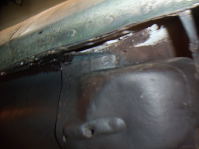

March 15, 201312 yr Author comment_417829 Just one small piece left to fab up for the drivers rocker before getting onto sanding.... Pattern - Worlds best metal sheer - Over to the brake - Putting a bend into it - After welding it in and applying seam sealer to the edges, it was done. A quick coat of the Duplicolor undercoating and it blended right in. Then I spent the next 4 hours sanding and stripping the engine compartment paint....yuk. Edited March 15, 201312 yr by e-tek Link to comment https://www.classiczcars.com/forums/topic/33358-e-tek-racing-71-parts-car-resto/?&page=8#findComment-417829 Share on other sites More sharing options...

March 21, 201312 yr Author comment_418566 Lots of repairs where done in the front wheel wells of the 240Z, so I put another coat of Dupli-color's Undercoating on some thin spots - ...and got very close to finishing the quarters - A final sanding and they'll be ready for primer! Got the windsheild out today as well - Link to comment https://www.classiczcars.com/forums/topic/33358-e-tek-racing-71-parts-car-resto/?&page=8#findComment-418566 Share on other sites More sharing options...
March 23, 201312 yr Author comment_418682 Found this side view before photo and thought I'd put next to Zenobi's side shot: Keeps me motivated!! Link to comment https://www.classiczcars.com/forums/topic/33358-e-tek-racing-71-parts-car-resto/?&page=8#findComment-418682 Share on other sites More sharing options...
