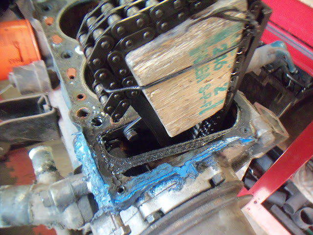

April 2, 201311 yr Author comment_419364 Continued the tear down today.... and found some sketchy leak repairs but the cam looked pretty much perfect! Before taking the head off I made my own cam chain block to ensure I don't loose the timing - The front corner had a leak repaired - the source of which was a break in the front portion of the head gasket - With the head off, I could see that although the pistons had some carbon buildup, the cylinder walls were smooth as a baby's-y'know-what with very little ridge buildup - I measured the cylinders for wear and roundness and they came in nearly perfect, so I decided not to go at the bottom end and just do the gasket and paint rebuild. By sealing up the leaks and replacing all the wear parts, plus gasket-matching the manifolds and rebuilding the carbs, I think (Ok hope) it'll be perfect. Time for the cleaning to begin! Link to comment https://www.classiczcars.com/forums/topic/33358-e-tek-racing-71-parts-car-resto/?&page=9#findComment-419364 Share on other sites More sharing options...
