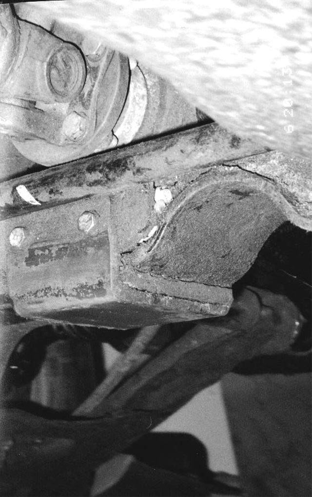

Another alternative is the fairly simple solution used on the SCARAB's... Simply bend a 3/8's steel plate to wrap around the bottom of the cross member and put some rubber between it and the cross-member. Then bolt it to the stock mount.
Search for Paul Richer Differential Mount on HybridZ.org. Simple to make and cheap too.

The clamshell works too and should be easy to make. Either is WAAAAY better than Nissan's original strap design and should solve the clunk. I'd get a rubber foot from the hardware store and put that on the top of the clamshell part so you have rubber on both sides of the diff crossmember.
