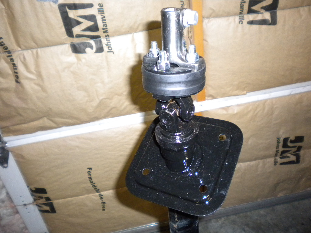

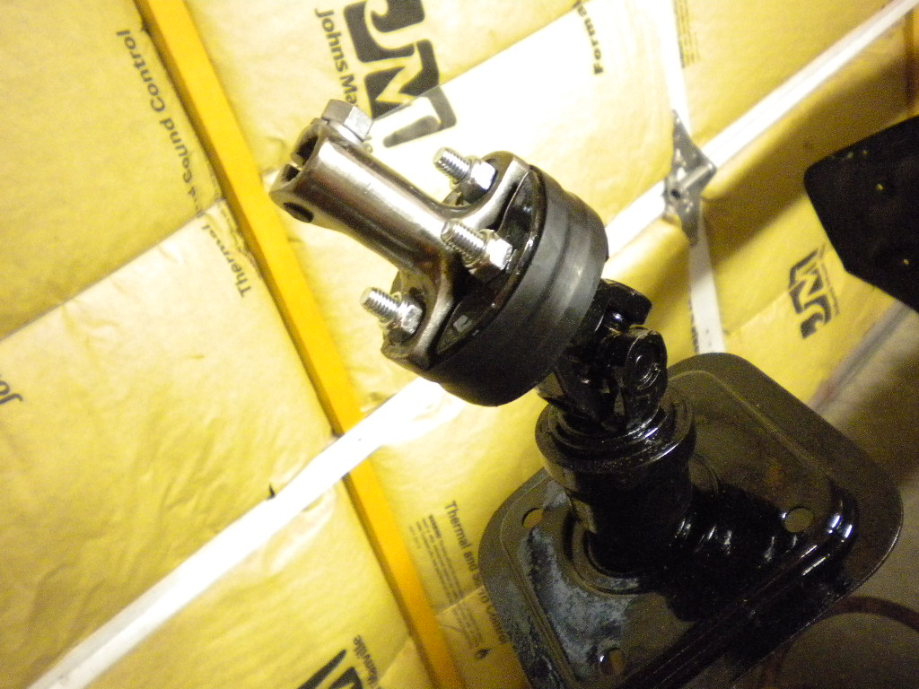

Just did mine as well but the whole column was out of the car. My 240Z's shaft is able to move in and out of the shaft but the 260Z's shaft seems to be solid. I also beplaced the bolts and nylon locker nuts. And yes, more POR15 as it's below what turned out to be a leaking master cylinder, rust was abundant.
The Urethane bushing allows me to feel a more responsive steering and speedbumps at an angle are a pain, if you're not holding on tight.
