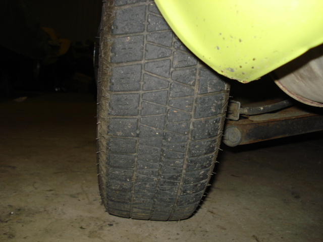

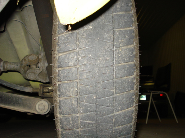

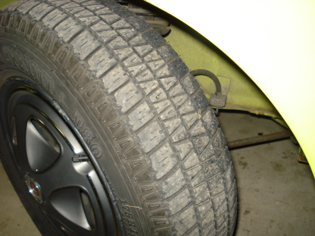

Can you post a clear picture of the wear pattern on the rears? Might be best to post the better of the two, easier to diagnose from one with a little left rather than one that's way bald.

No obvious wear patterns there. Front looks better, but might show a bit of toe-out, looking at the wear on the inside shoulder. I'd probably have the alignment checked just because, but it doesn't look terrible.
Looks like you never rotated the tires, which would have tended to equalize the wear some. But that only means that the rears would be a bit better and the fronts a bit worse. Not a deal breaker either way.
Larger issue is your expectations. While I have no personal experience with them, those Vreds are not known as being a particularly long lasting tire. I would not have expected to get more than 30-35k miles out of tires like those, at the very most. Add to that the fact that you are driving a light-weight sports/GT car, and maybe 20k might be all they'll reasonably go.
