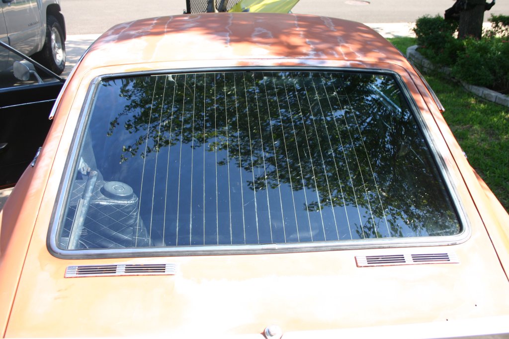

I just happen to glance over at my 240Z on the other side of the driveway and about die...the entire rear hatch glass is shattered!!! The whole thing is still in place though it's spiderwebbed and every now and then I can hear more cracking taking place.
I'm doing my best to remain calm and not totally freak out. I closely look over it and see what appears to be a slight outward bulge in the lower right area as if someone or something had hit it from the inside causing it to break. My first thought...it's got to be the girl (she's 5, can open the car doors on her own, and loves the Z). I march straight inside to the living room where both she and her brother (3yrs old) are watching TV (again remaining calm). Turn the tele off and sit them both down in front of me asking if either of them were playing in/around the Z today or yesterday. Of course nobody has a clue what happened and neither child claims to have been anywhere near the car. True or not I may never know. I advise them that this is their one chance to tell the truth and if they don't and I find out about it later they will be in big trouble for lying. Still nothig. Ok then, we are done.

For anyone who wants to see here's a link to a few pix I took of it: http://www.pape.ws/gallery/v/Our_Life_Together/Our+Hobbies/Allan_s+Hobbies/240Z+Car/My+First+240Z/Mystery+Of+The+Shattered+Hatch+Glass/?g2_fromNavId=xa62b5e15

completely spidered with no entry wound. In cleaning up the mess, I found a .177 caliber pellet inside the car in the hatch area it must have come through the open door window and popped the hatch glass.

Yep sure do. Toughened glass, like that used in car windows will spontaneously shatter due to thermal stress. Doesn't happen very often, but often enough for it to be a known phenomenon. Happened to the sliding door in the house last summer.
http://en.wikipedia.org/wiki/Spontaneous_glass_breakage
It would require a mistake on the installation side or possibly some rust developing along the edges of the hatch.
A friend of mine had a similar issue on his 300ZX where a small amount of rust put tension on the glass and when he hit a bump, the pane developed a 12 inch crack. If the pressure had built up sufficiently, I suppose the glass could have shattered as in your case.
