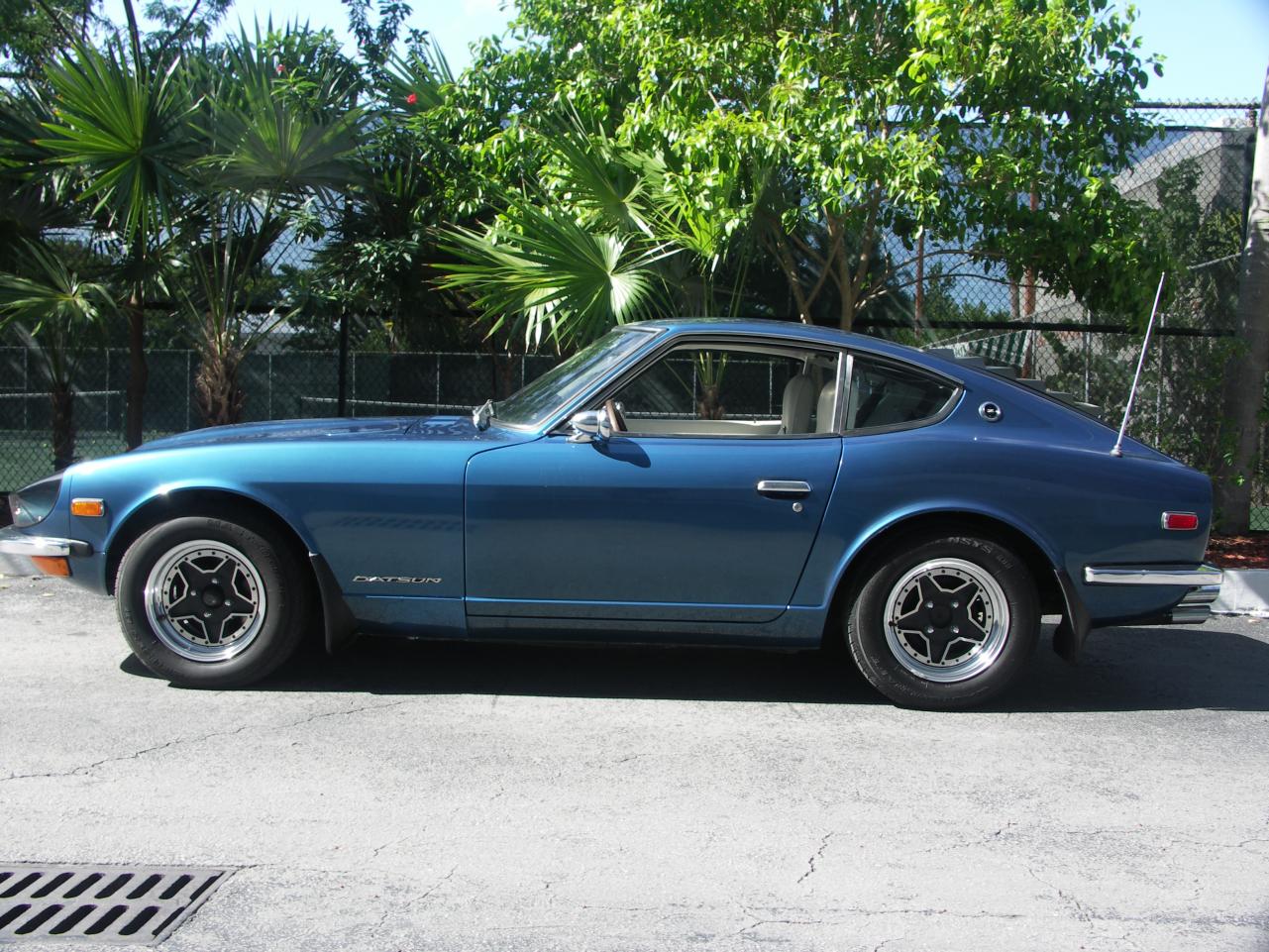

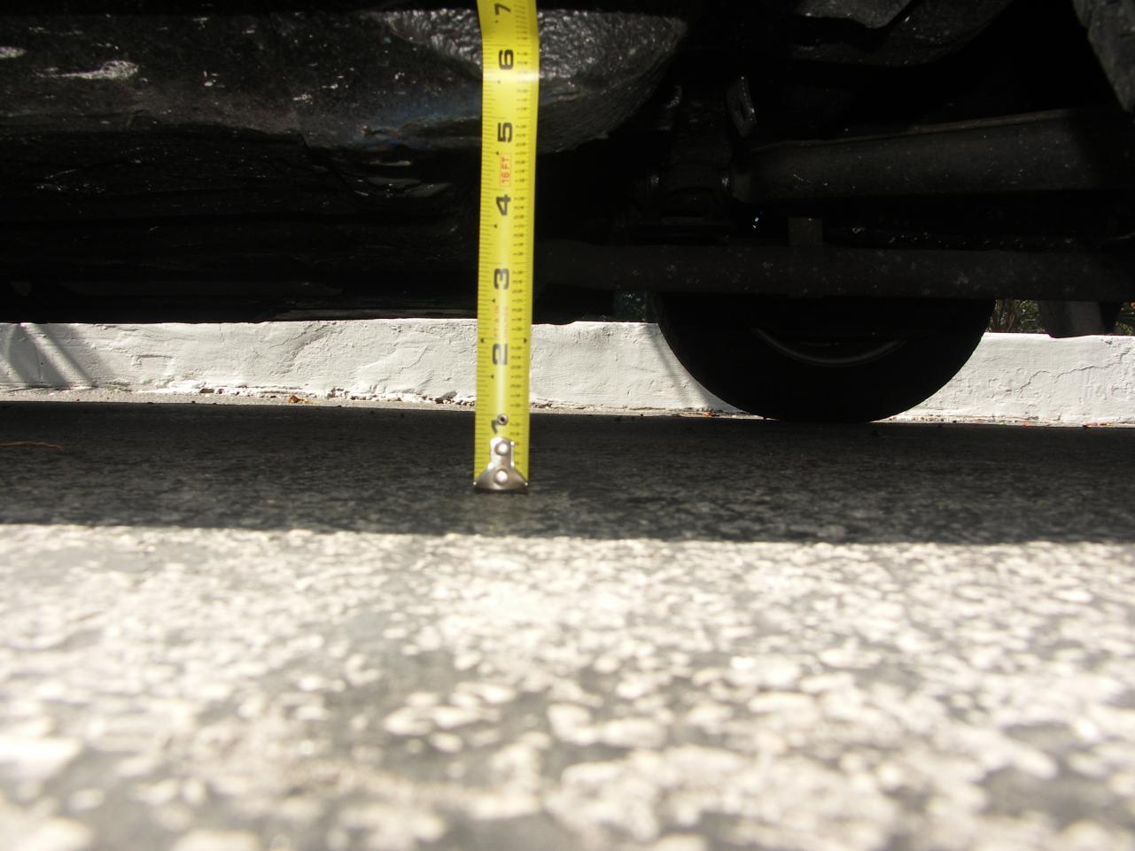

October 26, 200915 yr Author comment_298506 The initial configuration was the Tokico Illumina adjustable struts, Tokico 5020 Springs,195/50 Yokohama H4’s(AA traction Rating) on Konig 14” rewinds, 1” diameter Anti-sway bars front and rear, and front and rear shock tower support bars. I'm thinking that a 1" front/rear sway bars, combined with front/rear shock tower support bars, plus 50 series tires would make any set of springs ride really rough. In any case, I'm assuming my stock springs are shot, given that my rear bottoms out on nearly every bump with two people in the car, so I don't think I should re-use them. Does this make sense? Any chance its just the struts? I doubt it, as the car doesn't have any extra bounce, and the struts have only about 20k miles on them (they're almost 20 years old, though). Attached are two pics, demonstrating the car's ride height. The one with the tape measure is showing the lowest point of the frame rail just inside the dog leg, without me sitting in the car. It's well under 6 inches. The wheels/tires are 185/70/14s. I'm refinishing the center caps. I'd like bigger wheels, but I sorta like having these old Keystones, because the seem rare. If I could be sure that the Tokico springs wouldn't lower the thing any more than it already is, I think I'll get them. At its current ride height, the rear mud flaps drag on speed bumps, damaging them. This might not be so bad if the rear didn't sag so much with my 200lbs sitting in it. Thanks for the input, nice discussion... Matt Edited October 26, 200915 yr by ConchZ Link to comment https://www.classiczcars.com/forums/topic/33587-struts-and-springs-buying-guide/?&page=2#findComment-298506 Share on other sites More sharing options...

October 27, 200915 yr comment_298669 In any case, I'm assuming my stock springs are shot, given that my rear bottoms out on nearly every bump with two people in the car, so I don't think I should re-use them. Does this make sense? Any chance its just the struts? I doubt it, as the car doesn't have any extra bounce, and the struts have only about 20k miles on them (they're almost 20 years old, though). Attached are two pics, demonstrating the car's ride height. The one with the tape measure is showing the lowest point of the frame rail just inside the dog leg, without me sitting in the car. It's well under 6 inches. The wheels/tires are 185/70/14s. I'm refinishing the center caps. I'd like bigger wheels, but I sorta like having these old Keystones, because the seem rare. Hi Matt, Just did a check on my two Z's here. Both are equipped with stock springs (both nearly 40 years old). The Silver Z has the Illumina's with 205/60/16 tires. The Gold Z has stock shocks (1 year old) and 185/70/14 tires. I measured at the same location you did for both cars. On the Gold, the height is 5 5/8". On the Silver the height is 6 1/4". The difference in height is definitely a result of the difference in tire size. Not sure if the shocks impact the height at all. Regarding the car bottoming out, I would say it is definitely the shocks. 25 years ago, I drove the Gold Z up to Idaho for my folks and it was the sweetest drive of my life. It was the perfect road trip. I drove it back from Idaho last April and it was pure misery. The shocks were toast. It was like driving a boat. Add 50 mile an hour winds along the Columbia River and you have a recipe for disaster. The car bottomed out numerous times on the 1200 mile trip. Due to the shocks being so bad we did not take the car much above 60 mph. Once back in San Diego, I installed the new shocks and it was like a new car. The ride is soft compared to the Illumina's, but definitely a great improvement in the handling and no bottoming out at all; even with two people. Attached are some pics of the ride height for both cars. Rich Link to comment https://www.classiczcars.com/forums/topic/33587-struts-and-springs-buying-guide/?&page=2#findComment-298669 Share on other sites More sharing options...
