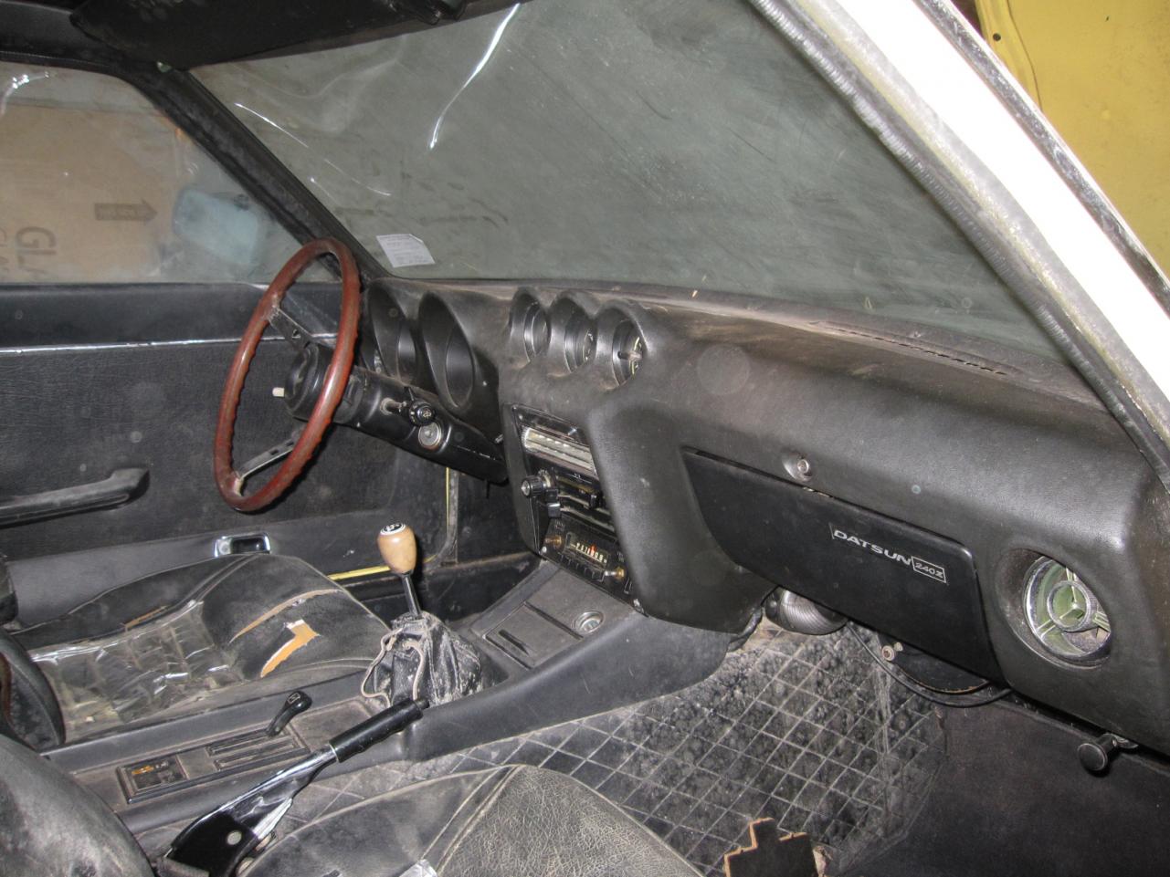

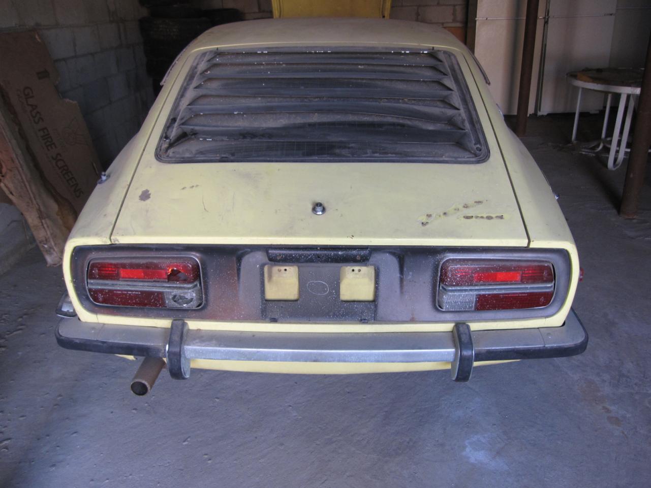

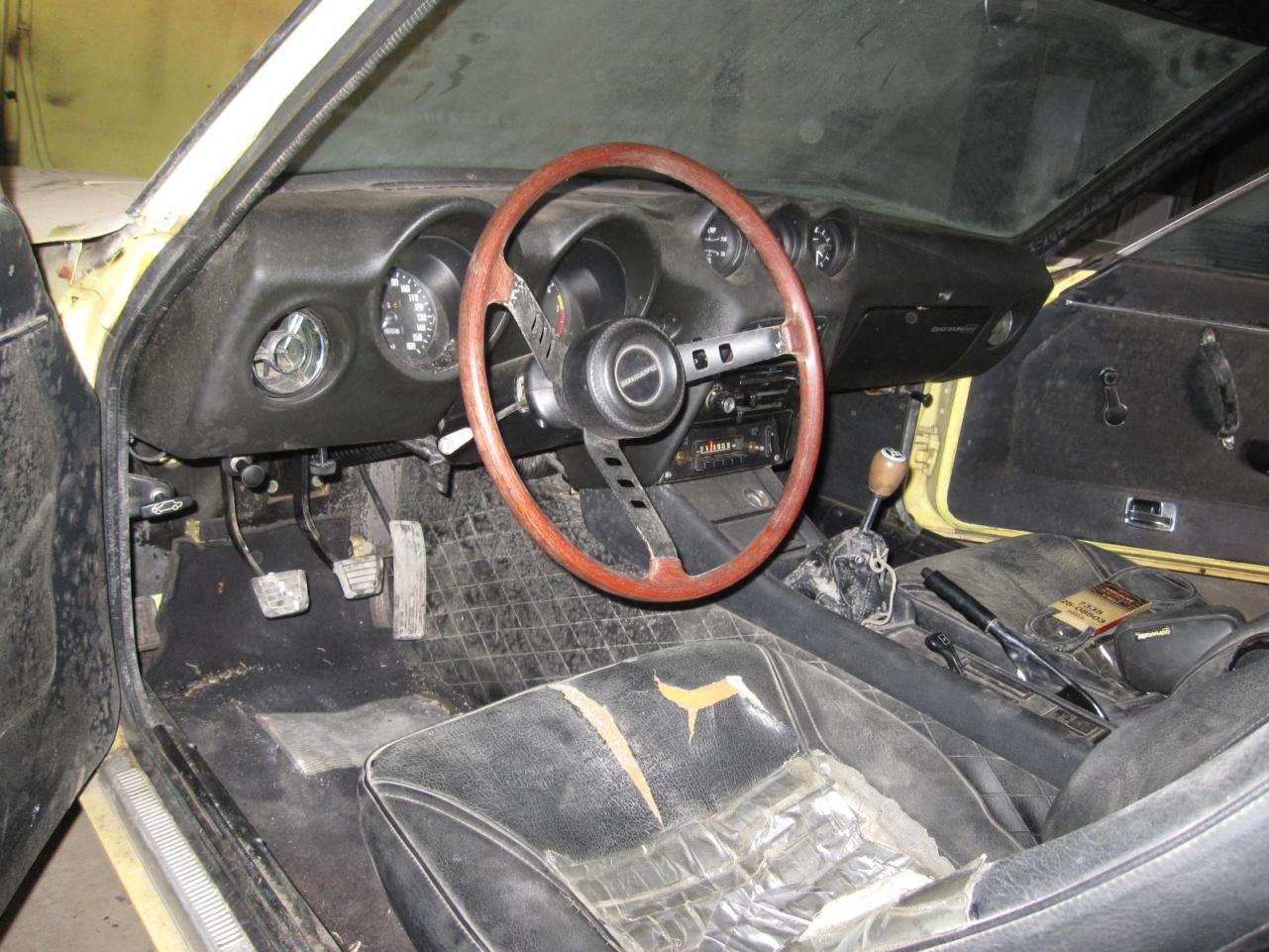

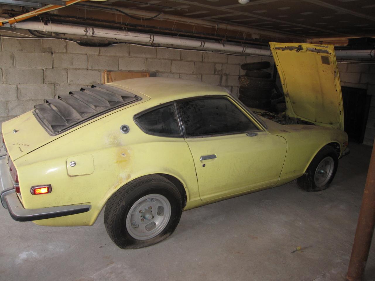

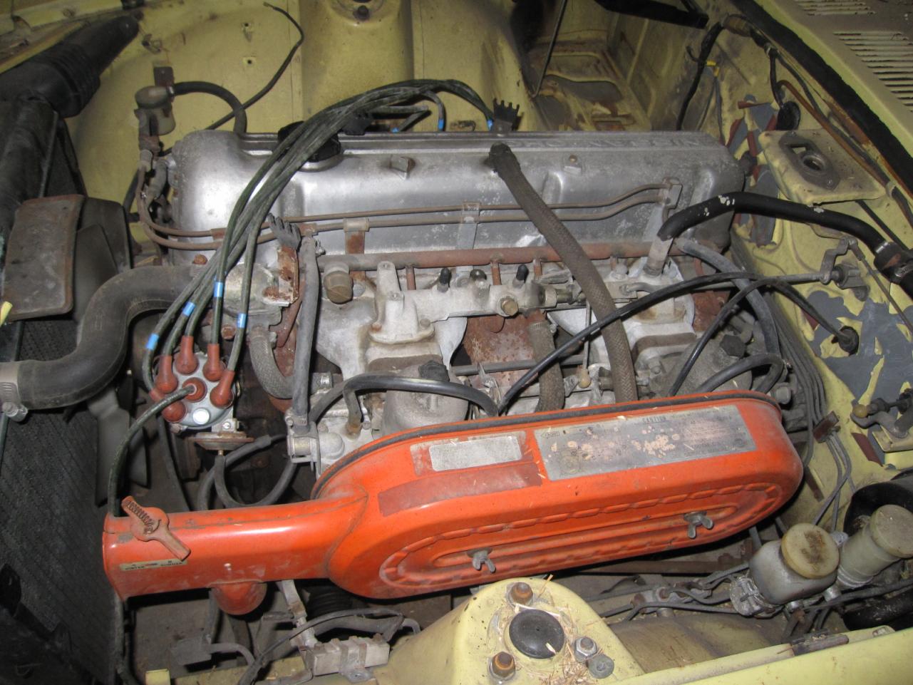

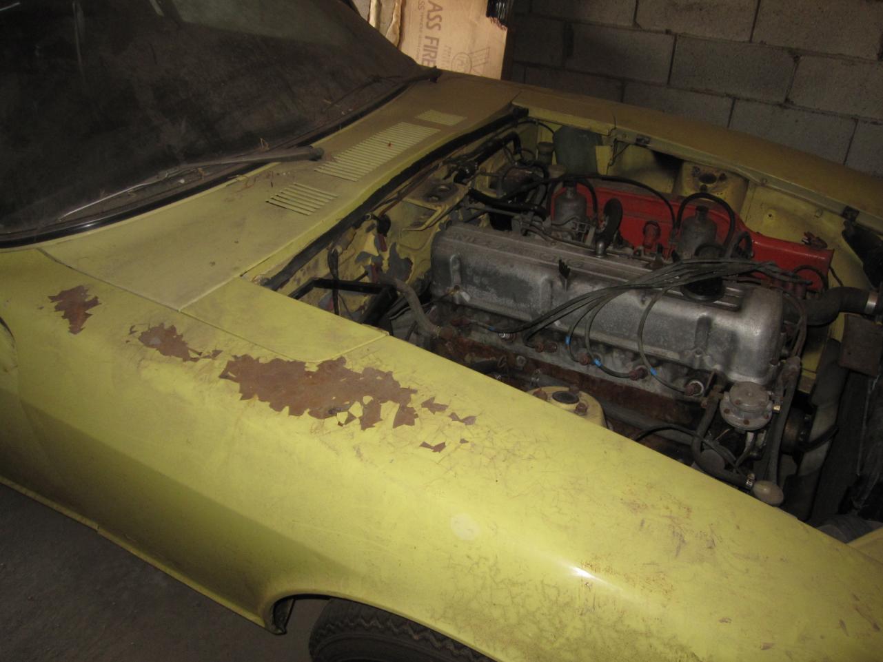

Just today I bought my first Z... it's a stock 71 240z. It's been sitting, untouched, in a heated garage since 1985! To tell you the truth I have not actually put eyes on it yet. I'm relying on pictures and a look-over by a good friend of mine. It is 99% rust free, the seats are trash but the rest of the interior is reportedly in good shape.
It is reportedly all original, unrestored. 90k on the clock. It has not been run since '85. No keys either. And it's missing the coil and coil wire (maybe more, I'll know on Saturday when I get it delivered).

Pretty brave of you to buy without seeing it first hand, these things can hide a lot of rust! Post some more pics when you can and let us know the build date and serial #.

And don't worry too much. Most of them have rust, and few are perfect.

Hi Mark:
Welcome to the group.
Looking at the pictures, I think you lucked out.
There is no battery in the car and no coil - so it didn't leak and eat the frame rail. Also no one at this point has tried to turn the engine over by cranking the starter. {I hope}.
Don't let anyone throw a battery in the car and start cranking. That has the potential to do far more damage than than just sitting idle for 25 years.
There is a good thread titled "Waking the sleeping beast". I suggest you read it. Before you do anything else.
http://www.classiczcars.com/forums/showthread.php?t=22619&highlight=Awakening
Go slow - and you may save yourself a lot of hassles and expense.
Then the next order of business is to clean it up - use mild soap and water - that will take 90% of the crud off. Take care not to be too harsh with the vinyl and door panels. They will most likely be dry and brittle. After you get the top layers of grime off - you can use a bit stronger solution of cleaners on tough spots.
If the dash isn't already cracked - you'll want to clean it, then rub it down with Vaseline Petroleum Jelly. Let that soak for a day, then remove the excess.
There is a good chance that the carpet will be dry rotted - but sometimes they are not. Carefully remove them and vacuum - to see what you have.
You will more than likely have to replace the tires, the rubber hoses for coolant, fuel and brake fluids. You might want to pull the radiator and have it boiled out and pressure checked, before you put fresh fluids in.
Expect the rear wheel cylinders to be shot - likewise the front calipers will most likely have to be at least removed and cleaned, the pistons hang up. You most likely will wind up replacing the brake master cylinder, along with the clutch master cylinder. Left siting for years they corrode and the seals go bad.

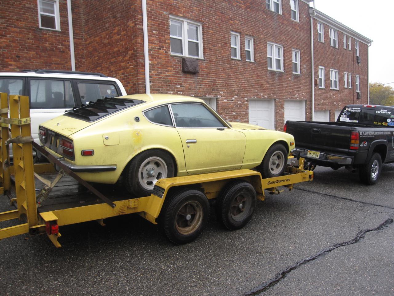

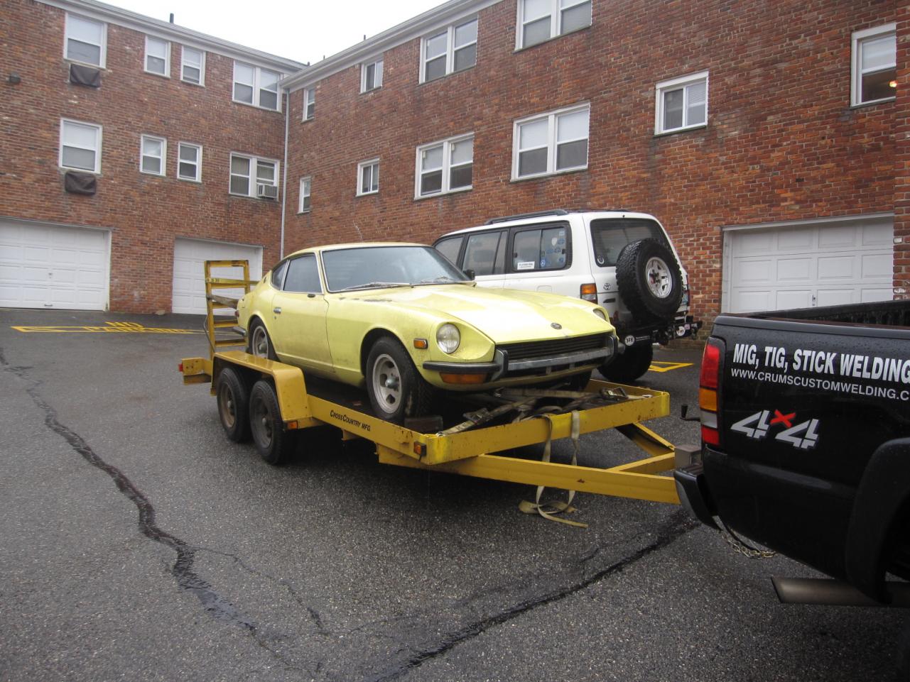

Not bad at all. Some interesting points - the spare tire appears to be the original Toyo Z-1. And I see a Michelin XAS on the left rear. Those were big dollar high performance tires 25-30 years ago. Somebody wasn't afraid to spend money on the best stuff.
I haven't checked for dry rot on the tires yet... they are all "new" from when it was parked in 1985. I'm sure I'll want to replace them before it goes on the road. It looks like the spark plugs are clean too... maybe they were also new then.
