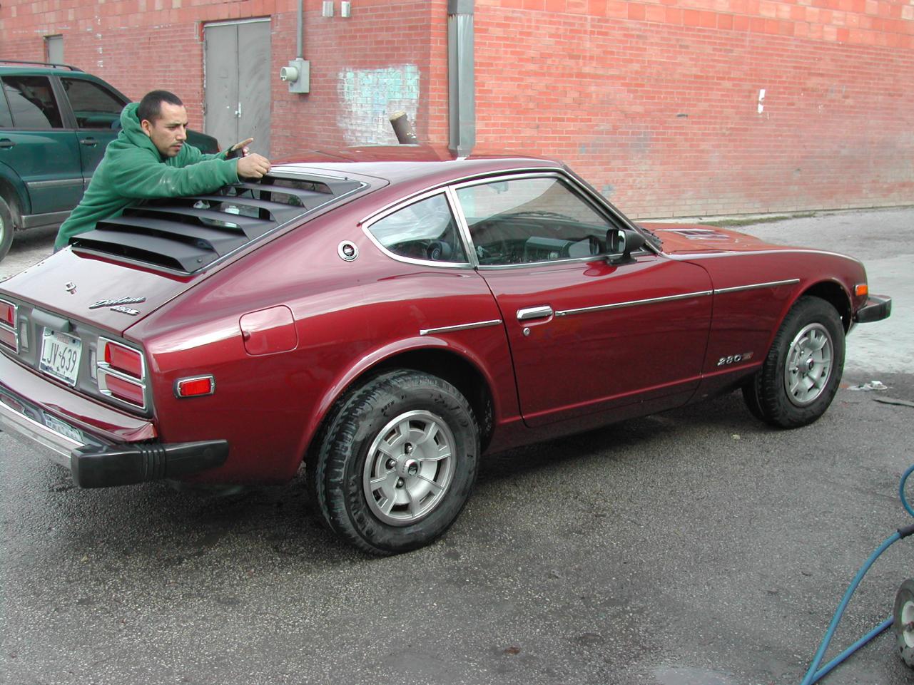

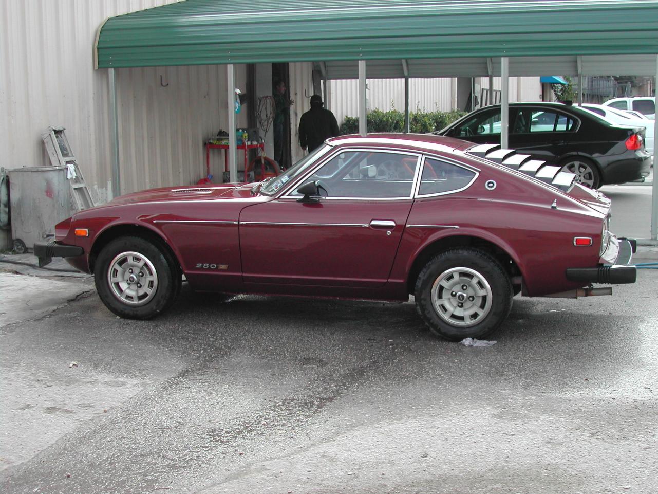

New paint ... Finally!!!
mlaw7

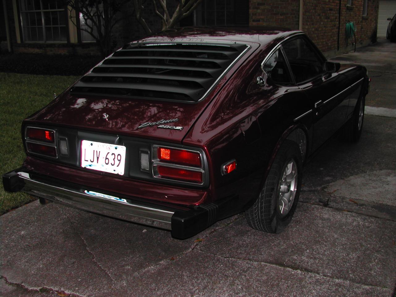

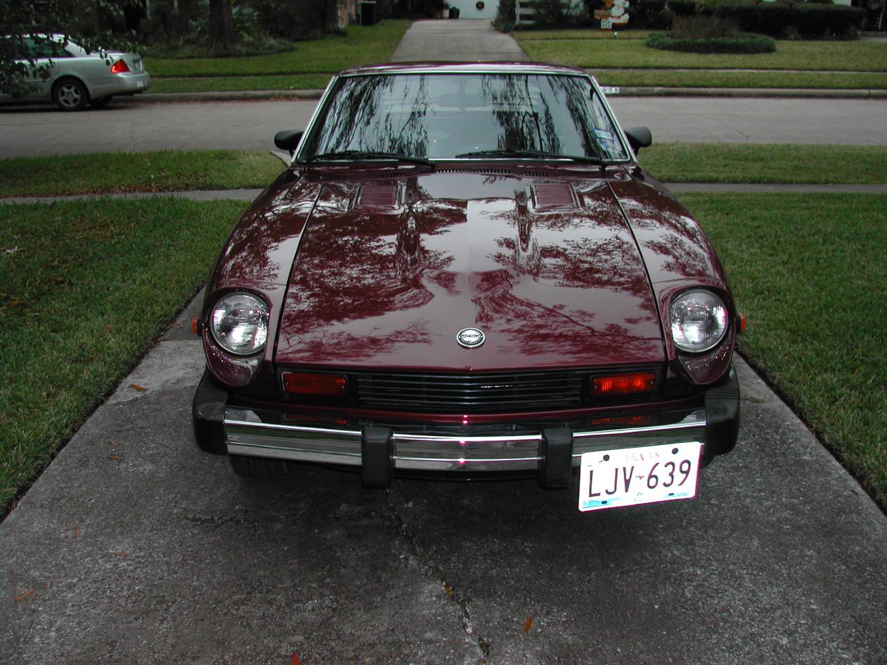

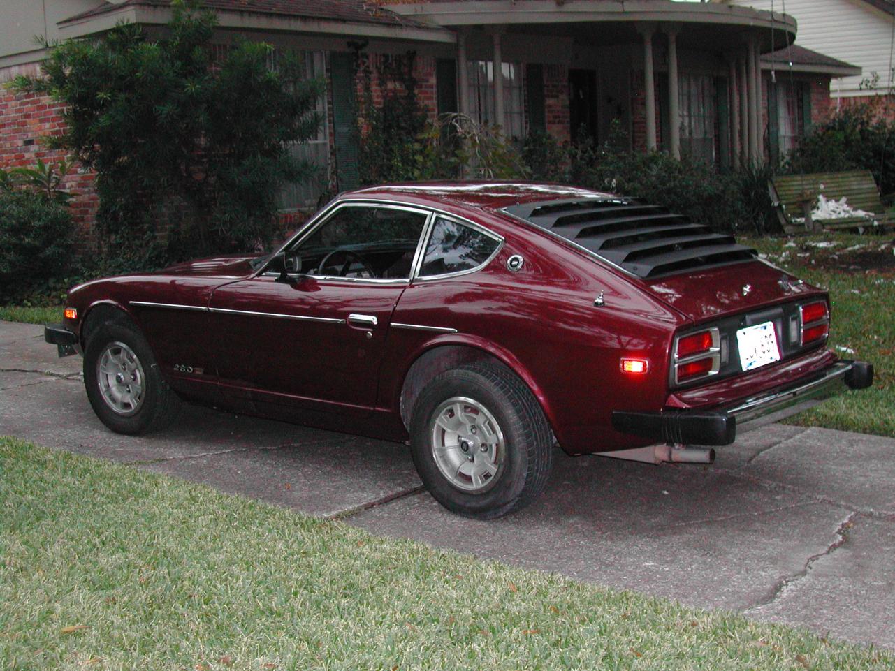

Wow that looks killer, I was wondering if you had the paint code for that color? Its not the original 611 burgundy color is it?
Thanks! Yes, it is the original Nissan 611 paint code. Four coats of base then three coats of clear.

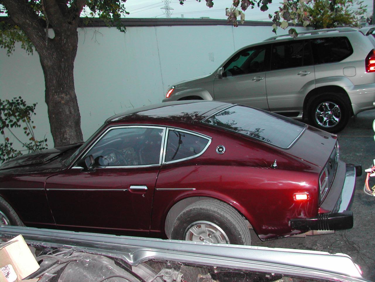

MLaw7 - You make me soooo jealous!! My Z is a couple of weeks away from where your car is now! I still want to take some pics of the two when I get mine back together. That Plum color is fantastic! You know these cars look better than original showroom with proper paint and modern materials! Great Job!! I noticed that your Bumpers look new. Did you re-chrome or polish? Very nice! I need to have mine done too.
Andrew
Rear bumper is re-chromed and the front is after about an hour or so of polishing. One area that often seems to be neglected is the back side of chrome bumpers, which can rust pretty badly. Mine had a pretty good bit of rust on the back sides. So I decided to POR-15 them, which took a couple of hours using the full 3-stage treatment and brushing on the POR-15.
The rear bumper was done by Superior Chrome here in Houston - very nice work.

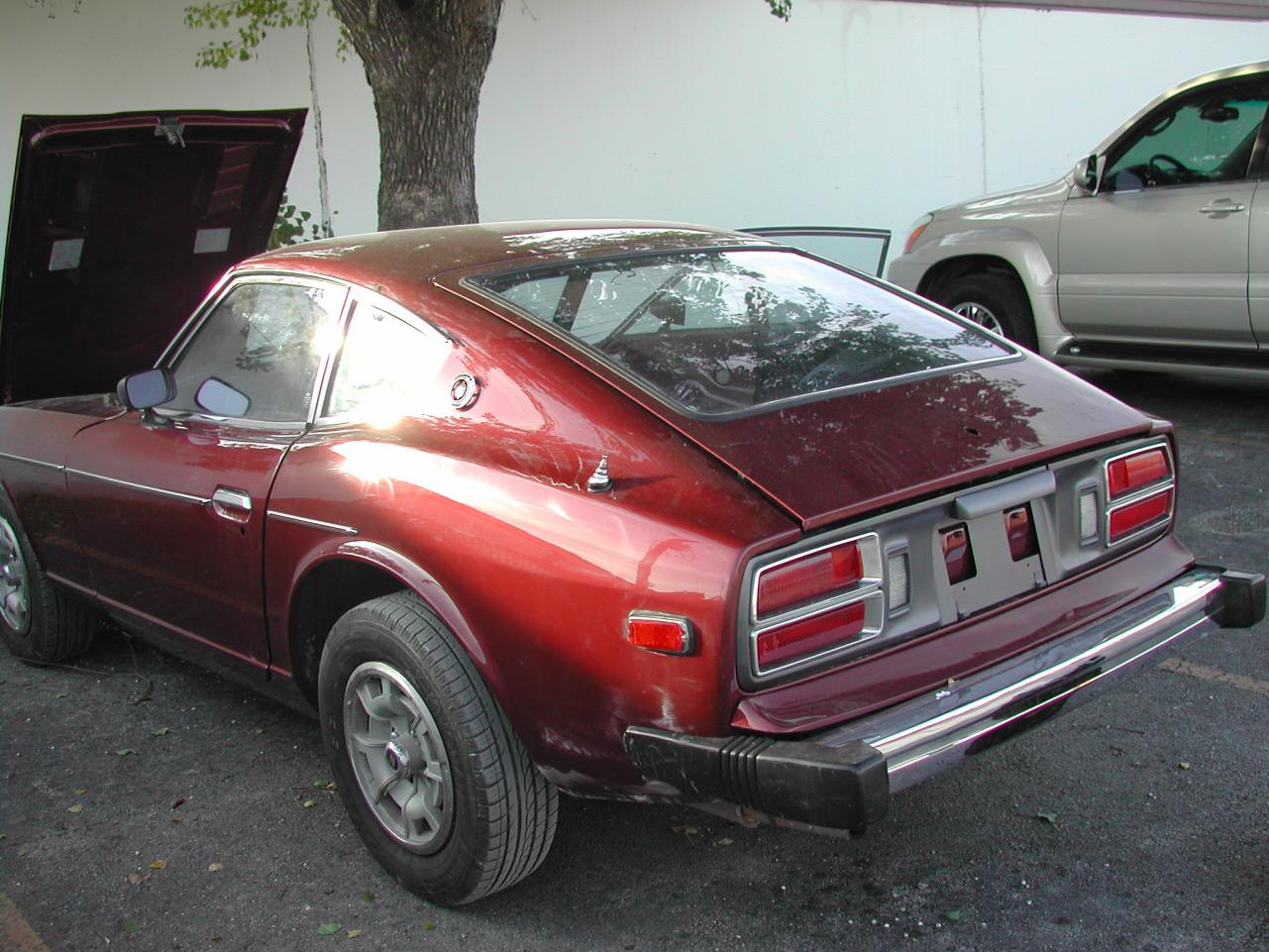

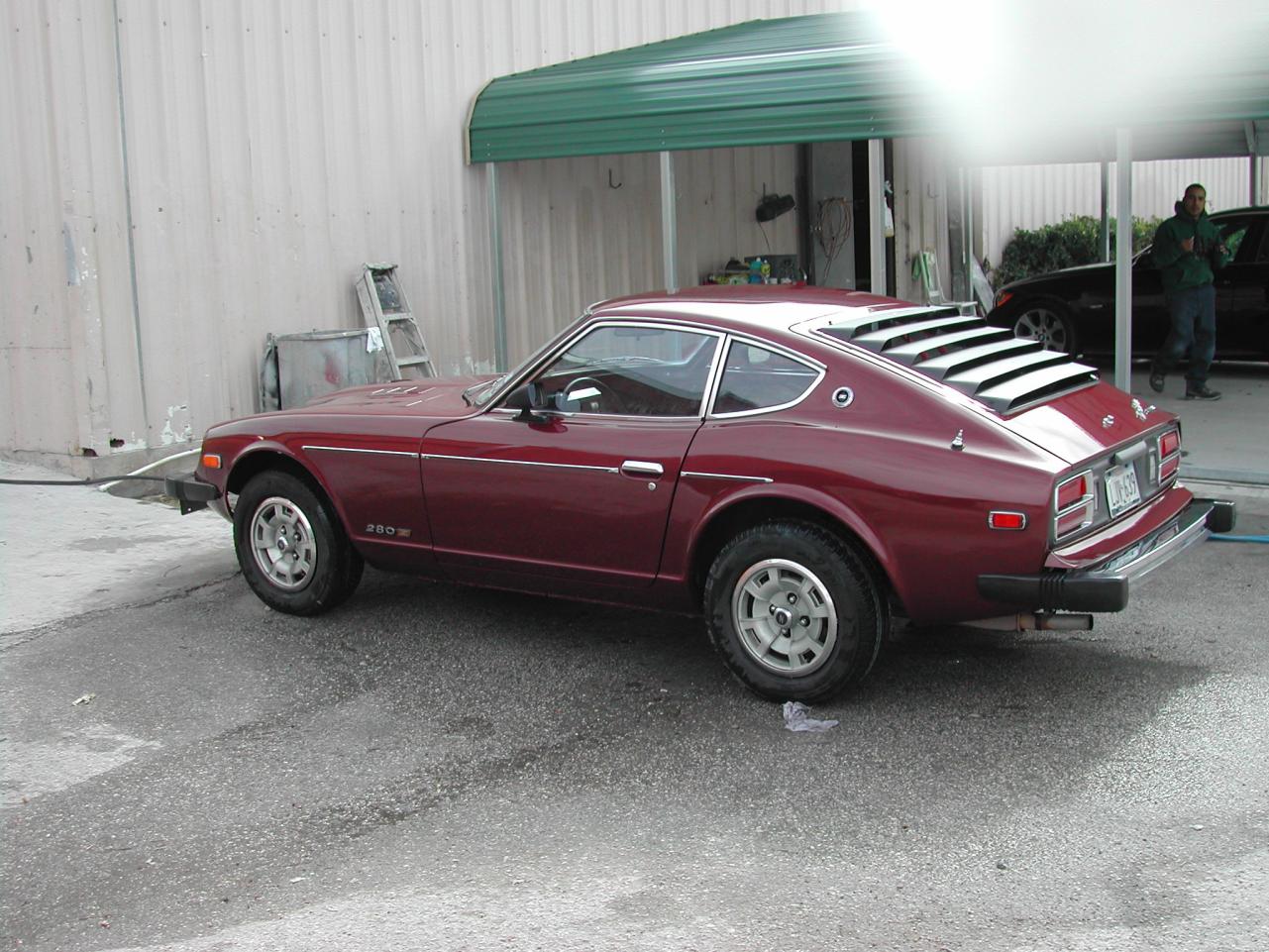

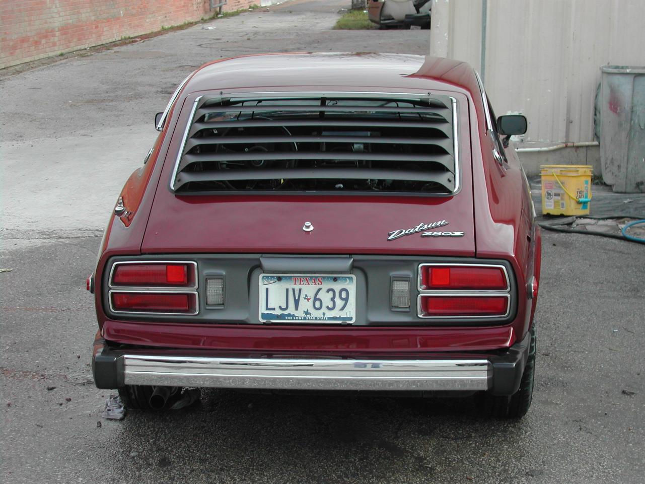

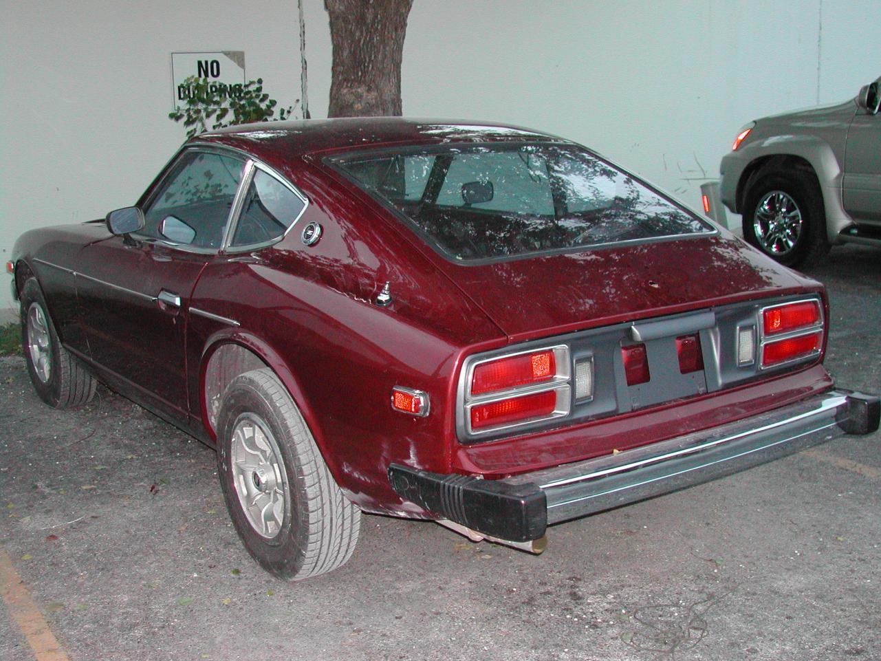

And here are a few more photos from this afternoon at the paint/body shop. I just got my door and hatch locks back from the locksmith. He cleaned and lubricated them as well as tightened the little arms in the back of the door locks. They had way too much free play, even for their "lazy" design.
This, I learned, is what causes the door locks in our S30's to stop working correctly when you try to lock or unlock them with the key. I imagine that many of us have experienced the frustration of not being able to lock or unlock our cars with the key.
If you can find a locksmith who's familiar with these old locks, it is probably a much less costly alternative to buying new door lock cylinders.
Mine were so bad that for a while I had to climb in through the hatch to open the door! :ermm: You can imagine the looks I got doing that downtown!

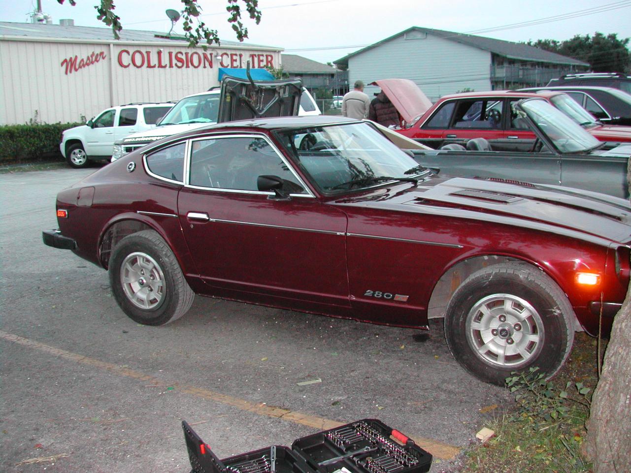

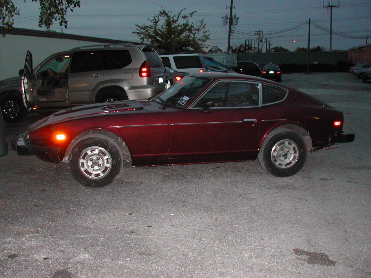

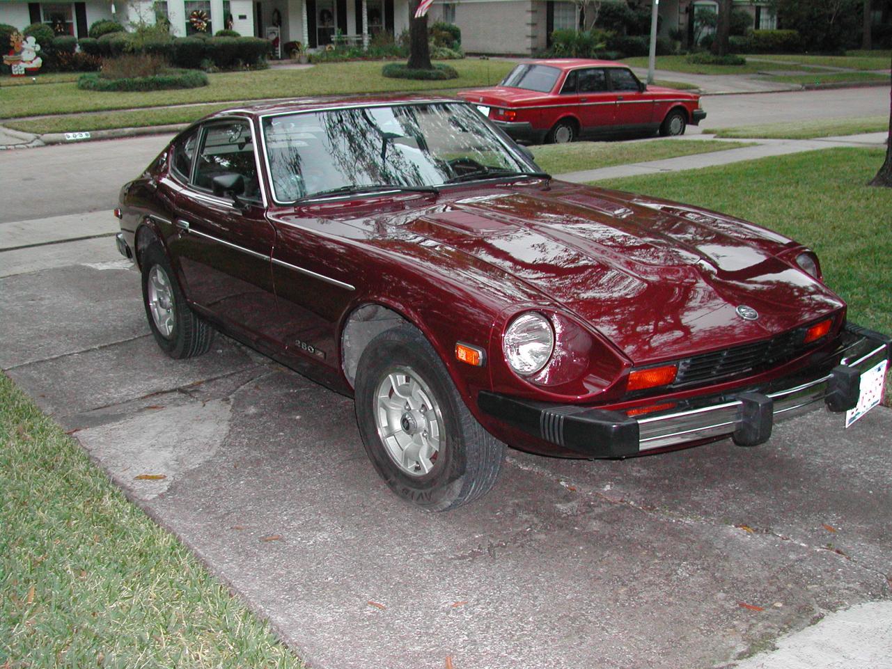

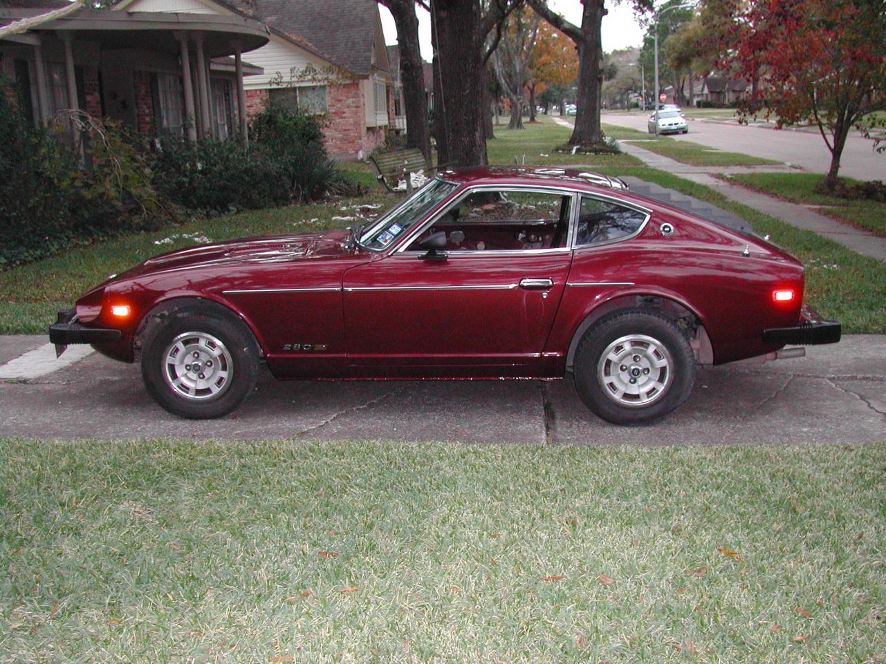

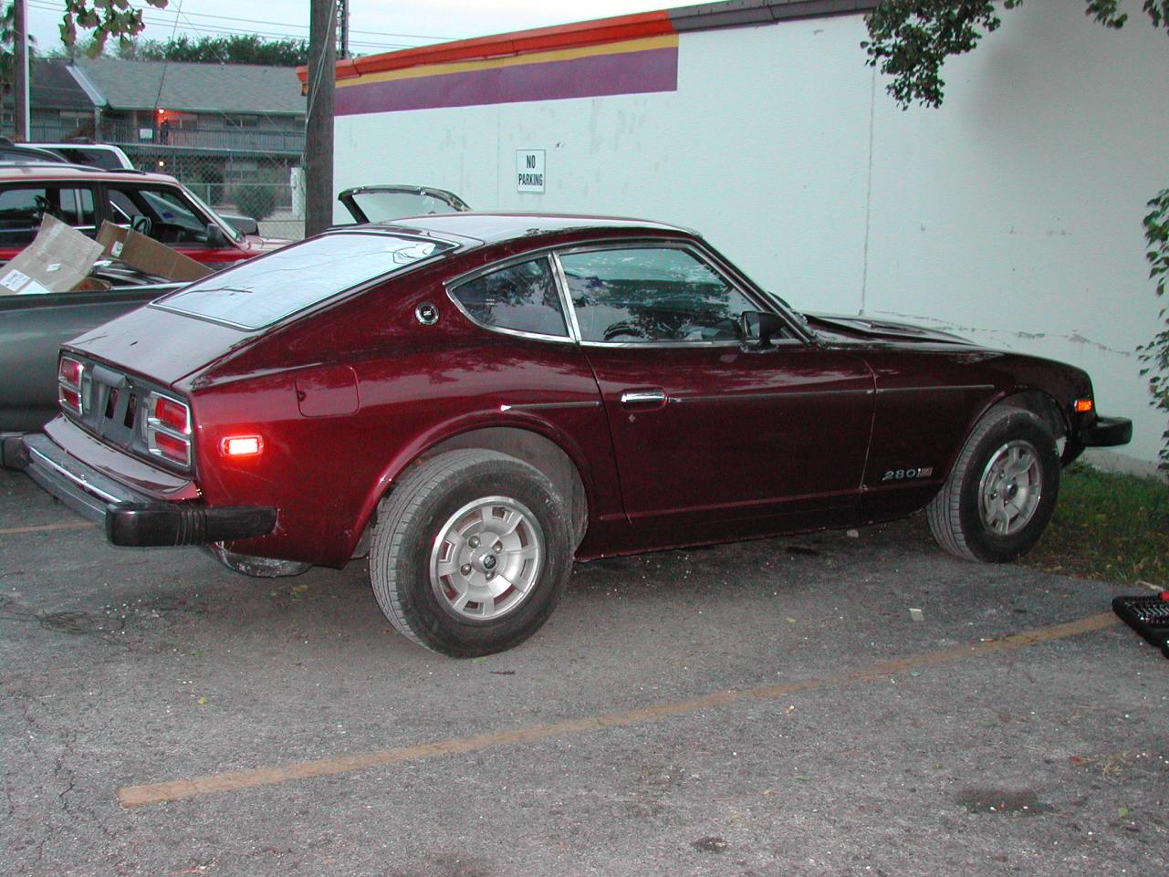

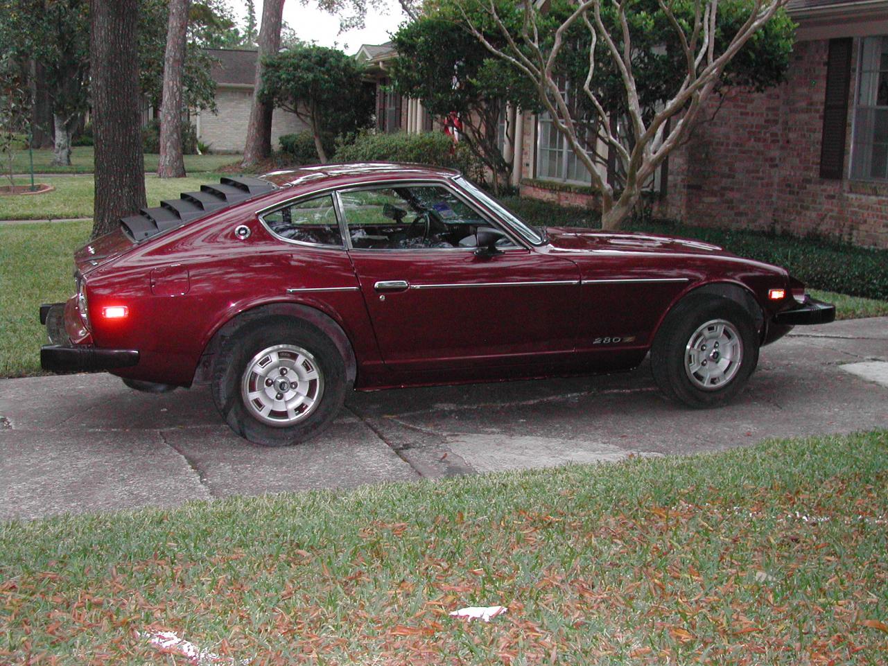

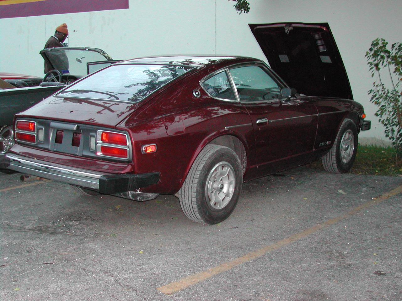

Just picked her up from the paint/body shop this afternoon and drove her home. No dash or interior. Just a driver's seat and seat belt. Enjoyed watching the speedo cable spin and hearing how happy she sounded to be running again as I drove!!
Here are a few more photos.
Now it's time for me to get to work on the POR-15 treatment for the floorboards, transmission tunnel and spare tire well.
Then QuietCar soundproofing on as many interior sheet metal surfaces as I can reach with a brush. Doors, floors, roof, rear quarter panels, hatch floor, inside the hatch lid, behind and around the speakers, etc.
Then reinstall the dash. I lubricated the speedo cable with white lithium grease and replaced all the bulbs with the brighter kit from MSA. Looking forward to seeing how much of a difference they'll make.
Then new carpet and headliner, followed by the rest of the interior. Whenever my budget permits, I also plan to have the seats recovered as a final touch.
May our Z cars rule the road for another 30+ years!!:cool:
