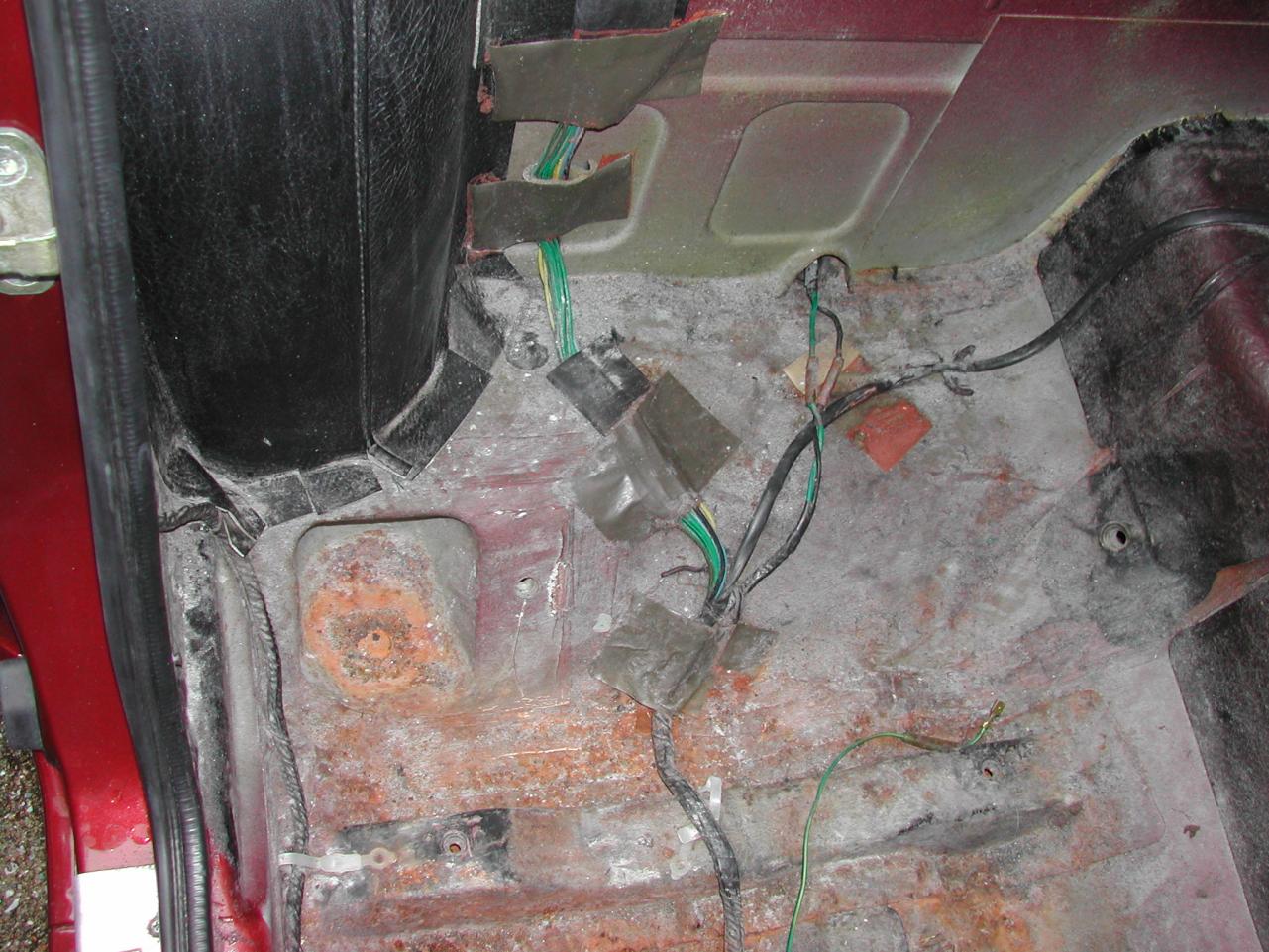

I forgot about two other rust areas. Neither of them were evident until I removed the door seal and floor insulation.
The front edge of the driver's side door jamb had a rusted out area about 5" long that was hiding behind the door seal. It started a little lower than the door jamb switch and ran down toward the rocker panel.

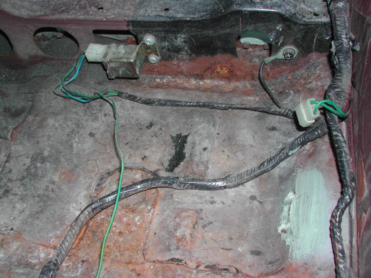

Also found two more small rust holes in the passenger side floorboard. One is about 1/2" and the other is about 1/8". Both were completely hidden underneath the tar paper and weren't visible from underneath the car. At least to my untrained eye.
Funny thing is the driver's side floorboard is virtually perfect! Go figure ...
Moral of the story (as so many of us here have already learned): Inspect your Z car THOROUGHLY for rust!
While I'm sure they do exist, a true rust-free Z in original condition is very rare. These cars are way too precious to let any more succumb to the rust monster. Especially when it can often be fixed and then prevented from ever coming back.

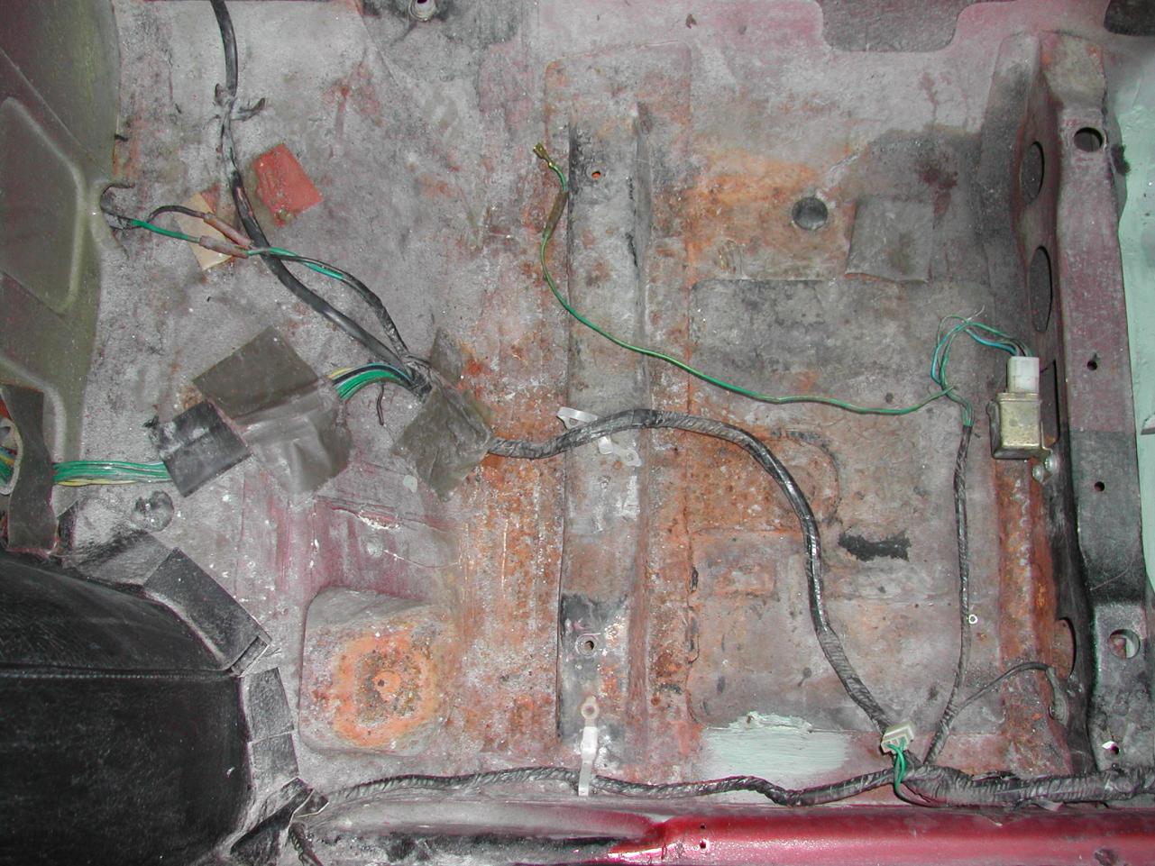

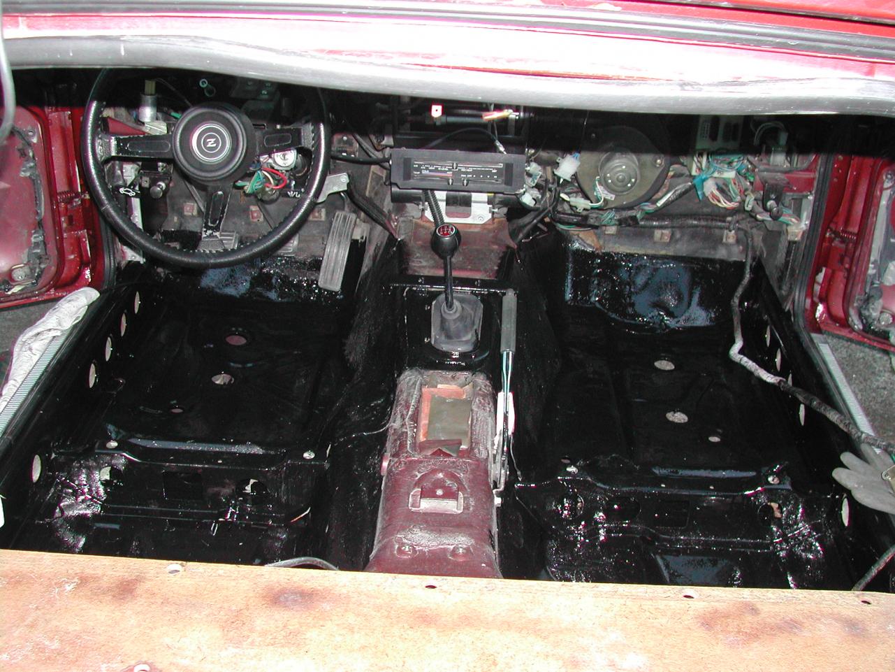

Since bringing my '78 home from the paint/body shop last month, things are moving along at a pretty good pace.
After all of the rust areas under the passenger side floorboard tar paper were discovered and fixed, the fun really began as I headed into the home stretch on this project.

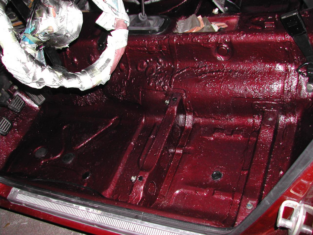

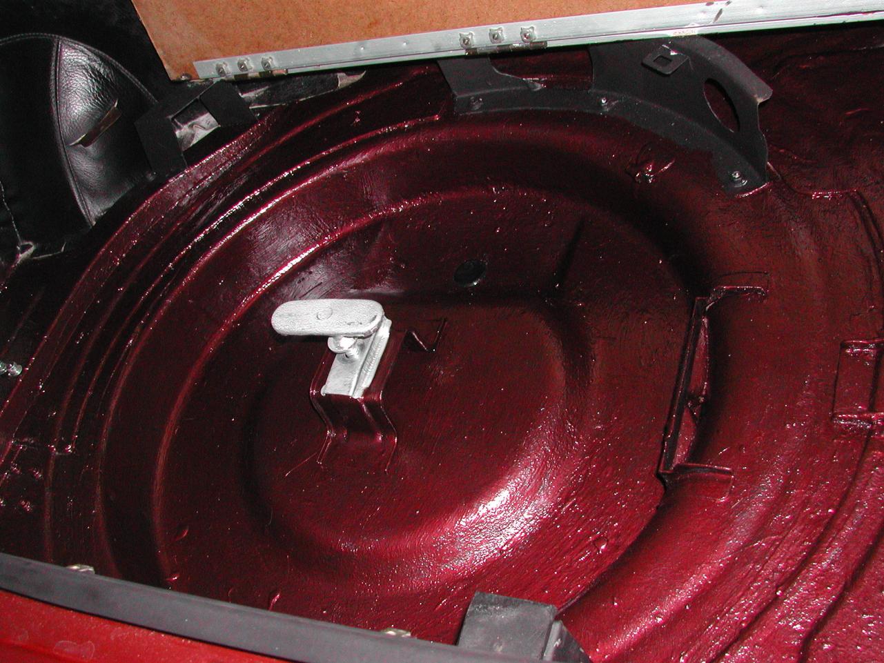

First, I used the POR-15 (semi-gloss black) three-stage process on the floorboards, firewall and transmission tunnel. As there were a few rust spots beginning in the spare tire well, I covered that area too. All together I applied two coats of POR-15, which was enough for a lifetime! That is some really strong stuff!
Once the POR had a few days to cure, I began applying QuietCar soundproofing to virtually every piece of interior sheet metal I could reach with a brush.
Floors, firewall, transmission tunnel, cowl area behind the dash, rocker panels, doors, around and behind the speakers, front and back of the hatch riser, the entire area under the rear deck, including the two compartments behind the seats, spare tire well, rear quarter panel behind the antenna, interior taillight panel and inside of the hatch behind the vinyl trim panel.
Since I want her to be as quiet as a Lexus (or almost anyway), I applied four coats. The difference is striking.
Before this, the sheet metal throughout the car resonated with all kinds of loud and unpleasant sounds and frequencies. Now they're almost entirely gone.
After re-installing the stock Hitachi 4" speakers, I decided to connect the OEM Hitachi AM/FM unit to hear how the system sounds. Even my speakers sound louder and more focused. Needless to say, the car is much quieter on the couple of short drives I've taken her on. And this was without the rubber floor plugs, insulation, carpet or door panels.
It's kind of like going from a concert in an old concrete auditorium with sound bouncing around everywhere to a finely tuned vocal or drum booth in a recording studio.

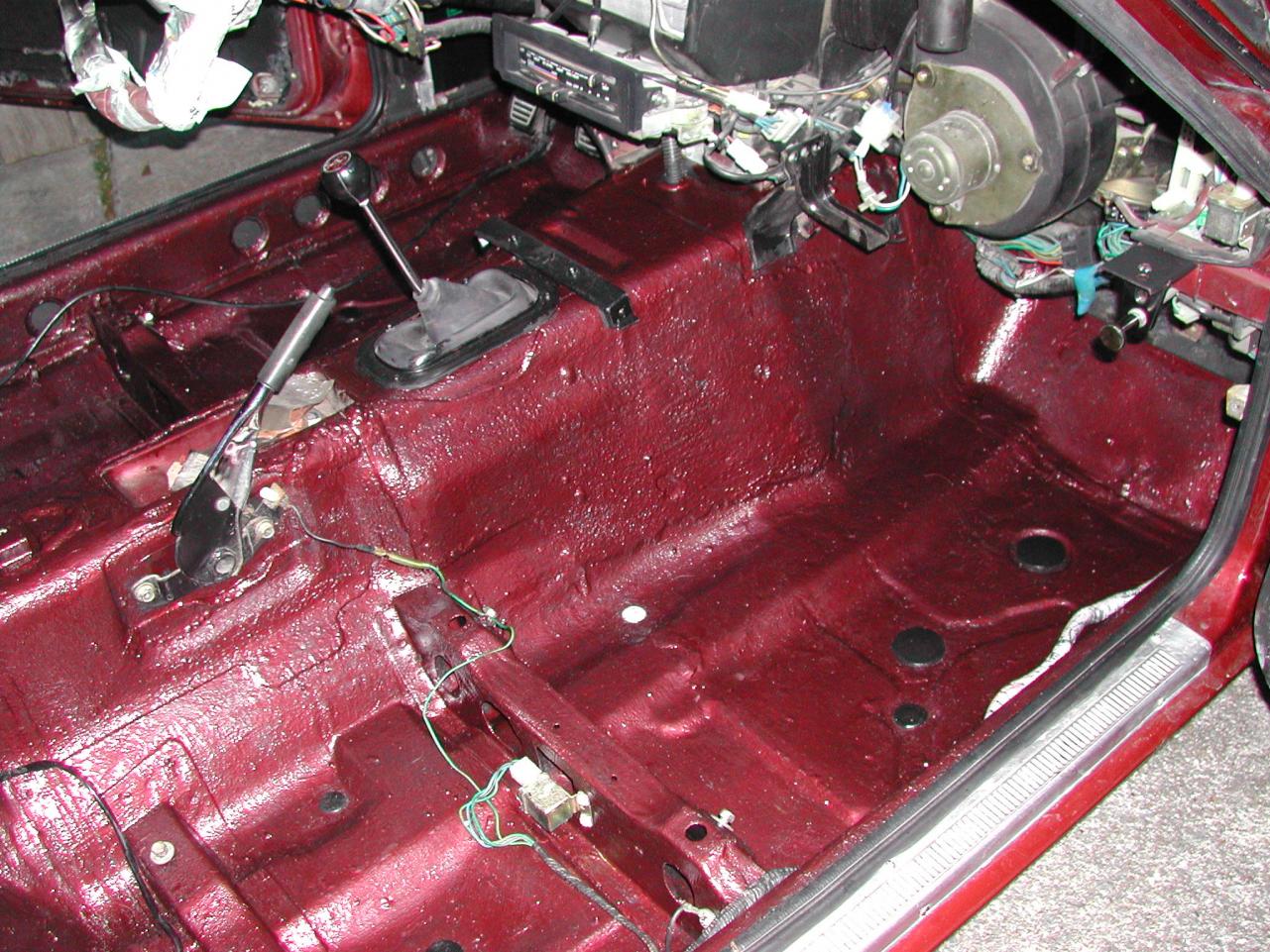

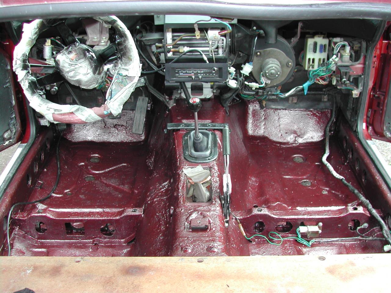

At first I was going to leave it at that, since the QuietCar dries to a nice flat gray-black finish a little darker than the plastic taillight/license plate trim. After all, most of it will be covered by carpet or door panels other than the seat rails and under the deck riser.
IMO, a nice tradeoff for a quiet ride.
Then the other day I stopped at an auto paint store to pick up some SEM vinyl paint for my channel molding inserts. Truth was, I still missed seeing the burgundy paint in the rear deck area. So on a lark, I asked how much a pint of Nissan 611 paint would be with reducer and hardener.
$50.00 later I went home and got to work. Since I don't have an air compressor and the QuietCar finish shows some brush marks anyway, I decided to brush it on.
It's funny. She really seems happier to have her floors and deck painted burgundy as they were from the factory. And if she's happy, I'm happy ... :)
Here are some photos of the floors before rust repairs, after applying the POR-15, and after painting the interior sections. No QuietCar photos as that was the last thing I felt like doing after treating the entire interior four times in one week.
Will be replacing the heater control vacuum valve/hoses before re-installing the dash next week. I'm also working my way through a list of little things to address before putting the interior back together and hitting the road again.
