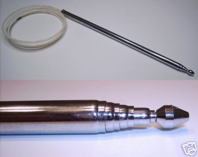

You have to take the antenna unit out of the car, and pretty much disassemble the spool case to get the mast off. If the mast isn't bent up but doesn't go up or down, the likely cause is that the nylon/plastic/whatever spool cord-thing inside has become brittle and broken. I've been told that it is possible to replace the spool-cord with really heave weed-whacker string, but have no experience doing that. My original broke about 8" from the end, so I just shortened it. My antenna now works, but is about 8" shorter when fully extended. Of course, I then changed the radio and replaced it with a full auto unit instead.
Replacement masts used to be available from Nissan, but have been NLA for a few years now. If you find a source for the original 240Z masts, please share.

I wanted the original antenna in my 72 240z. It stopped moving up and down. When I took it apart the plastic inner shaft was broken. There was a replacement available years ago but I could not locate one. However, I was able to find another antenna that did not work for $20. The mast was OK so I put the two antennas together and ended up with a perfectly operational original antenna. The early antennas (240z) and the later (260/280z) antennas are different and the shaft is not interchangable. The later antenna is taller and larger overall. It is an improved design I believe, but it is a tight fit into the fender and it is heavier looking.
