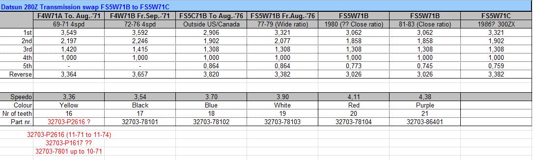

Diff Ratio:
The 240Z had a 3.364:1 and the 280Z had the 3.54:1 R200. If you are still using the original diff you will need a yellow pinion drive for the speedo. If its black you have the one for the 280Z with the 3.54 ratio.
This is not causing your bounce problem. It will mean the speedo won't give the correct speed.

Diff Ratio:

Back to the pinion.
The pinion in mounted in the transmission, but it is not related to which transmission you are using. It depends on your diff. The transmission came out of a 280Z which uses a diff ratio of 3.54:1.
If you haven't changed the diff it should still be a 3.364:1. The yellow pinion gear would be the correct pinion for that situation. It won't cure you bouncing speedo, but it will give you a more realistic speed.
