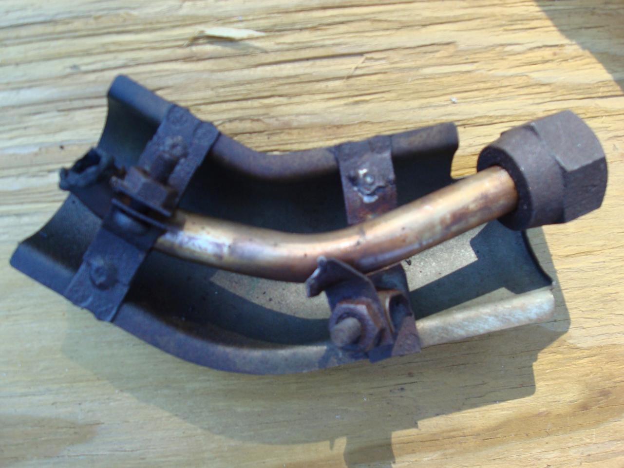

November 14, 200915 yr Author comment_300309 Hi, i have been removing my heat shielding and spraying all my studs and looks like the manifold has been removed before because all the intake fasteners have been replaced with bolts. As i mentioned before the egr pipe had been welded so it broke as soon as i loosened the nut at the intake. Does anyone have one or know where i can get one ? I have searched all the zcar parts stores listed in another thread and they do not have one :disappoin Link to comment https://www.classiczcars.com/forums/topic/33779-exhaust-manifold-leak/?&page=2#findComment-300309 Share on other sites More sharing options...
November 15, 200915 yr Author comment_300393 Found all the parts i need at the z store, just very expensive. What would be my downfall just plugging the tube off ? My guess this is what everyone has to do if they install a header. Every thing else came off ok, no broken studs :classic: Link to comment https://www.classiczcars.com/forums/topic/33779-exhaust-manifold-leak/?&page=2#findComment-300393 Share on other sites More sharing options...
November 16, 200915 yr comment_300456 It depends on your emissions requirements. In California, removing/plugging the EGR would fail visual but that may not matter where you are. The tube looks like something that can be made with the right tools. You may even be able to fix that again if you clean the weld and sleeve it/re-weld the break. A simple butt weld would probably crack again (like it did when you removed the tube). The bolts are original on the intake side. I went with the MSA studs because I wanted new exhaust studs and I read it made installing the intake much easier Link to comment https://www.classiczcars.com/forums/topic/33779-exhaust-manifold-leak/?&page=2#findComment-300456 Share on other sites More sharing options...
