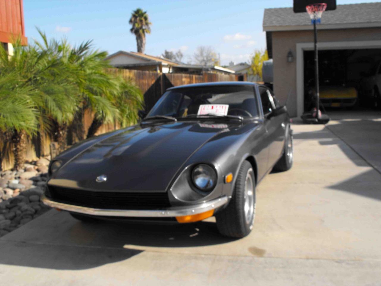

I checked out the Z on Craigslist and took some photo's.

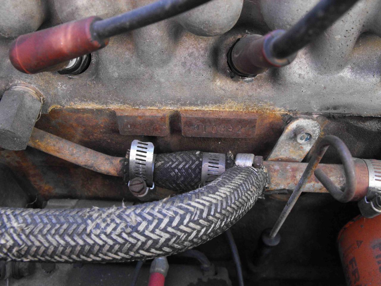

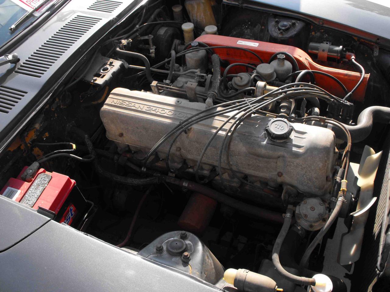

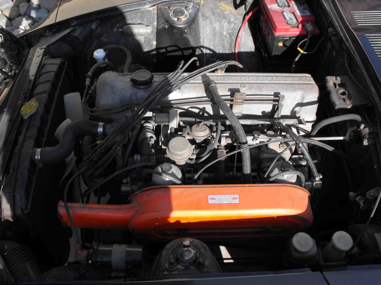

The car is a 7/70 build, S/N#HLS30-06947(Not sure on the last two digits, might be dislexic and forgot to take pics of door jam tag :-|). The Engine tag was missing, but most likely it is the original engine. Engine S/N is roughly 3K higher than the Car S/N which is correct for the early 70 vehicles. Engine is very original with a number of 40 year old hoses still on the car. Smog equip looks to be operational. Radiator and fan look like they have been replaced. The engine also has the original E31 head. Nice valve cover!

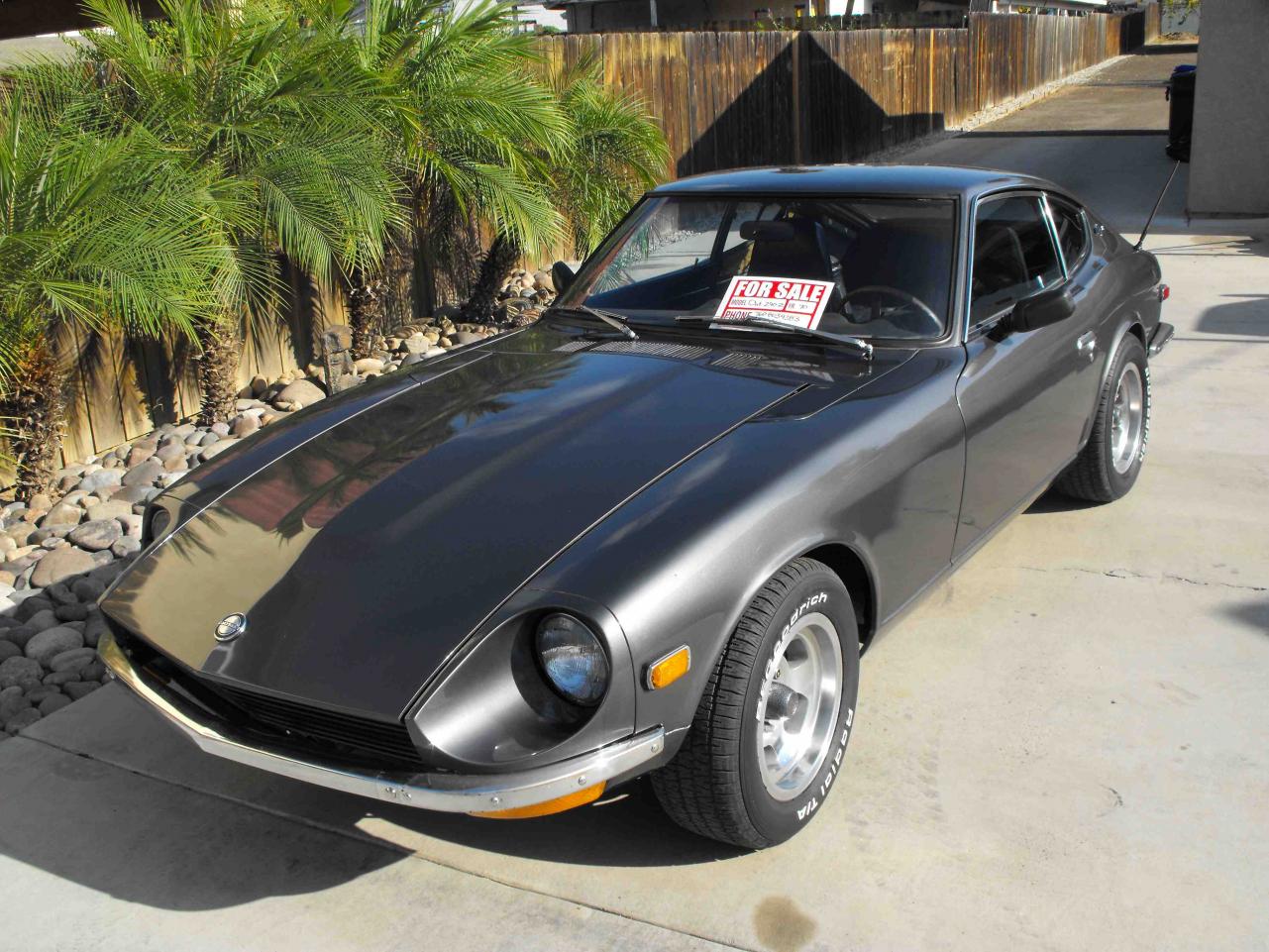

Car was originally 920 Safari gold. Looks like it was painted red, then again with the current titanium metallic paint. (Visions of Antiques Roadshow Faux pas dancing thru my head). Paint job was done well though with no noticable runs or overspray. Bumpers were descent, but missing some parts.
Owner installed new seals all around. Tires and rims are also very nice.

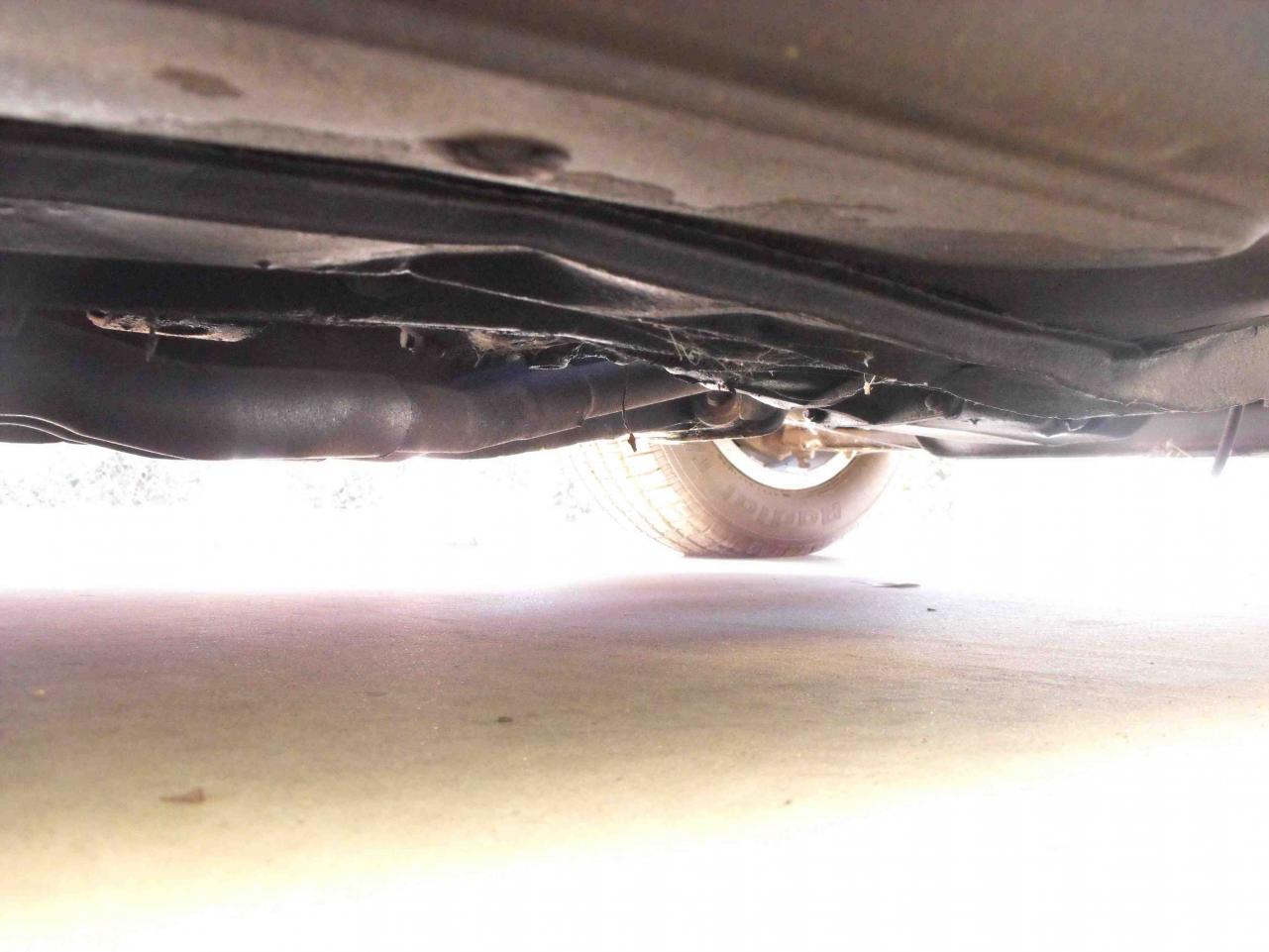

Drivers side frame rail is not too bad, but the passenger side rail is pretty beat up with a major rust hole in the back end, about the size of a silver dollar.
