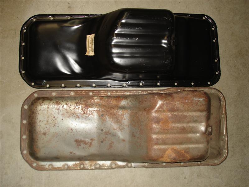

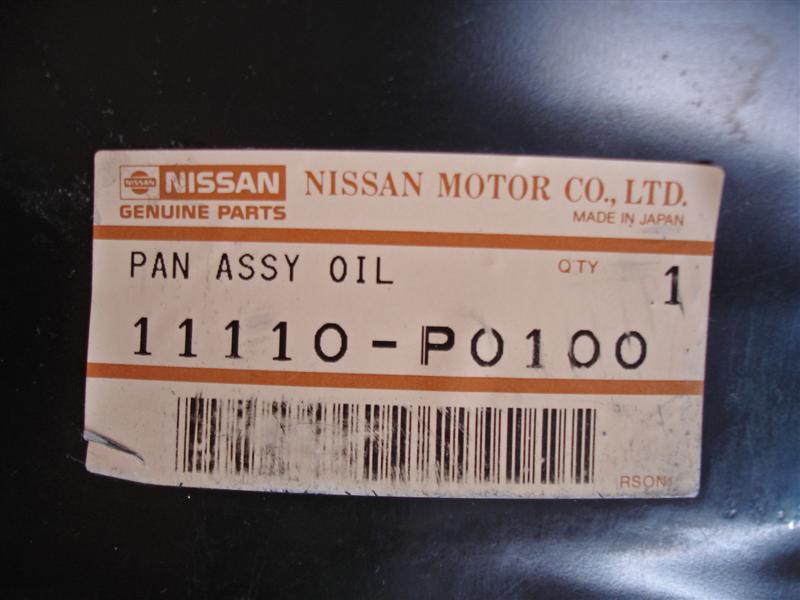

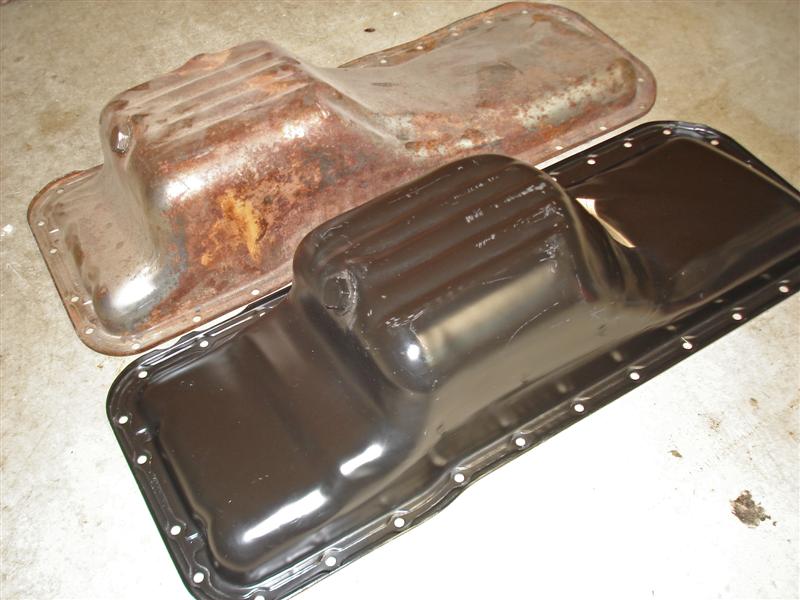

Posted November 13, 200915 yr comment_300218 I have unearthed a new L6 oil pan I had stashed in the attic. Now I don't know what model it fit. Can anyone help ID this pan? The rusty one is off a 1979 L28, I think. The new black one has the Nissan sticker as pictured with part # 11110-P01000. You will note they have the sump in different areas. Thanks for any help in refreshing my mind. I have this medical problem, CRS. You know, "can't remember S__t" Phred Link to comment https://www.classiczcars.com/forums/topic/33814-oil-pan-id/ Share on other sites More sharing options...
November 13, 200915 yr comment_300224 If i'm not mistaken then the rusty one is a ZX pan, what is important is the ZX pan requires a longe oil pick up.Chris Link to comment https://www.classiczcars.com/forums/topic/33814-oil-pan-id/#findComment-300224 Share on other sites More sharing options...
November 13, 200915 yr comment_300225 I have unearthed a new L6 oil pan I had stashed in the attic. Now I don't know what model it fit. Can anyone help ID this pan? The rusty one is off a 1979 L28, I think. The new black one has the Nissan sticker as pictured with part # 11110-P01000. You will note they have the sump in different areas. Thanks for any help in refreshing my mind. I have this medical problem, CRS. You know, "can't remember S__t"PhredYou'd better see a doctor before that CRS develops into CRAFT. Original application based on the part number (P01) was the 230 Cedric/Gloria, but since you didn't get that model in the US it must have also been used on a different model. Link to comment https://www.classiczcars.com/forums/topic/33814-oil-pan-id/#findComment-300225 Share on other sites More sharing options...

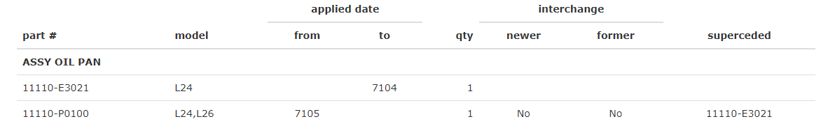

November 14, 200915 yr comment_300270 According to my parts catalog (Model S30 June 1974) the part number is for the L24/L26 starting 5/71. Link to comment https://www.classiczcars.com/forums/topic/33814-oil-pan-id/#findComment-300270 Share on other sites More sharing options...
November 14, 200915 yr Author comment_300277 Thanks for the helpful replies guys. I need a 240 pan to send off to be modified for an external pick-up race pan. But it seems new 240 pans are rare, so I guess I'll pull one off a stock 240 engine I have, (hiding under a tarp out back) that I will be restoring next year. So it looks like the resto will get the new pan. Cheers!Phred Link to comment https://www.classiczcars.com/forums/topic/33814-oil-pan-id/#findComment-300277 Share on other sites More sharing options...
