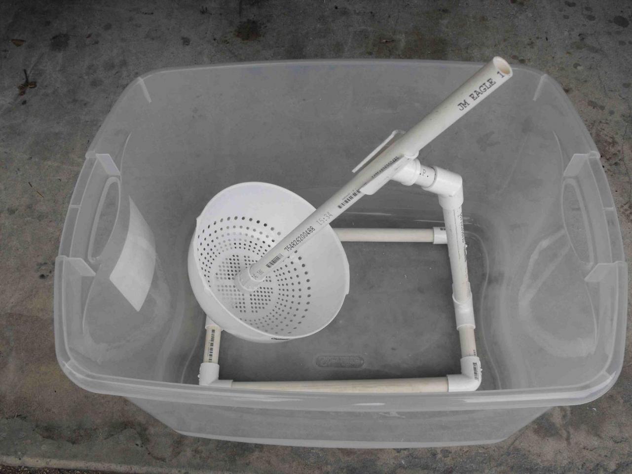

I cleaned up the garage a bit and set aside an area for the plating buckets. I also made a rotating 'bucket' for plating quantities of nuts and bolts. I hope to try my hand at plating as soon as the chemicals come in. Perhaps by the end of next week. I will post pics of the progress.

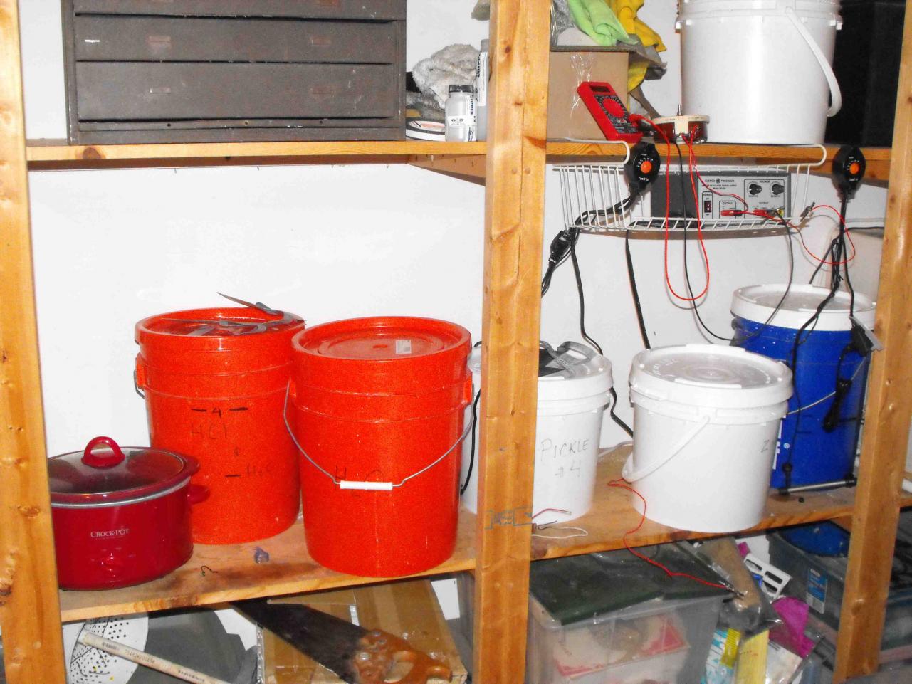

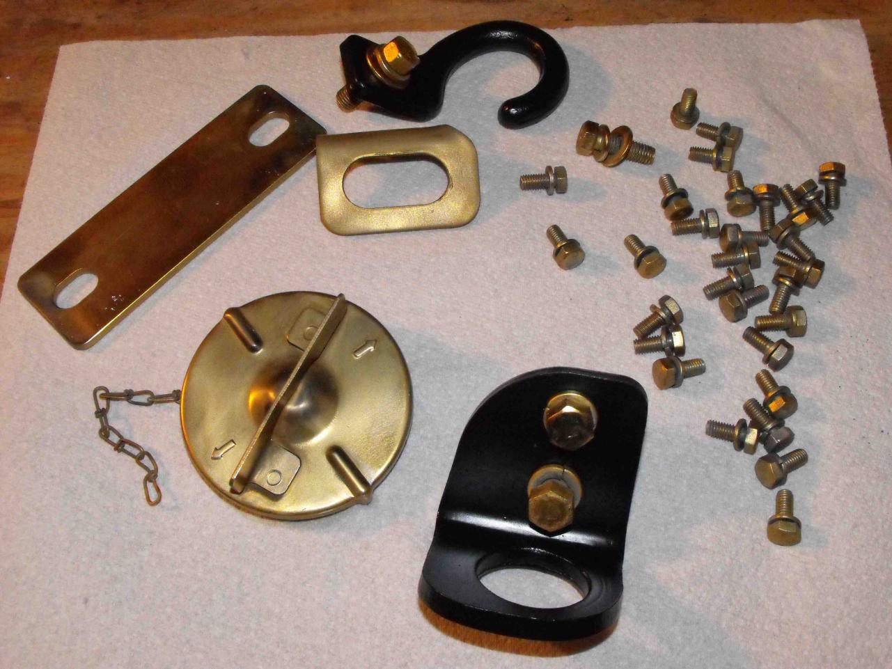

I got my Caswell plating kit set-up and plated some parts today. It took a bit of practice, but I am very happy with the results. The difficult part was getting the right current to produce the bright color.

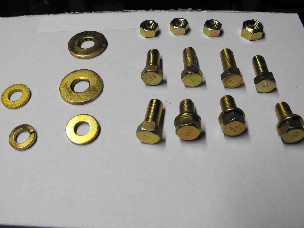

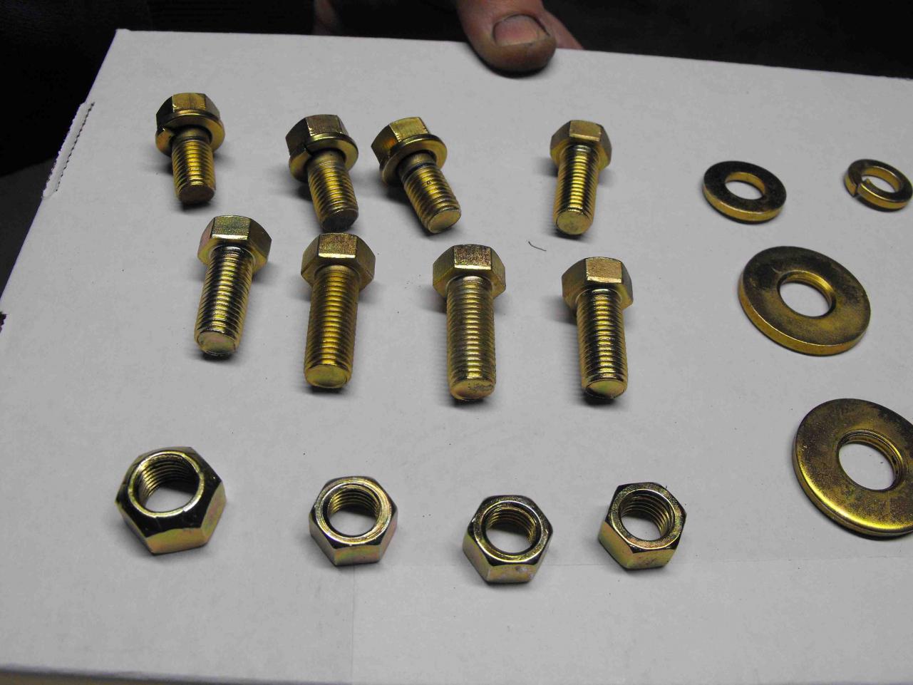

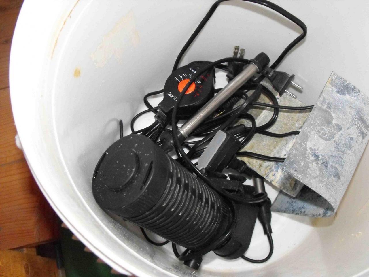

I originally tried doing the plating the cheap way by just getting the chemicals (NaOH and ZnO) off of e-bay, but the plating came out dull. So, I had to pop for the Caswell kit in order to get the parts to have the correct shine. Below are 2 pics of the dull finish and 2 of the Caswell kit finish. Also have my plating shelf shown here.

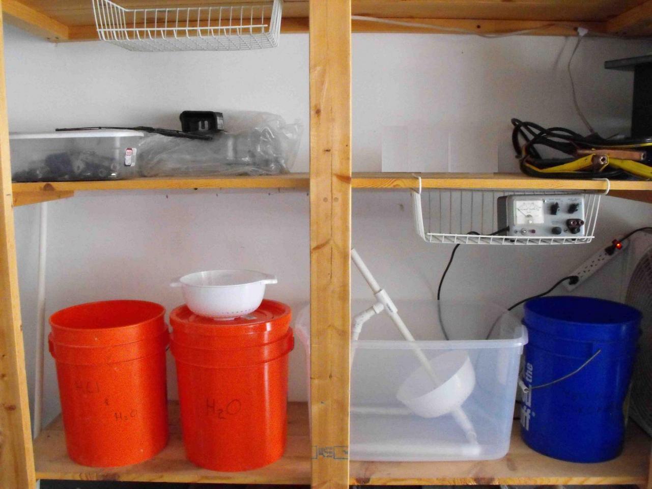

I bought the 3-gallon kit ($205) and the yellow chromate liquid ($30). Add shipping and it's a little over $250. Also got a crock pot (for heating the solvent) from target and Muriatic acid and a couple of buckets from Home Depot. So the whole package is roughly $300.
They tell you how to dispose of it in the enclosed Caswell plating manual. Essentually you neutralize it with a base..baking soda, then dispose.

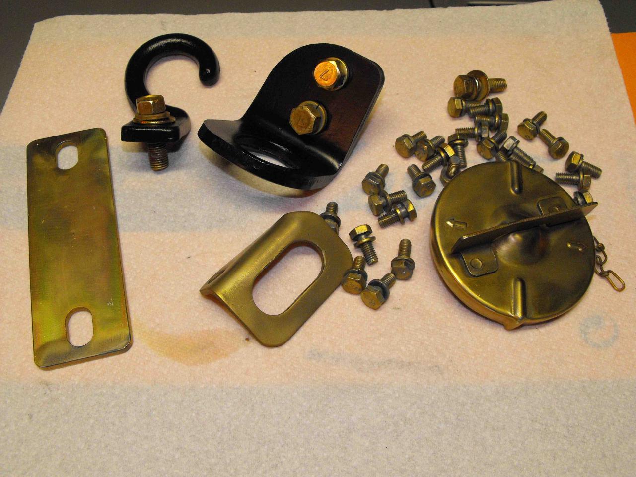

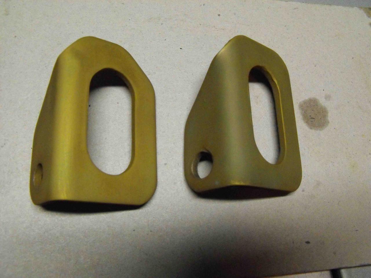

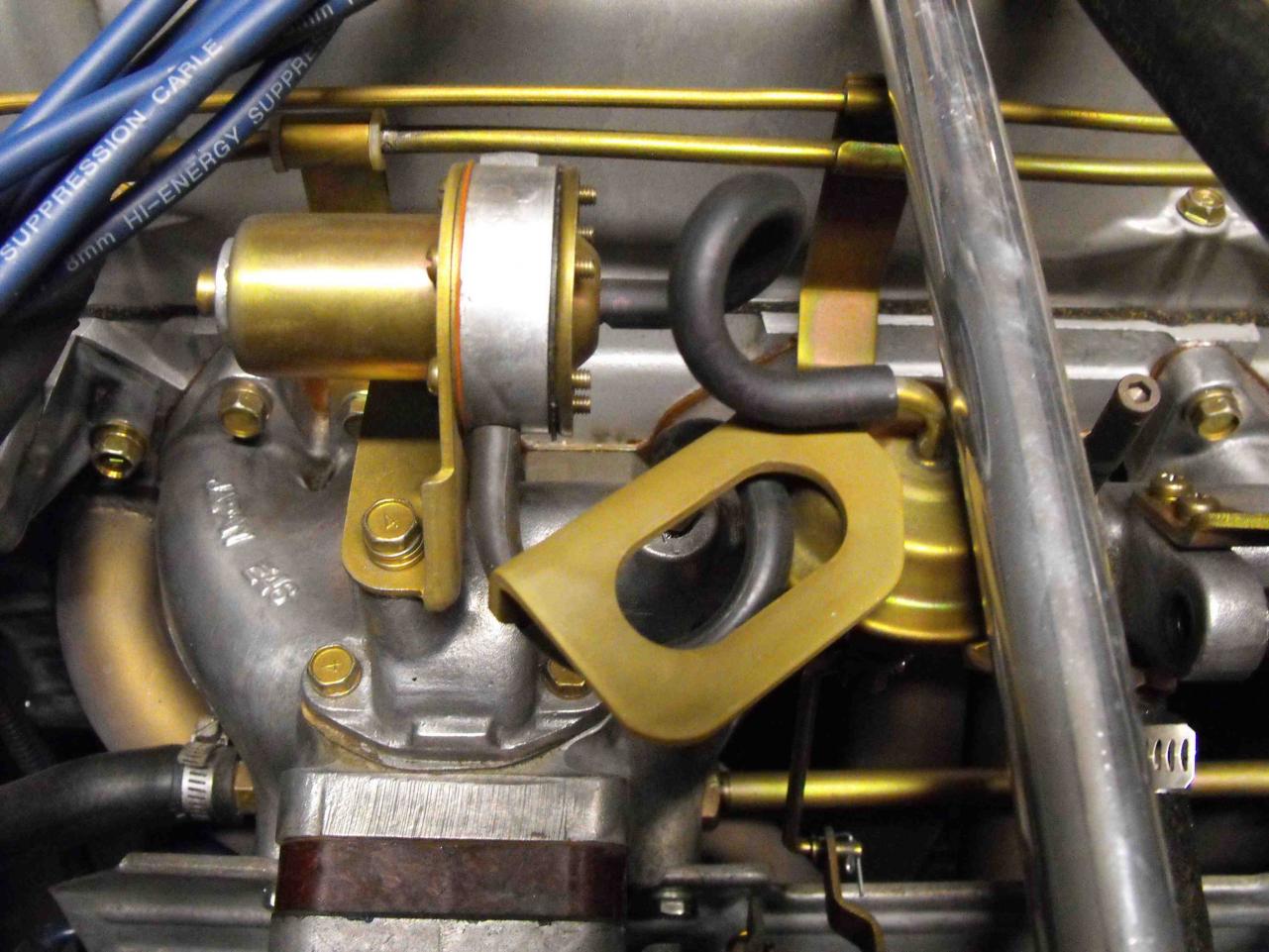

Also, I am getting much better with this. It's actually pretty exciting. Here are some more samples. Got my son doing it now for parts on his T-bird.
