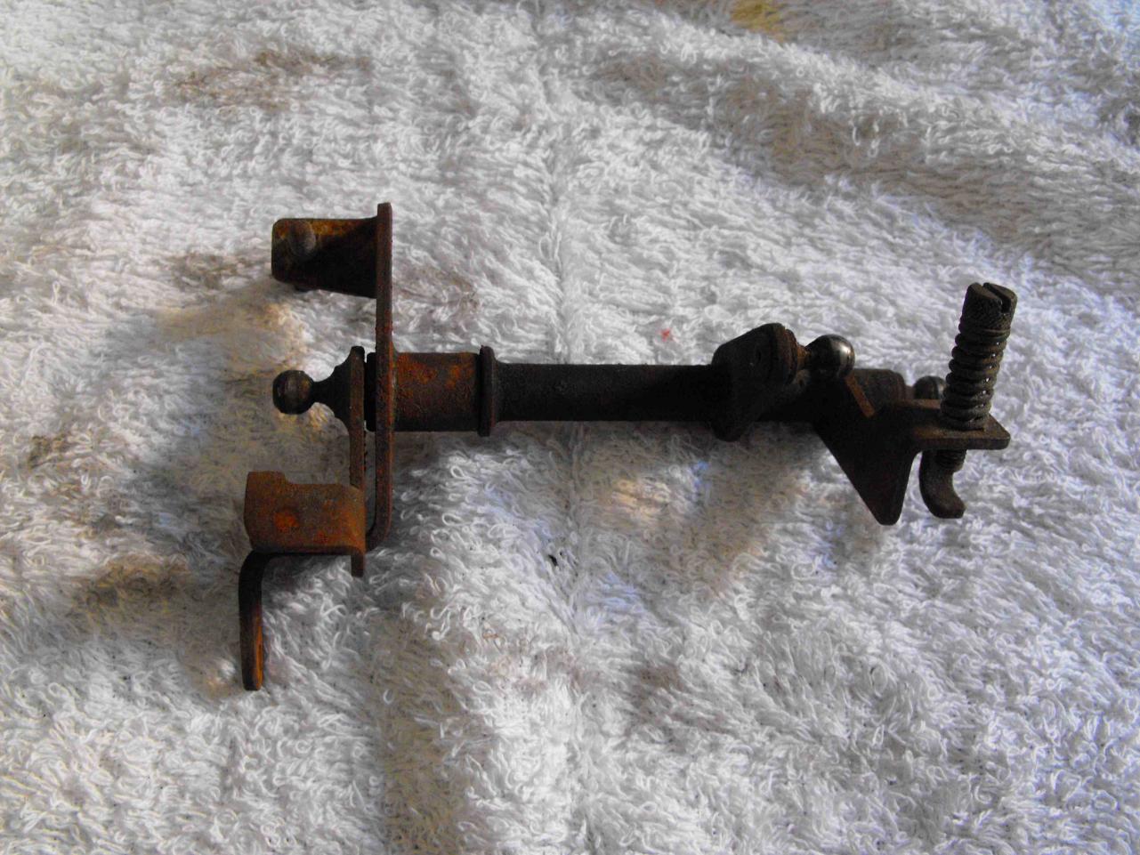

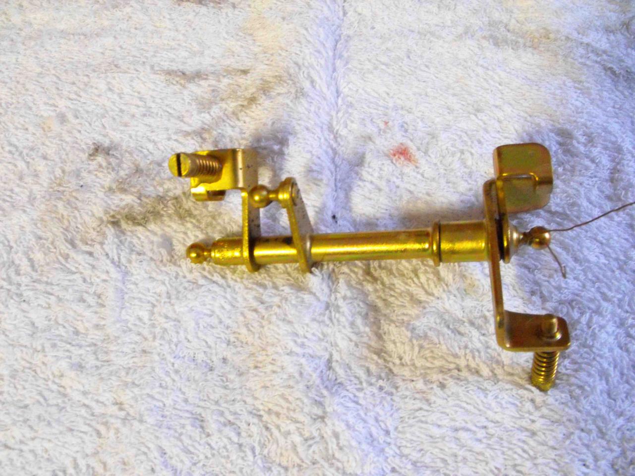

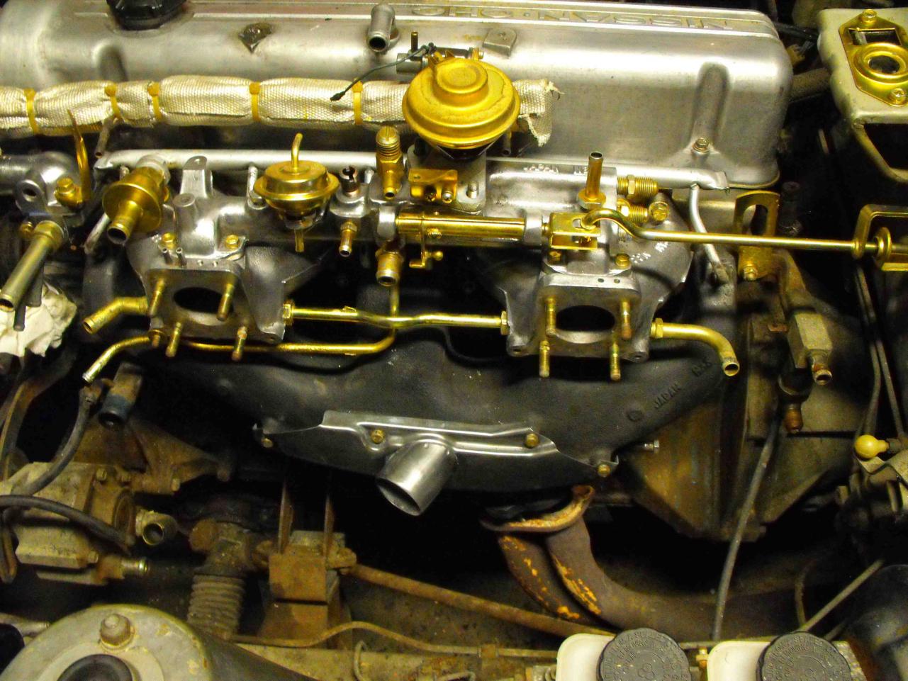

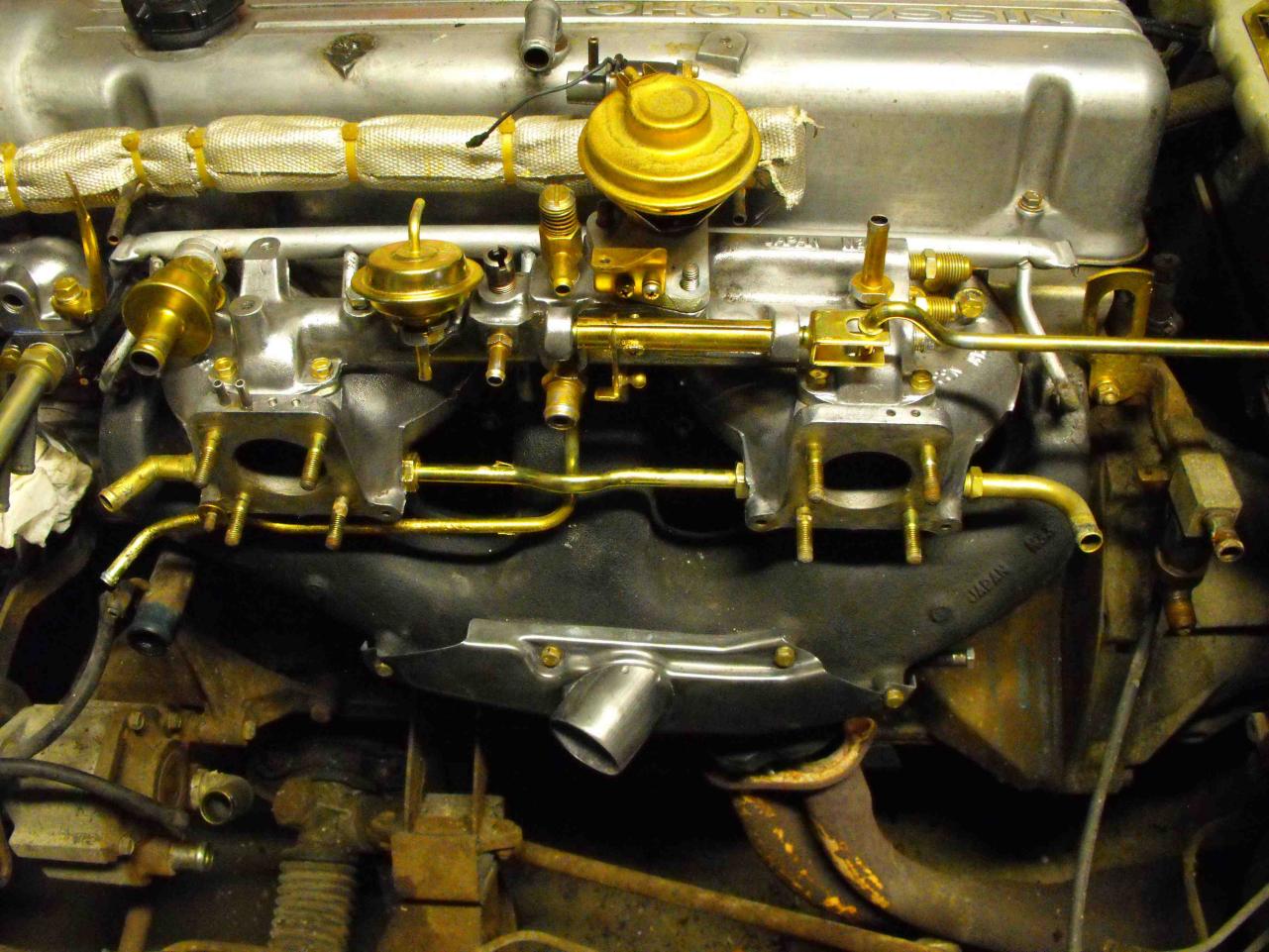

I must say that I really enjoy this zinc plating stuff. I think the enjoyment comes from the fact that in about 30 minutes you can take something that looks like complete garbage and turn it into something gorgeous. Here are a couple before and after pics of stuff I did today. The flourescent lighting makes stuff look a bit orangey. In real life, the parts look much better.
The only problem I have here is Patience. I am supposed to let the Yellow Chromate dry for about a day since I dont bake it at 150 to cure it. The problem is that I want to assemble NOW. So, here is what I put together today. Most of this was plated and assembled today. Only a few pieces were done a last week. It makes assembly slow, but sure looks nice.
