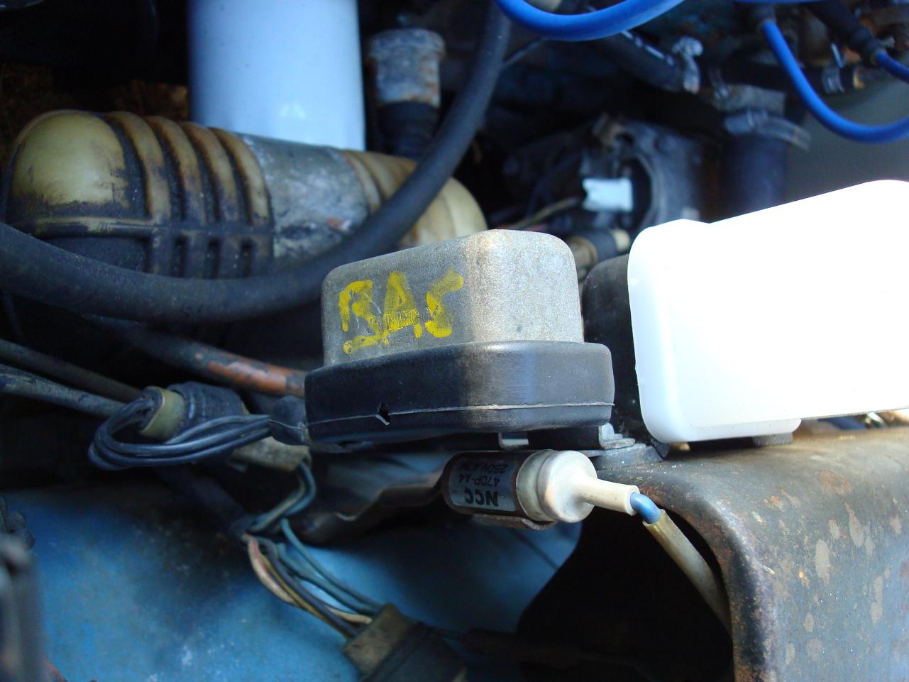

Posted November 16, 200915 yr comment_300422 I need help identifying this box, as you can see the cover is all but gone and it sits nexto the fusible links directly under the poorly engineered hood vent on the passengers side that does not have a plate to stop water from pouring on to it. Not sure if i have to replace the whole box or if i can get a new cover :disappoin Edited November 16, 200915 yr by kjphilippona Link to comment https://www.classiczcars.com/forums/topic/33837-what-is-this/ Share on other sites More sharing options...
November 16, 200915 yr comment_300424 It appears to be a relay with a rubber boot to protect the terminals. I will defer to the 280Z experts on its purpose, but I suspect all you need is a new boot, assuming that everything on your car works. Link to comment https://www.classiczcars.com/forums/topic/33837-what-is-this/#findComment-300424 Share on other sites More sharing options...
November 29, 200915 yr Author comment_301659 Does anyone know where i can find a new boot for the relay ? Link to comment https://www.classiczcars.com/forums/topic/33837-what-is-this/#findComment-301659 Share on other sites More sharing options...

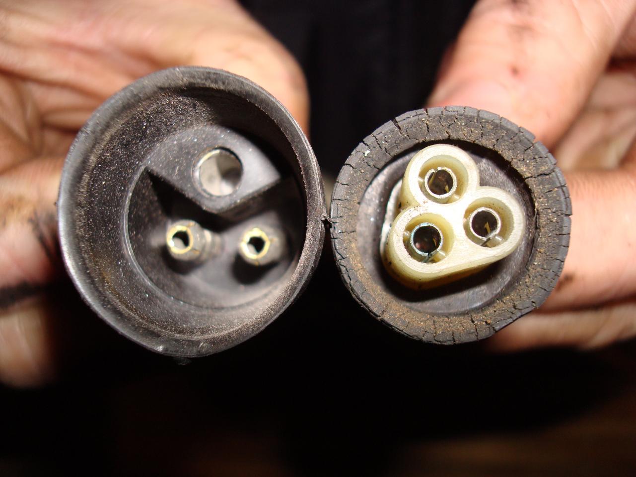

November 29, 200915 yr comment_301673 I think that's an A/C relay. I might even have one laying around. I'll check and get back to ya. **OK** found it. But it looks like you'll have to unsolder the wires on your relay to install the rubber boot. I'll give you the whole thing for $6.00 Shipping. PM me if you're interested. Dave Edited November 29, 200915 yr by Zs-ondabrain Link to comment https://www.classiczcars.com/forums/topic/33837-what-is-this/#findComment-301673 Share on other sites More sharing options...
December 19, 200915 yr Author comment_303740 Hi Dave, I want to get this right, what wires do i connect to my plug ? Edited December 19, 200915 yr by kjphilippona Link to comment https://www.classiczcars.com/forums/topic/33837-what-is-this/#findComment-303740 Share on other sites More sharing options...
December 19, 200915 yr comment_303744 place the 2 relays next to each other, you'll see that the soldered terminals should line up. unsolder then all, slide the 280Z wires thru the new boot from the 260Z relay then solder the wires back onto the 280Z relay.That way you're still using a Known good relay with a better looking boot and the correct connector. Link to comment https://www.classiczcars.com/forums/topic/33837-what-is-this/#findComment-303744 Share on other sites More sharing options...
December 20, 200915 yr Author comment_303769 Thanks Dave worked like a champ Link to comment https://www.classiczcars.com/forums/topic/33837-what-is-this/#findComment-303769 Share on other sites More sharing options...
