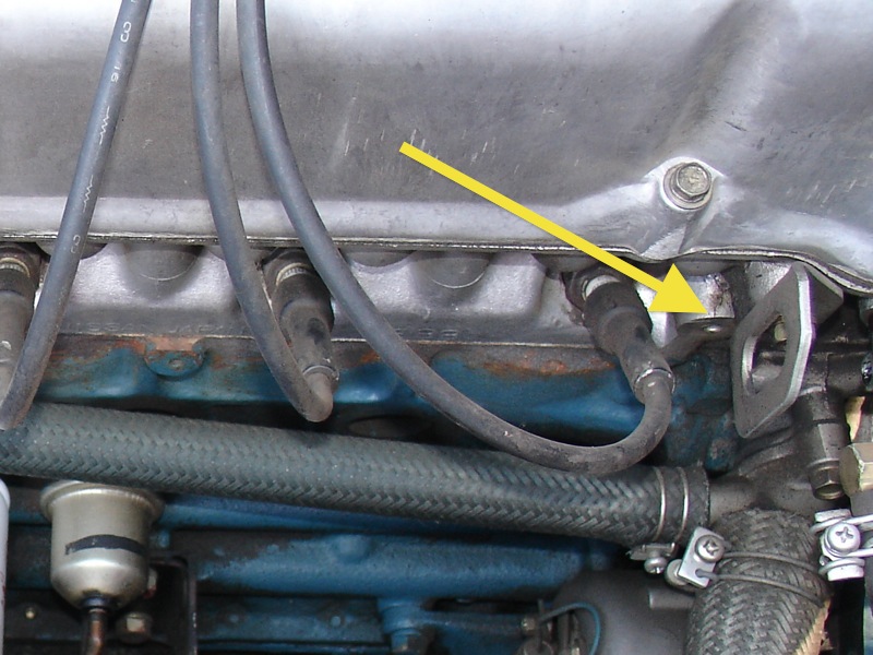

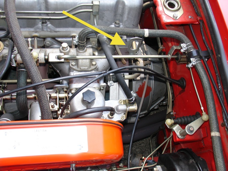

I am removing my long block for replacement with a rebuilt long block. I have reveiwed the 4 manuals that I own and none clearly identify and locate the lift points for teh block. Can anyone show me what block/ head bolt holes to use to fasten to the lifting tackle on engie hoist? Thanks
I was just complaining out loud myself and wondering how folks pull the motors in their Z's. I have 5 240/280's and three zx's, one a turbo, and all of them have a loop in the front of the motor and not a single one has one at the rear. I just pulled the turbo motor tonight and since I already had the tranny off, I put a bolt on the top drivers side of the block in a tranny mounting hole. I find it very difficult to believe that all of the rear loops were inadvertantly left off. Without the rear loop, where does everyone else attach to the engine?
