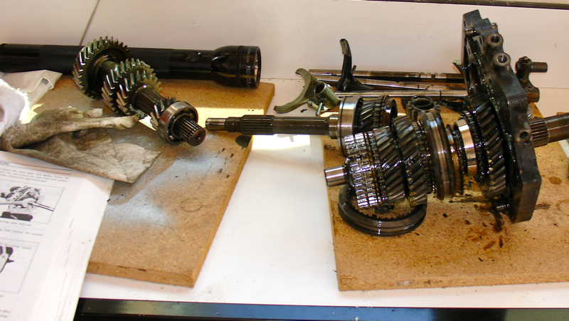

November 30, 200915 yr comment_301761 A press is handy, but it can be done without if you are a bit creative in tools. But a good set of long-jaw pullers is essential, as is a factory service manual (FSM) that covers transmission repair. (You need the factory specs and tolerances.) I spent about $350 in parts to rebuild my early 4 speed (Nissan gaskets, seals, shims and synchro rings, generic bearings), I'd expect that to go to $400 or so for the extra synchro ring and such for the 5 speed. You'll also need a large, very clean work area for this. As well as patience and time. Many people are intimidated by this work, but I've found it not too difficult. Link to comment https://www.classiczcars.com/forums/topic/33982-280z-transmission-rebuild-or-swap/#findComment-301761 Share on other sites More sharing options...
