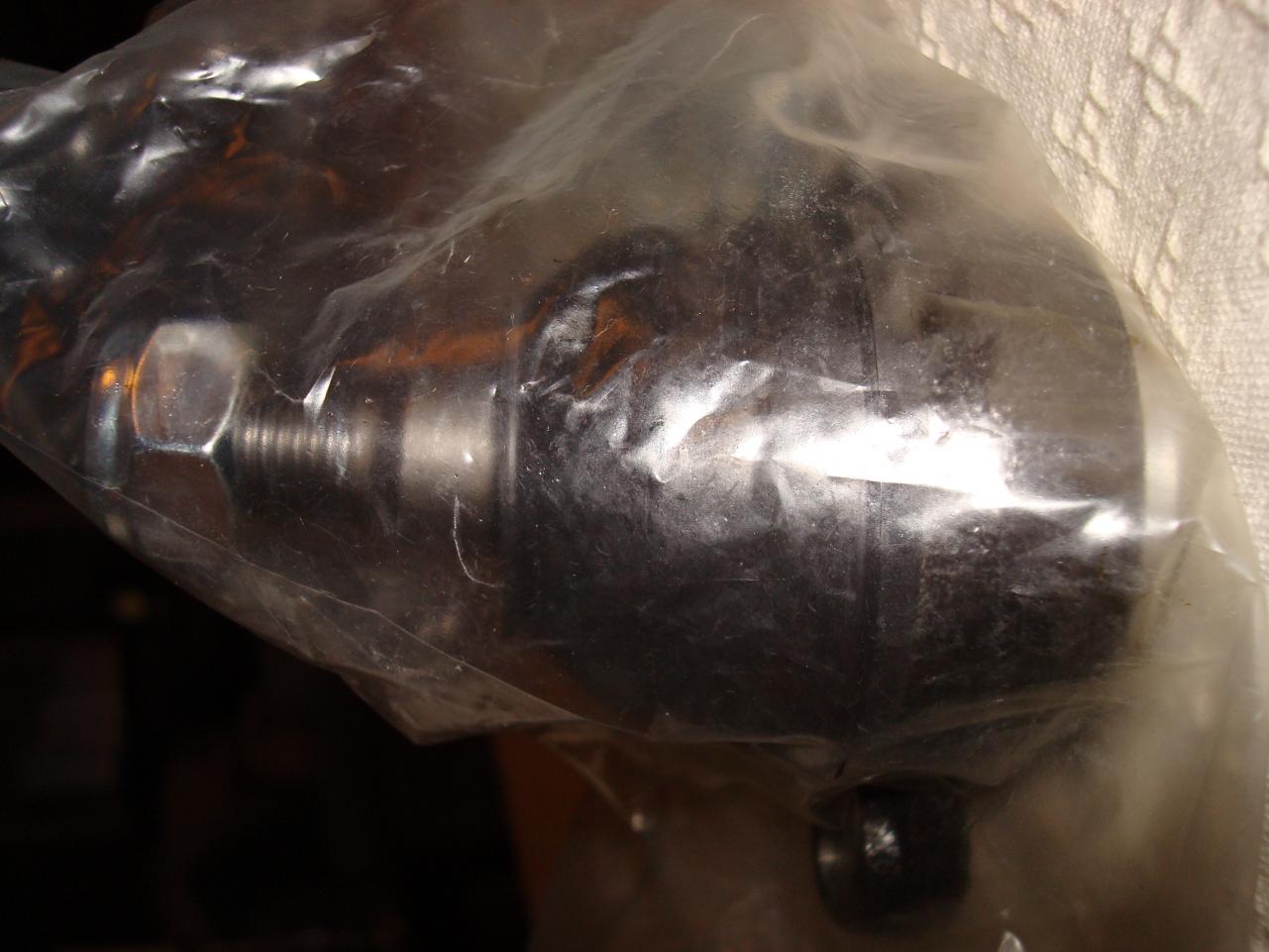

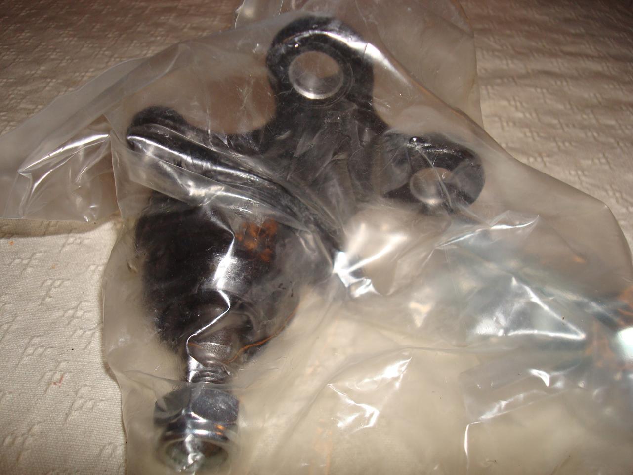

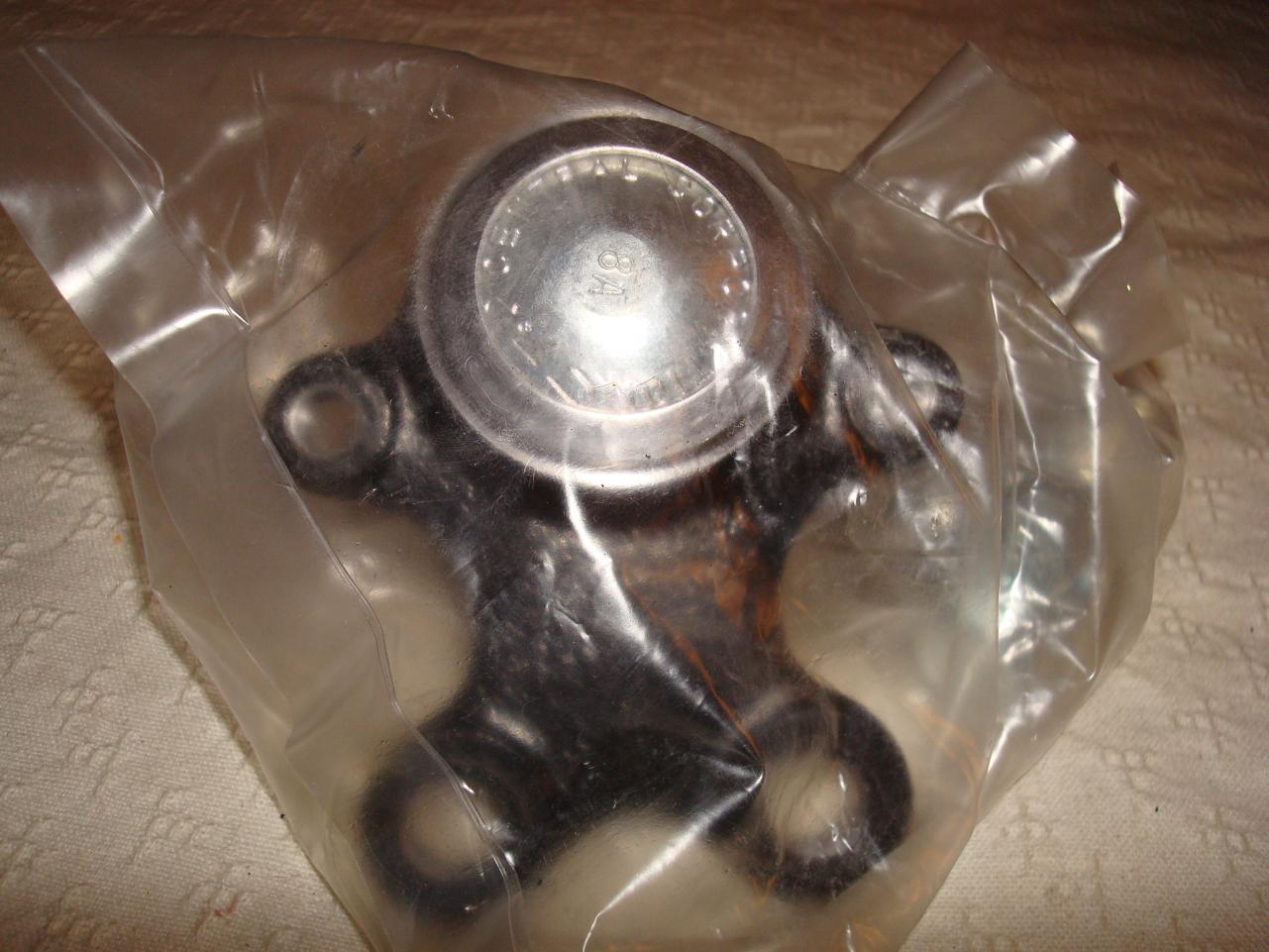

Here are a few pictures, definitely not what is advertised, i only have such little time to work on this car and when things like this happen really upset me. Sorry about the picture quality, i did not want to remove it from the plastic sealed bag since i will be returning them :mad:

Those look like a typical aftermarket sealed ball joint, as used on many new cars today. While it's possible they may not be quite as durable as the factory parts, it is equally possible that they might be as good or better. Hard to say for certain.
I do suspect that at worst, these parts will likely last several tens of thousands of miles. Yes, you may wish to monitor the condition of the sealing boots, but I'd guess that they'll be quite fine for several years at least for a normal daily or weekend driver.
