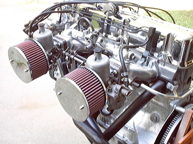

Posted December 16, 200915 yr comment_303404 Sorry guys I spent hours looking for this problem on the search and forums but cant find it.. Im trying to get my carbs set with the unisyn but there is one problem.. The front carb doesnt read unless I have mypalm on it and the rear reads fine.. So does anyone knwo whats going on here? I thought it was the tool but its not. I put my palm and it sucks in but the rear sucks in like it wants to eat my hand.. Any input whats going?Thanks for the help guys Link to comment https://www.classiczcars.com/forums/topic/34147-unisyn-trouble-on-sus/ Share on other sites More sharing options...

December 16, 200915 yr Author comment_303425 oh really?man I thought I was going nuts,.. Anyways the carbs are rebuilt and I guess I will order the Ztherapy video..here is a picture of my engine Link to comment https://www.classiczcars.com/forums/topic/34147-unisyn-trouble-on-sus/#findComment-303425 Share on other sites More sharing options...
