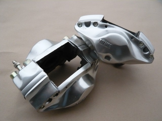

Ideally, what you replace your stock brakes with would be as good as well serviced stock brakes or better by some measure. Brakes convert kinetic energy to heat so having larger calipers is only part of the equation. Lighter would be one measure of better. For instance, I discovered that Alfa Romeo GTV aluminum Brembo brakes had the same bolt spacing as my stock Porsche 914 caliper. As an added bonus, they were spaced for a vented rotor. Porsche is a master of economy so they use the same bearings and spindle size on the 911SC. So, I got lighter aluminum brakes and a vented rotor. Better on two counts, lighter and better at dissipating heat. As an added bonus I polished them so they are so sexy people oooh and ahhhh over them all the time. See the picture below. These weigh 4# per side less than the factory calipers! 8# of unsprung weight!!!
Has anyone really searched to see what else had the same mounting bolt spacing and could use a vented rotor that would also fit?
This would be an improvement worthy of arguing with the original engineers. I recall an engineer from Lockheed-Martin that used to post to the old IZCC email list saying words to the effect - arguing with an engineer is like mud wrestling with a pig. After a while your covered in mud and you realize the pig loves it. Bottom line is this; if you cannot measurably improve on the braking - stick with well serviced stock brakes. They were engineered by the factory and should be just fine with a set of really good pads.
