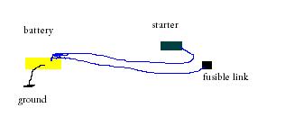

Posted December 28, 200915 yr comment_304351 I bought an optima battery and have had it under the hood for a while but the fit is kind of weird so I made a spacer to put in my tray to get a better fit but it's not the best solution so I want to relocate to the trunk. I looked online at kits and everything, but am I correct that to do the relocation I just need 2ga welding wire to go from the starter through the firewall and into the rear, splice(extend) the fusible link plug from under the hood through the same area and onto the battery, and a ground going to the trunk floor? I am going to have a simple box welded out of spare aluminum and bolt it to the trunk floor also. I figure with the weight in the back it would help a bit with the COG as well as solving my fitment problem. Edited December 28, 200915 yr by Cornbreadxd Link to comment https://www.classiczcars.com/forums/topic/34242-quick-battery-relocate-question/ Share on other sites More sharing options...
December 28, 200915 yr comment_304388 I see no reason to run the fusible link wire all the way to the trunk to get to the battery. Under the hood, just pretend the starter terminal where the battery line connects, is the +side of the 'battery' and connect the fusible link there. Other than that, be sure to get an EXCELLENT secure, clean (paint and dirt free) ground point in the trunk to frame steel and use the same gauge wire as the +cable going up front. Protect it against corrosion so it keeps working well for you.Others have fit an optima in the stock position and been pleased with the result, there are posts about how they did it here somewhere, do a little searching. Jim Link to comment https://www.classiczcars.com/forums/topic/34242-quick-battery-relocate-question/#findComment-304388 Share on other sites More sharing options...
