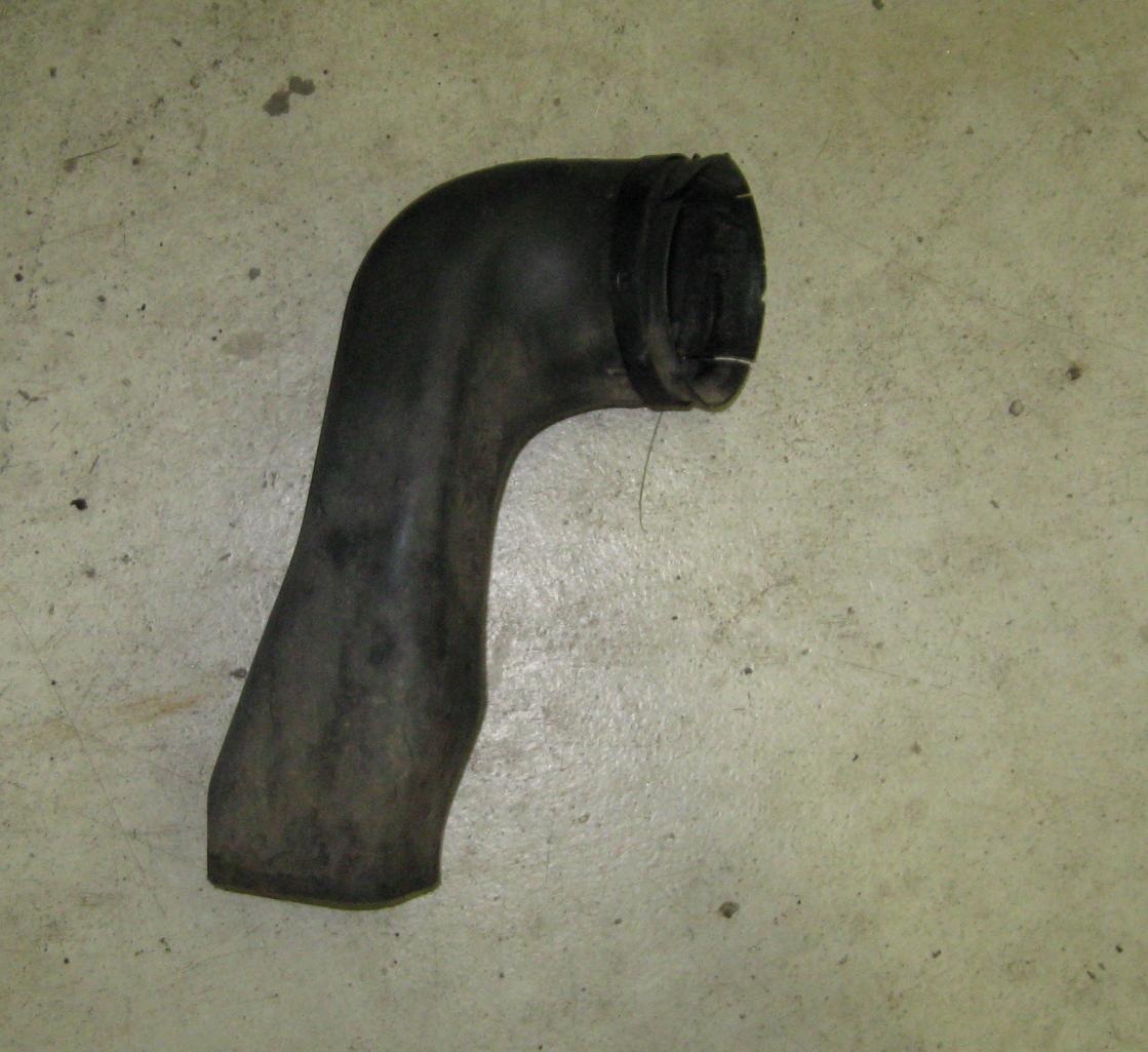

Posted December 28, 200915 yr comment_304422 Do you know what this does and where it goes? In more than 10 yrs of looking at Zs in car shows, junkyards and stripping them I have only come across 2 of these. Great idea and I wish I had more. I believe I know why they go missing as well..... Link to comment https://www.classiczcars.com/forums/topic/34247-who-am-i/ Share on other sites More sharing options...

December 28, 200915 yr comment_304425 came from the 280zx with the injector fan. Big end attached to the fan, the other end is at the bottom drawing the ait from under the car. Link to comment https://www.classiczcars.com/forums/topic/34247-who-am-i/#findComment-304425 Share on other sites More sharing options...
December 28, 200915 yr comment_304426 came from the 280zx with the injector fan. Big end attached to the fan, the other end is at the bottom drawing the ait from under the car. Not so. Attached photos show the unit you've described. Link to comment https://www.classiczcars.com/forums/topic/34247-who-am-i/#findComment-304426 Share on other sites More sharing options...
December 28, 200915 yr comment_304427 research it again zbane. The part gnose is the one that draws the air from UNDER the car.Not so. Attached photos show the unit you've described. Link to comment https://www.classiczcars.com/forums/topic/34247-who-am-i/#findComment-304427 Share on other sites More sharing options...
December 29, 200915 yr comment_304430 Not trying to be argumentative, but there is no piece that draws air into the fan from under the car. The opening faces the rear of the engine bay, and has no tube attached-nor are there any holes or markings to imply that one was intended. As I've not got mine with me, I can't take specific photos of the unit, but here is the FSM page detailing the aux blower. Note that there is no representation of a downward pointing air intake. Perhaps it's different on a zxt... If so, I'll happily admit and accept my error. Link to comment https://www.classiczcars.com/forums/topic/34247-who-am-i/#findComment-304430 Share on other sites More sharing options...
December 29, 200915 yr comment_304431 Nah, that's the elusive spinctoid frabmoister hose (spelling?). Best I can do without a clue. If you have only ever seen two of them chances are, I'll never see one. Link to comment https://www.classiczcars.com/forums/topic/34247-who-am-i/#findComment-304431 Share on other sites More sharing options...
December 29, 200915 yr comment_304433 Just because the fsm doesn't have it doesn't mean it isn't there. There is a clamp that holds it to the inlet you mentioned, it is not screwed into the housing.Drawing the air right next to the engine defeats the purpose of the cooling fan. That is why they used the above duct to get the air flow away the heat of the block. Link to comment https://www.classiczcars.com/forums/topic/34247-who-am-i/#findComment-304433 Share on other sites More sharing options...
December 29, 200915 yr comment_304434 Darrel is correct as to the part's placement and function, however I believe it only came on the turbo models. Link to comment https://www.classiczcars.com/forums/topic/34247-who-am-i/#findComment-304434 Share on other sites More sharing options...
December 29, 200915 yr comment_304439 Found it in the microfiche. Part # 21495-P9000 Duct Assy- Air Intake -Turbo from 12/80 #31 Edited December 29, 200915 yr by geezer Link to comment https://www.classiczcars.com/forums/topic/34247-who-am-i/#findComment-304439 Share on other sites More sharing options...
December 29, 200915 yr comment_304440 Darrel, your logic is fair. It does seem true that the FSMs don't always cover everything, and something like this might have been overlooked (or not thought of) prior to printing. As my car is a 79, and therefore obviously not a turbo model, I'll concede that you're correct-especially if this is a zxt specific part. Link to comment https://www.classiczcars.com/forums/topic/34247-who-am-i/#findComment-304440 Share on other sites More sharing options...
December 29, 200915 yr comment_304442 zbane, accepted.If I didn't know exactly what the part was and where it was on the car I never would have posted. I know there are sutble differences throughout the range of z cars and will never know them all. If I don't recognize something, I may think to myself about where it might go, and may ask for others opinions, but I don't think I would definitely say it did or did not have it.it's a wrap! ;-) Link to comment https://www.classiczcars.com/forums/topic/34247-who-am-i/#findComment-304442 Share on other sites More sharing options...
