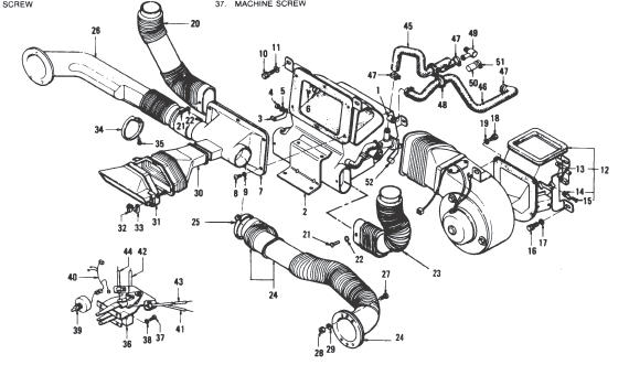

Listen to Arne and Darrel. You cannot get heat from the dash vents regardless of control settings. They only work when "Air" is in "Vent" and this connects you the outside. check page 13 of the supplemental chassis Manual of the FSM. I have a picture of it attached.

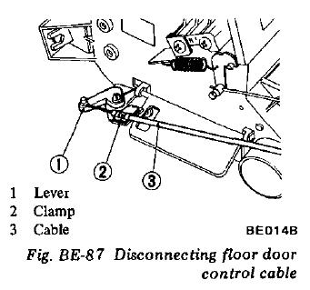

You're inability to move the slider to "ROOM" is a problem with the cable, the slider mechanism, or the connection of the cable to the flapper doors on the left side foot well heat outlets, which is what that control moves. It just closes the two external flap doors at the base of the unit which pushes all heat to the defrost vents when in the DEF position. I also attached a picture of the control cables on the left side from the 76 manual (very similar) for clarification.
You haven't somehow connected the defrost air ducts to the vent ducts have you? Or perhaps the central flapper valve in the heater box (under the #6) in the picture) is/was partly open allowing heated air to get into dash vent system.

Those pics are Great, I downloaded the 72 FSM but do not have the chassis supplemental you mentioned. Looks like the AIR and DEF are on the left (drivers side), and the TEMP is on the right (pass side) close to the TEMP VALVE where the heater line comes in from the engine.
Seems the AIR cable is on the top in that second picture, and the DEF cable is on the bottom. Both look like I should be able to get to them. I think the DEF cable is the one I need to focus on. Those are a great help and that blow up of the ducting is INCREDIBLY helpful.
EDIT, just upon closer inspection, it would appear that the AIR lever in the dash actuates two different cables. One selects Heat or Vent locations for the central flapper, the other selects fresh or recirc air. Did I get this right. I am trying to make sense of the drawings. I am thinking the VENT selection gives you outside air, and the off selection gives you recirc.

Excellent. A picture can really be worth a thousand posts....
Your description of what cable is connected to what seems accurate.
I have some control sets and HVAC units and cables that I can take pictures of so you can see the real and complete setup if need be, but I bet you have the information you need now to fix the problems.
