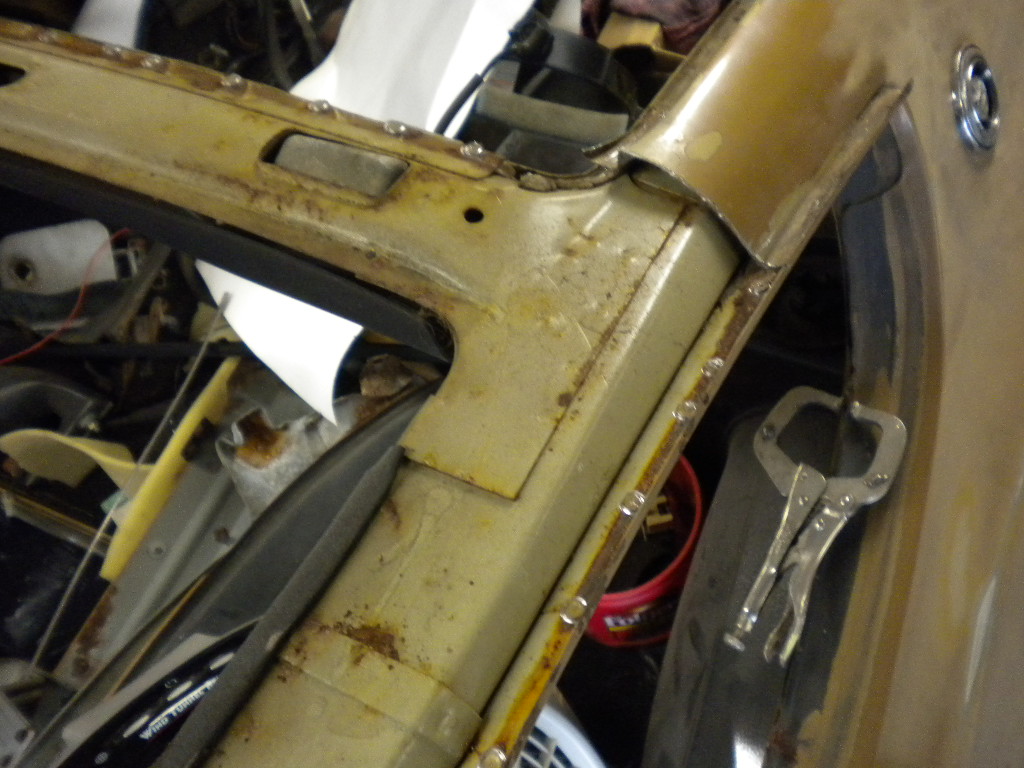

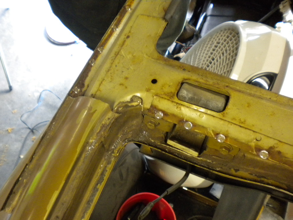

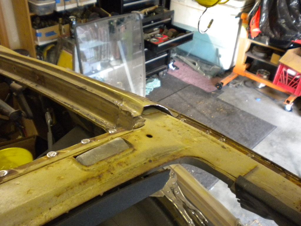

So I got back out there today and ground down the spot welds, cleaned all the rust and sprayed the exposed metal with weldable primer. Then I fitted the skin to the shell and aligned the front window area first, clamped it down then moved along the sides, which I might add, dropped right inplace. I only had to shave 1/8" off the rear of the panel and they corners dropped in place.
More to come after I grind the welds, smooth it out and primer it.
