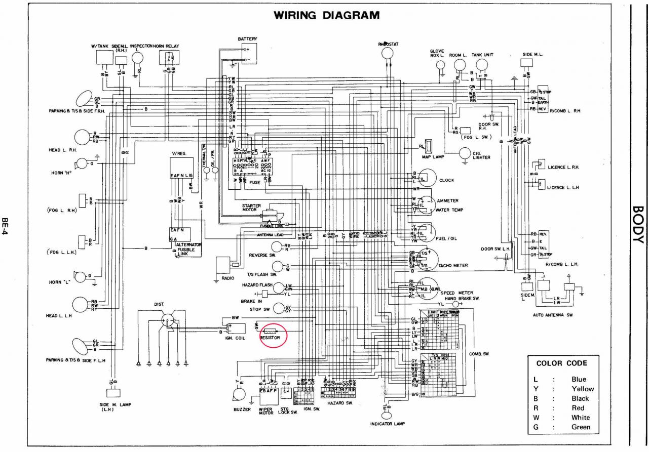

January 12, 201015 yr comment_305868 Sorry to hijack, but I am trying to determine if my dancing, incorrect tach is at fault, or if it is an in line resistor. This is for a late 240z (7/73). Assuming the wiring diagram will attach, does anyone know the actual location of the resistor in the red circle on the diagram? It is on the diagram just right of the ignition coil. Thanks. Edited January 12, 201015 yr by tlorber error Link to comment https://www.classiczcars.com/forums/topic/34337-260-tach-woes/#findComment-305868 Share on other sites More sharing options...
January 12, 201015 yr comment_305869 Todd, it depends on if you have a 3 wire or 4 wire tach, being it is a late -73 i guess it is a 3 wire and i haven't found a correct wiring diagram for that specefic model, i think you will find the resistor in a 260Z wiring diagram, the resistor in the diagram you have attached is as far as i know the ballast resistor.Chris Link to comment https://www.classiczcars.com/forums/topic/34337-260-tach-woes/#findComment-305869 Share on other sites More sharing options...

January 13, 201015 yr comment_306025 2 fast 2 Z said: Todd, it depends on if you have a 3 wire or 4 wire tach, being it is a late -73 i guess it is a 3 wire and i haven't found a correct wiring diagram for that specefic model, i think you will find the resistor in a 260Z wiring diagram, the resistor in the diagram you have attached is as far as i know the ballast resistor.ChrisTlorber, could you describe how the tacho behaves (e.g. is the dancing at specific RPM areas or already after switching the ignition on, does the incorrect display happen over all the RPM range or only at specific spots?).The symptoms could either indicate a defective tacho driver circuit or an incoming signal with a voltage level which is too high. If your tacho is indeed defective, i am happy to do a repair and calibration for the cost of the spare parts (if the magnetic coil for driving the needle is still intact, then it should be no problem) but you would have to send it to germany. Link to comment https://www.classiczcars.com/forums/topic/34337-260-tach-woes/#findComment-306025 Share on other sites More sharing options...
January 14, 201015 yr comment_306048 Alhbln, When I turn on just the ignition switch, the tach goes to around 1000 rpm. At idle, the car shows around 2500-3,000 rpm and tends to run around 3-4k above actual (hard to know the exact number). It seems that it gets worse with heat. Would the parts to be replaced typically be the resistors? Many of them do not test at what their color coding shows they should.I know that tachs going out are a common problem. Maybe we here could do a group buy and fly you out our way. Link to comment https://www.classiczcars.com/forums/topic/34337-260-tach-woes/#findComment-306048 Share on other sites More sharing options...
