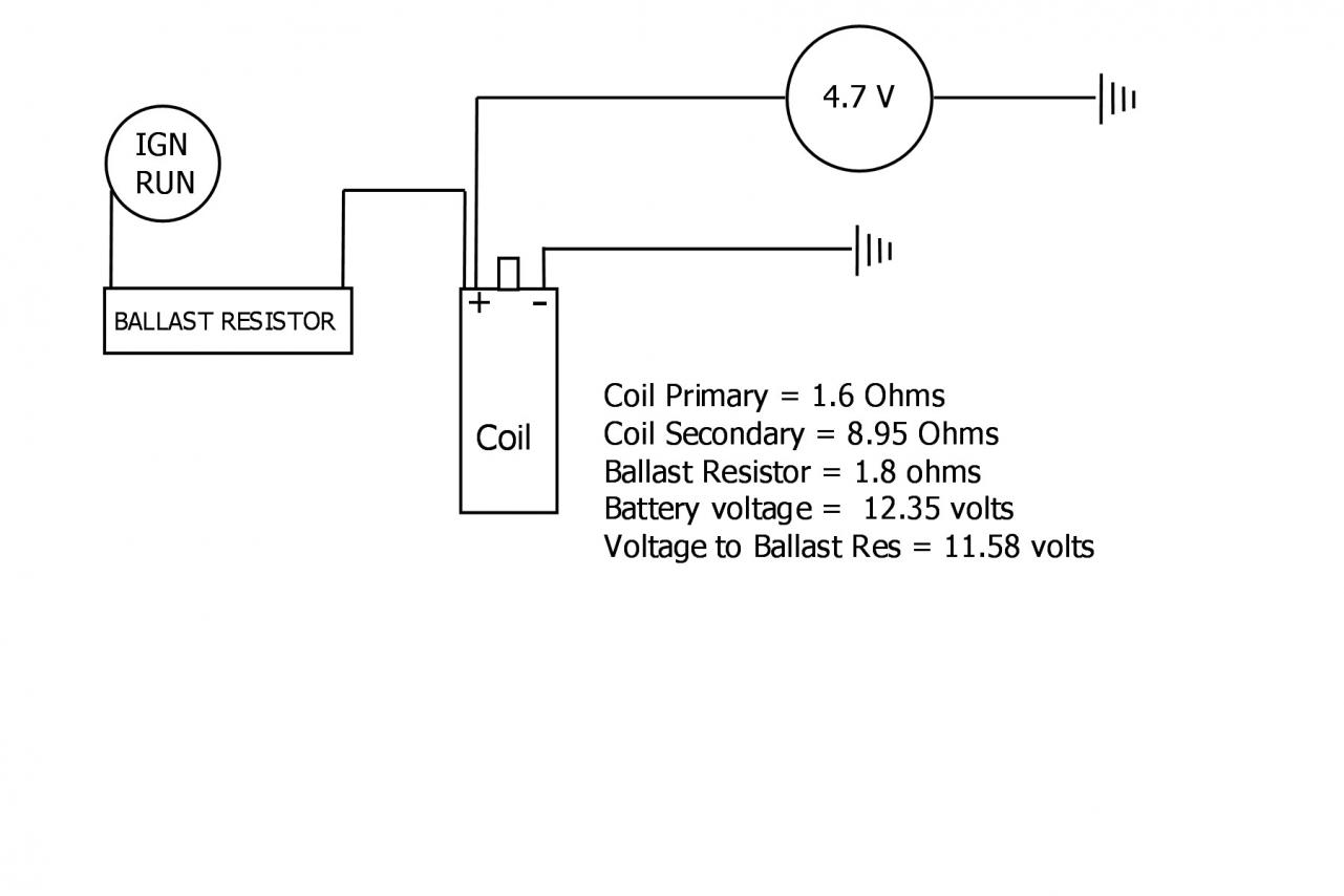

:ermm:I was checking some resistance and voltage readings as I continue to troubleshoot while waiting on the replacement dizzy - attached a sketch of the test - why would I be getting such low output voltage from the coil - is the coil bad?

I may be wrong but I believe the readings on your secondary windings is not at spec, at least not on a stock coil. I believe the resistance is suppose to be higher. Check the FSM. I dont know how that would effect the coil output though. good luck.
