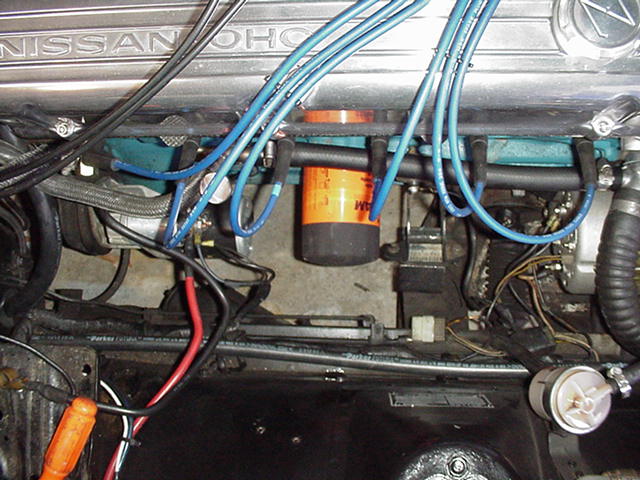

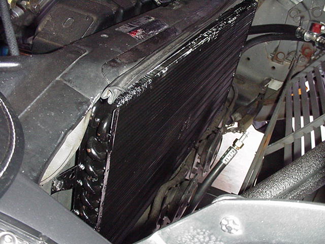

i used the existing holes to run two of the hoses but i will have to drill a new hole for the drain line. haven't hooked the hoses into anything yet, need to see where i want to mount the drier. mounted the new compressor on driver's side and put new belt on. the condenser has me puzzled on how to use the brackets that came with it.[ATTACH]34150[/ATTACH]. also instructions say that a sealing putty included is to be used around the firewall holes, but no putty in the kit.
My drier was mounted on the passenger side strut tower on the old AC and I mounted the new drier in the same spot. The drier covers the ID plate on the strut tower.The brackets mount to the top and bottom of the radiator support by drilling holes in the support. Dry fit the condenser to the radiator support first then drill holes in the raditor support as well as the condenser. Be sure not to drill into the lines of the condenser. You will have to bend the brackets some to make this work. The fittings on the condenser on mine are on the driver side and the long hose from the drier goes in front of the condenser. Use the clamps provided to secure the long hose from the condenser so the hose goes in about the middle of the condenser. I got the black putty from Bumper to Bumper Auto parts (Master Parts brand # FSE59010 Temp Control putty). The putty I used is about 1 inch wide and is in a roll. The best thing would be to find rubber grommets to surround the holes in the firewall. I also used some heat wrap tape to wrap the hose that runs from the unit to the compressor because I felt the heat from the engine and header might get a little to hot.

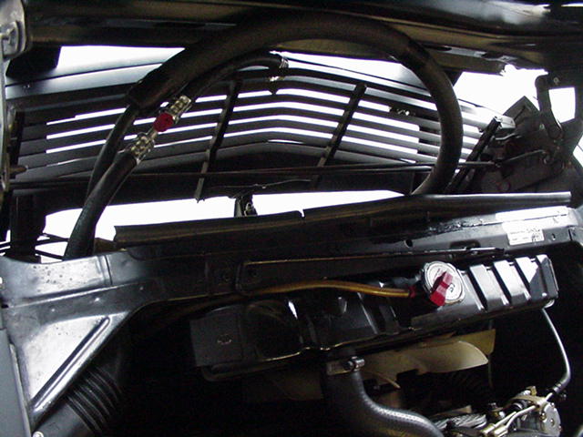

post-3352-14150809906179_thumb.jpg2 of the hoses are a mile too long, gonna have to shorten them. guess i'll mount the drier beside the condensor. still have to drill a hole for the drain hose, (not looking forward to that). the other 2 holes were already there from the old unit.
