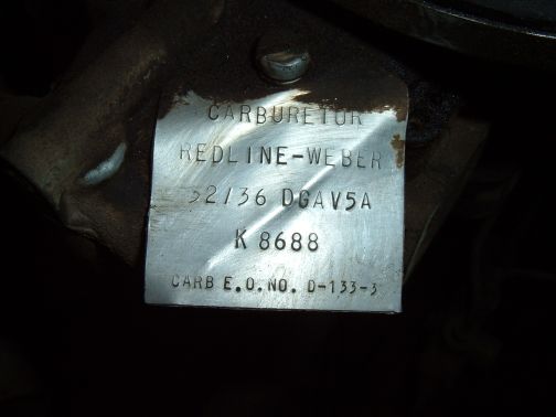

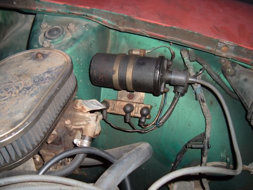

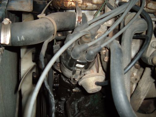

January 21, 201015 yr Author comment_306998 Ok a little elec. contact cleaner freed up the advance till I can get it out and do it proper. I attached some pics of the carb tag, dizzy and coil. If the dizzy is electronic do I need to upgrade the coil. Seems to me the old points setups used the resistor in line. I shouldn't need that with electronic should I? Looks like NGK bp6 is the plug # Not sure if I should get Iridium. vpower or what. Edited January 22, 201015 yr by torker Link to comment https://www.classiczcars.com/forums/topic/34496-34-cylinder-rich/#findComment-306998 Share on other sites More sharing options...
