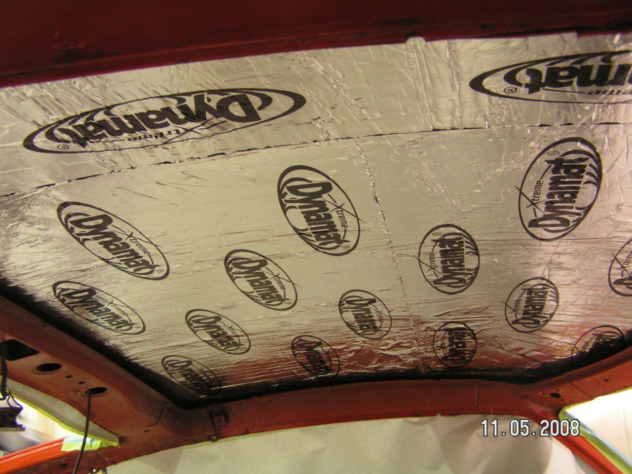

While you are up there you may want to put in a sound deadener which makes a HUGE difference in the cabin of the car.
