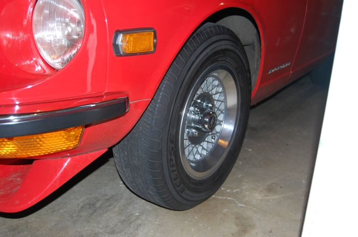

The old tires...and the wheels currently on the z... I'm thinking I want something more "square-ish" to the ground rather than with a rounded sidewall narrowing to a less narrow tread at the pavement... if ya know what I mean..
Mark, judging from how the tires fit your rims, your slots (probably dealer installed) appear to be 6" wide. If you are looking for tires that will fill the wheel openings well, the 195/70-14 size you have on it now is probably your best bet, although there isn't much in the way of performance tires in that size anymore. Also bear in mind that those old Michelins you have now do tend to be a bit narrow in the tread. Different brands are all a bit different that way.
The size of your rims does limit your choices some. If you are looking for a narrower, more stock size tire, use a P185/75R14. For wider, consider either 205/60-14 or 215/60-14 (if you can find any 215s, they're getting scarce these days). Both of those sizes are shorter than stock or what you have now, so they tend to make the wheel opening look large, unless you plan to lower the car.
To use more modern performance tires, many people these days change to larger diameter rims, at least 15", more commonly 16" or even 17". That allows you to select modern performance rubber without going too short on the overall diameter. But that means you have to replace the vintage slots, which I personally would be reluctant to do.

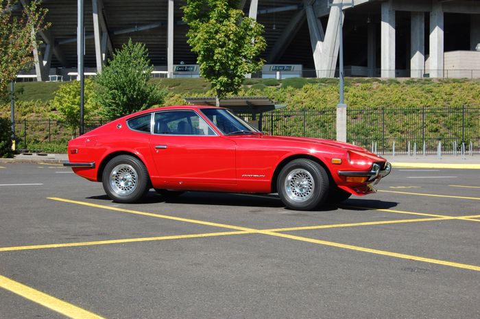

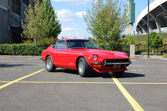

Personally, I prefer the original tall-sidewall look on these older cars, and so I stayed with the same size that you have on yours now. My rims (a different vintage style) are the same 14x6 size as yours, my tires are 195/70-14 Toyo Eclipse (may not be available in all parts of the country). I like how they fit and look on my stock height 240Z.

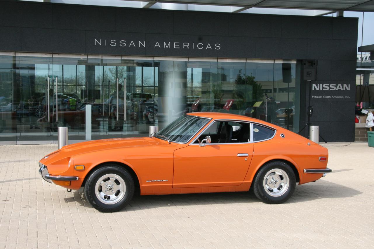

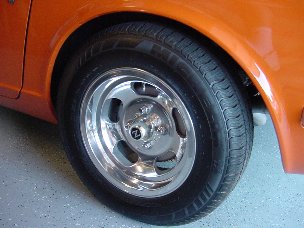

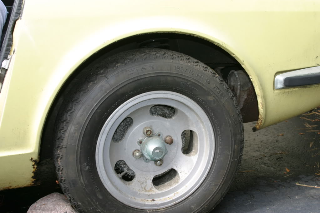

Sounds like your aesthetic jives with mine. I have no plans to do anything with the suspension for now and I plan on keeping these wheels (mostly for the original-ness).
Thanks for the pic. I hope others will post up with good pictures and similarly insightful input.
