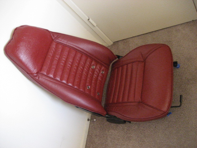

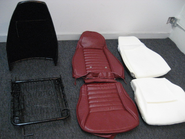

Here are a few pics of the seat. As I said, the listing wires were the most difficult part of the installation. The one beneath the headrest was the most trying to my patience. Adding wires to the hems is mandatory, I would say. So is adding some support to the foam in the base. Although the rear seam of the seat back had a nice rolled edge, I opted to attach it first, then the front piece. It just made more sense to me. A couple of the tabs broke off, so I just spotted them back on with a mig welder. Overall, very satisfying project - but not for the faint of heart. They look good - ask me in 10000mi if the products are any good.
