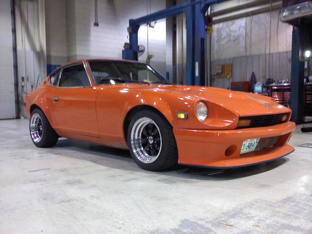

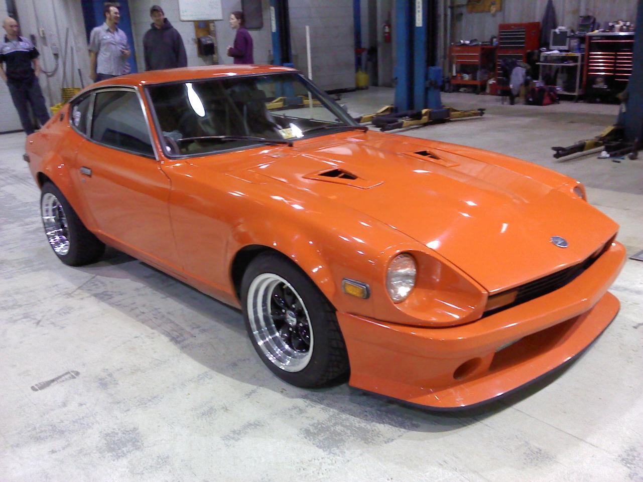

Finally got some new wheels for the Z. They're the xxr 513's in 15 x 8 with 0 offset. I'm running 1 inch spacers in the front and 1.5" in the rear to fill up the flares a little more. The tires are Falken ZE-502's in 205/50 R15. I have the Tokico 5020 (5220?) front springs that lower it about an inch.

thanks for all the compliments everyone...Yes I did take the pictures ( with my cell phone actually LOL..) and no unfortunately nothing cool is happening to the astro van..I work as a technician at a Chevy dealership, which makes it easy to put the Z up on the rack and work on it...(the red and black Matco box in the last pic is mine..haha).. Without the spacers I think the wheels would fit but I know the grease caps on the front would protrude to far out and not allow the use of the center caps....if its ok, I'll plug the site I bought the wheels from..excellent service, and extremely fast shipping.. they even put a picture of my car up in their nissan gallery, www.motorsportsr.com
