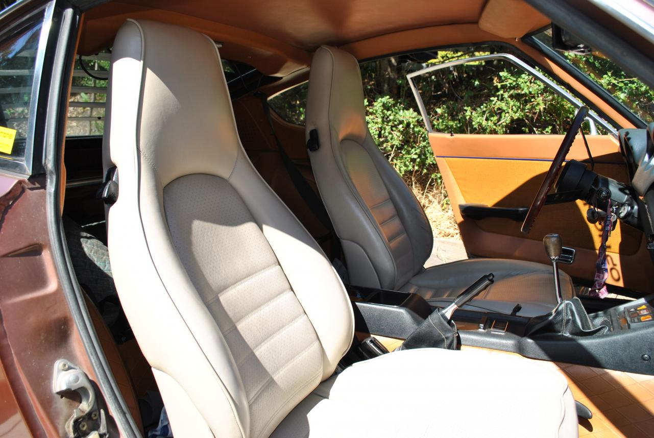

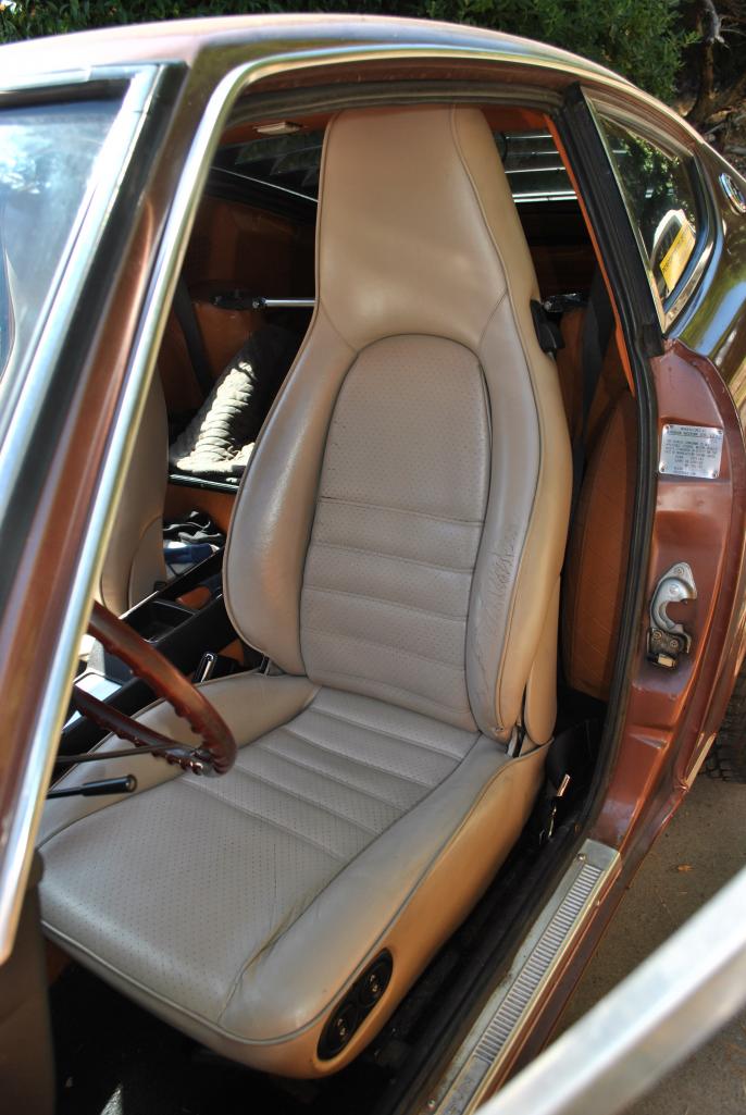

I've been thinking about doing 911 seats for a while and opportunity arose to buy a nice pair for a nice price. They are from an early 90s 911 and the driver has power. He explained the front and back of the seat bottom can be adjusted for elevation. They are certainly not light but I haven't weighed them yet. The seats have leather fronts and vinyl backs.
The seats have bottom mounts so adapting them to the Z's sliders should not be too tough. As you can tell, these look very similar to the Z seats and Porsche has used this basic design for a long time. I am not sure which seat came first but it would not surprise me if Datsun copied Recaro on these. I wanted sport seats that looked correct in the Z and I think these will work beautifully. They are also VERY comfortable, Porsche would not have used them for so long if they hadn't done something right.
As you can see in the first picture, they were grimy and needed some cleaning. One of my friends is an old time body man and general car guy, and he suggested using Kiwi Saddle Soap to clean and restore the leather/vinyl. Having followed his advice in the past with great success I had no trouble giving it a try. Using a bucket of water, fresh sponge, and 2 white towels, I set to work. The soap lathers with the sponge and elbow grease does the rest. When I was done with a section I wiped it down with the towel. It was pretty straight forward and this stuff worked great. I washed each seat and put them in the sun and then washed them a second time.
The difference is night and day, the seats are clean and they are much softer than before. The driver's bolsters have some wear but the leather is not cracked yet.

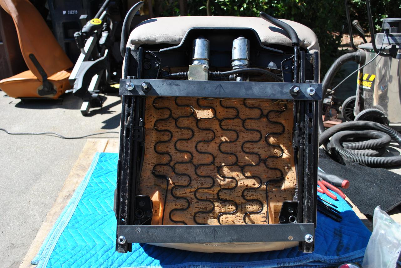

Some of you may remember seeing the first post months ago. Well, I finally made time to make brackets and install the seats. I've also been told more recently these are out of a 944, and not a 911. They all look so similar

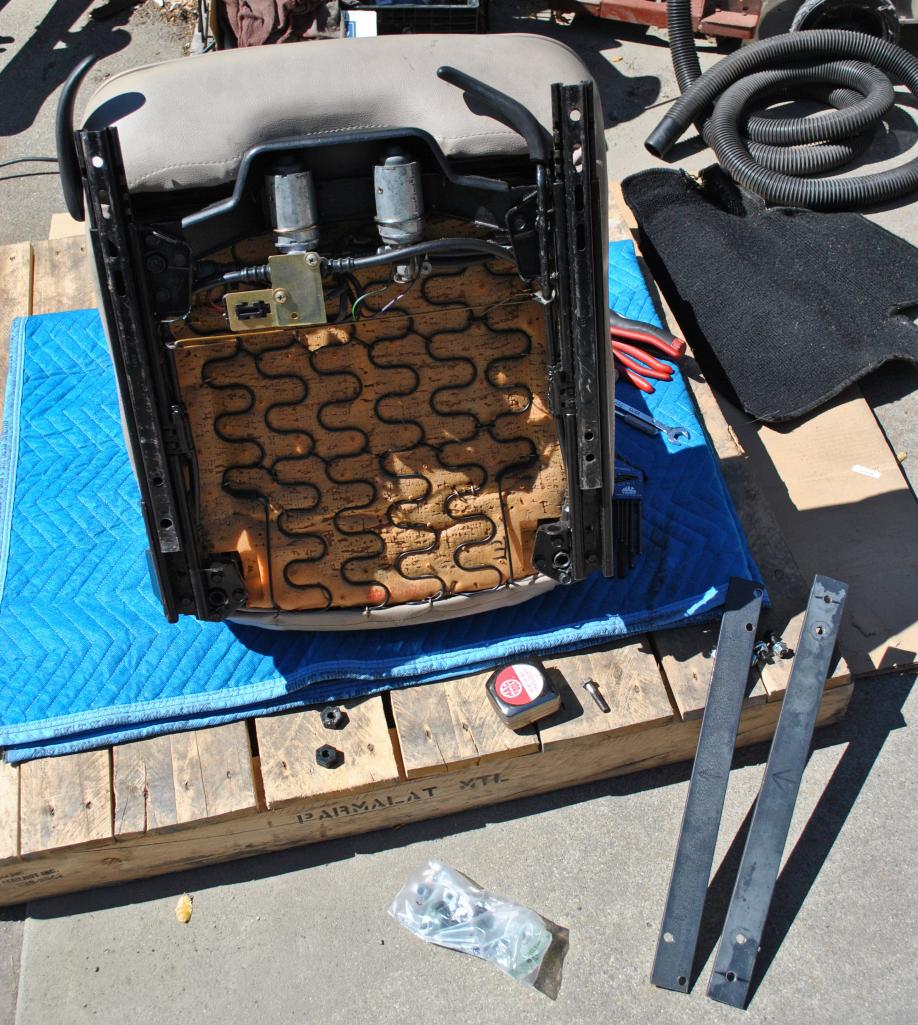

I ended up keeping the Porsche sliders. After removing the Z seats, I could tell the modern sliders were considerably stronger. The Z sliders only lock on 1 side and the other moves freely. The Porsche sliders lock on each side, which, I would assume, contributes to some stability.
Adapting the seats to the mounts just took some creative use of steel flat bar. I found the lowest profile bolts and locking flange nuts to mount the seats as low as I could. The bolts are class 10.9 so I'm comfortable with their strength.
Installed, the seats look like they were made for our cars. I sit a bit higher in the car but it's not too bad. I can probably get them lower but I don't want to cut or drill any of the floor bracing. The Porsche seats are wider so the sliders come very close to the floor bracing in the rear. I installed these with the intent of not drilling new holes or cutting. If you're 6 feet or taller, you will want to get these lower than I have probably.
I love the feel of these and am more happy with the color than I expected. Eventually I'll get the driver seat wired up but it's nice as it sits now. I also love the fact these flip forward with the switch. It makes tossing in a bag quick and easy. Unexpected perk :cool:
Those are either '80's 911SC or later Carrera 'Sport' seats with the extra side to side supports in the seat back.
"I am not sure which seat came first but it would not surprise me if Datsun copied Recaro on these"
I am not sure if Datsun copied Recaro but Recaro was a contractor to Porsche and that seat might have actually been made or designed by Recaro.
I think if you want to go to the trouble (I would have to) of getting them lower in the car, you could cut out the seat supports and lower them an inch or so. Might be the perfect finishing touch.
Interesting. I had a chance to get decent pair of 911 seats for cheap, but I measured them at about 2" wider than stock. I didn't think they would fit. Let us know if you find out for sure what car they were out of.
Thanks Dr. Rob, I do agree getting them an inch or so lower would really finish the look. I had one of the tall guys at my friend's shop sit in the car today, and he actually had a good 2-3" above his head when seated in the car. I forgot to ask how tall he is but I am 5'8" and he has to be at least 6 feet tall.
I appreciate the ID suggestions on these. It made me do a Google image search for "porsche 944 seats" and "porsche 911sc seats", and they look very close to the 944 leather seats. Both guys have said they are Recaro's regardless of the model from which they came. Looking at this link I got from the search, I'm pretty convinced they are 944

Drilling new holes in the front seat mount and bolting the sliders straight to that would lower the front ~3/4" (thickness of bar + spacer). Doing some modding to the rear brace will net maybe 1cm. You would probably need to fab a new bracket in the rear to go lower since the sliders are outside the rear mount 'pedestals'.
If I recall, the sliders on these seats are 16" apart (hole center distance). The forward bar I cut to 18" and the rear bar is cut to 17" wide. You can probably see the rear bar looks a little crooked because front-to-back distance of the bolt holes in the sliders are about an inch different on either side
