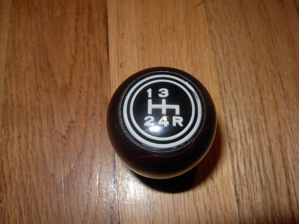

Has anyone had any experience in restoring an early series 1 shift knob? Specifically, the knob is in excellent condition except for the chrome mounting ring at it's base where some chrome has pealed off. I would like to remove this chrome ring and have it re-chromed without damaging the wood part. It appears that the chrome ring is glued to the wood mounting hole with some sort of epoxy.
I hate to just go in and try to drill out the epoxy without knowing exactly how it interfaces with the wood.
Thanks for any thoughts.

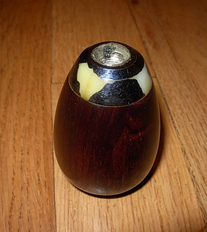

I had one with a shift pattern button that was not worth saving. The plastic base ring was split with no chrome left on it. The wood is in good condition and can be refinished. I used a heat gun to reconstitute the glue that was used when these were assembled. In these two pics, you can see what it looks like with the shift pattern button removed and the 1 piece plastic plug that was held in place with the same glue. After applying heat. I used an appropriately sized rod and tapped it out with a small ball pean hammer. I did use too much heat and the button didn't fair well. The glue is fairly brittle with age.

From what you describe, and the attached picture, it looks like the chrome ring and plug that is glued inside the wood knob is one molded piece. So, if I used a heat gun from the shift pattern end, after removing the shift pattern button, to soften the glue, I may destroy the plastic ring/plug part.

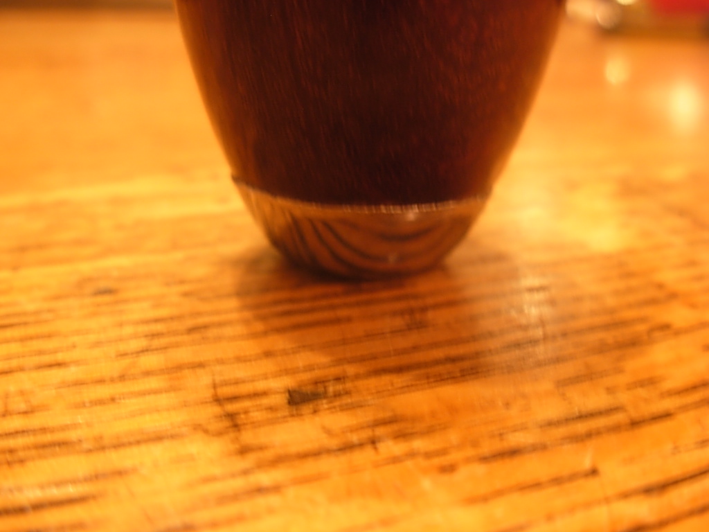

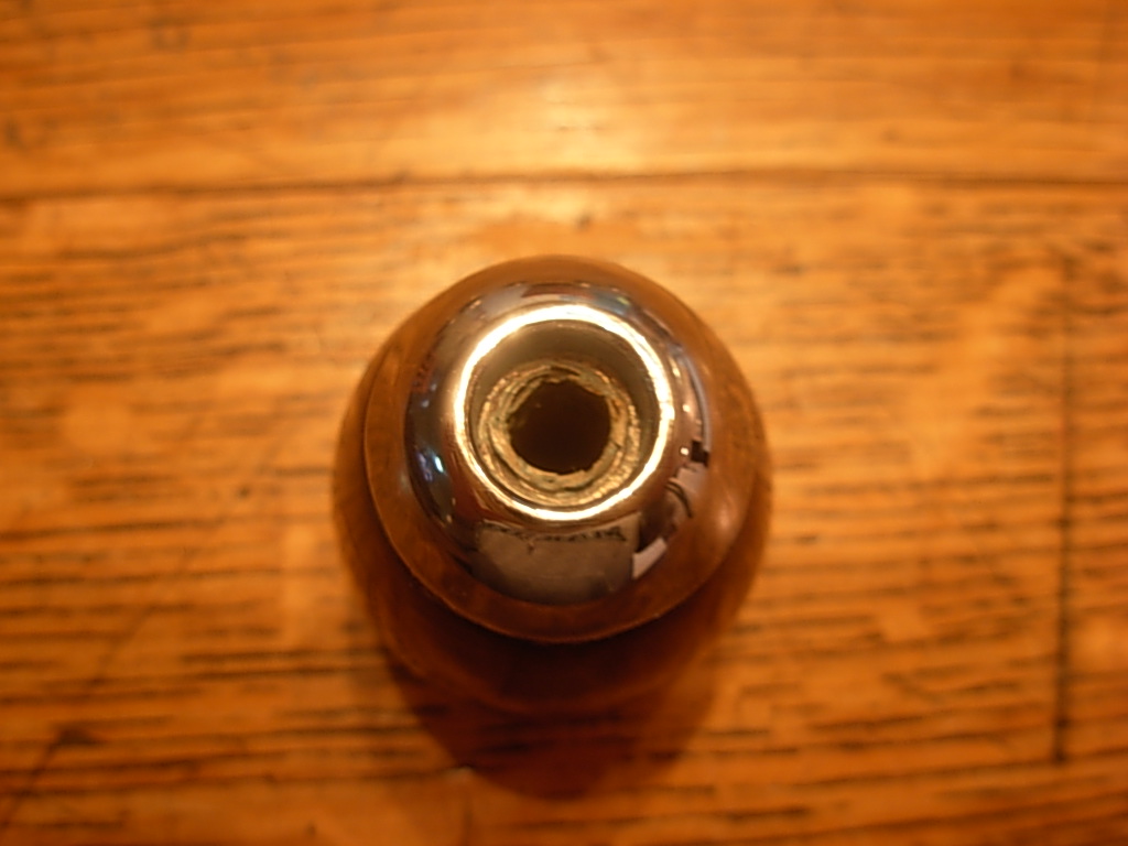

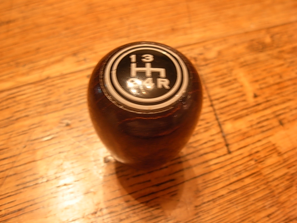

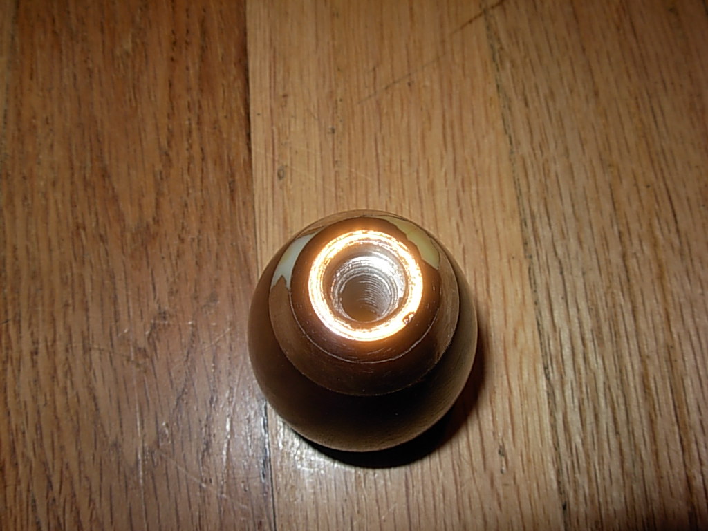

I just left the plastic base and shift pattern on, since I was afraid I would do more damage trying to remove them. I taped the wood and shift pattern with several layers of blue painters masking tape, and stripped the remaining chrome off with muriatic acid. You have to find a place that can chrome plastic. The guy that did mine is no longer in business. After it came back from being chromed, I had to use a tap to clean out the plating that got attached to the threads inside the knob. I re-stained the knob and put a clear polyurethane coating on it. Here are some pictures before (first three pics) and after.
-Mike
Yes, it is one piece. Here is another view of it. You can see how the glue was liberally applied. I used more heat than nessesary to soften the glue, but not enough to melt the plastic. The piece was not deformed or damaged at all from heating and removing it. It was in poor condition and split to start with. The shift pattern insert couldn't take the heat at all before it was damaged from the heat. Be careful with it.

Did you use the heat gun mainly on the threaded hole end, or the shift button end? I was able to gently coax the shift button off with no harm so the plug end is accessable for heat, also. I guess I'll try the heat gun to slowly soften the glue. It would be much easier to chrome, I think.

Dan, if you enlarge the pic in post #5 you may see the glue on the button end that has formed sort of a mushroom shape. This is where I concentrated the heat. Once that was softened, it tapped out fairly easy. I did apply heat on the other end also, but I'm not sure if it was effective or even nessesary.
