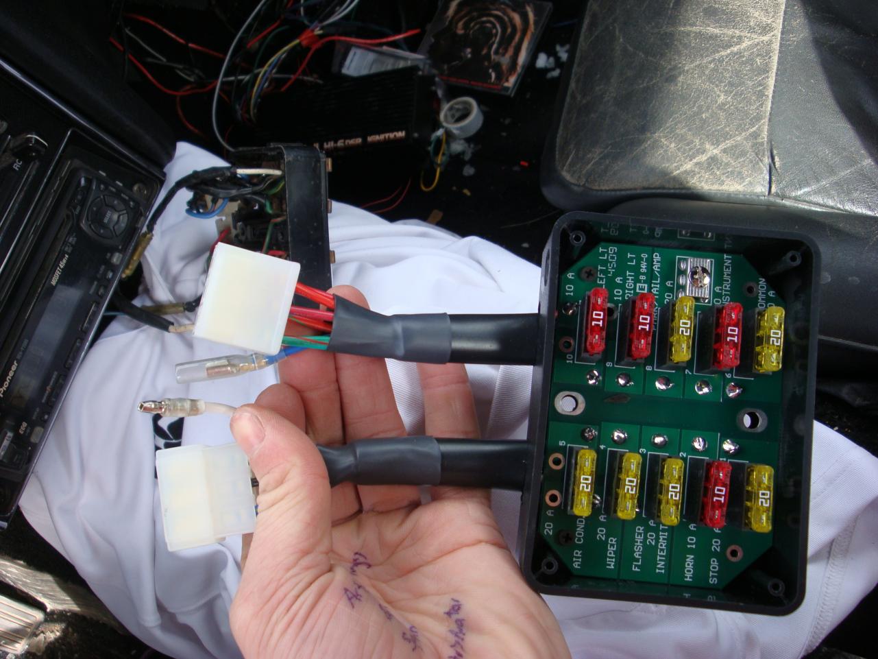

Ordered HLH and PLH (no taillights either) from Dave, as well as the MSA fusebox upgrade for the 72' (short pigtail, I believe).
This is supposed to be a "Plug and play" upgrade, and would be... but I have an extra wire from the orginal fusebox. It is possible that the previous owner tried to mod the OE fusebox to prevent a meltdown. I believe this z came with a halogens, and at one point had a prettty nice sound system.
Whatever it is, no meltdowns running halogens all night accross Canada.

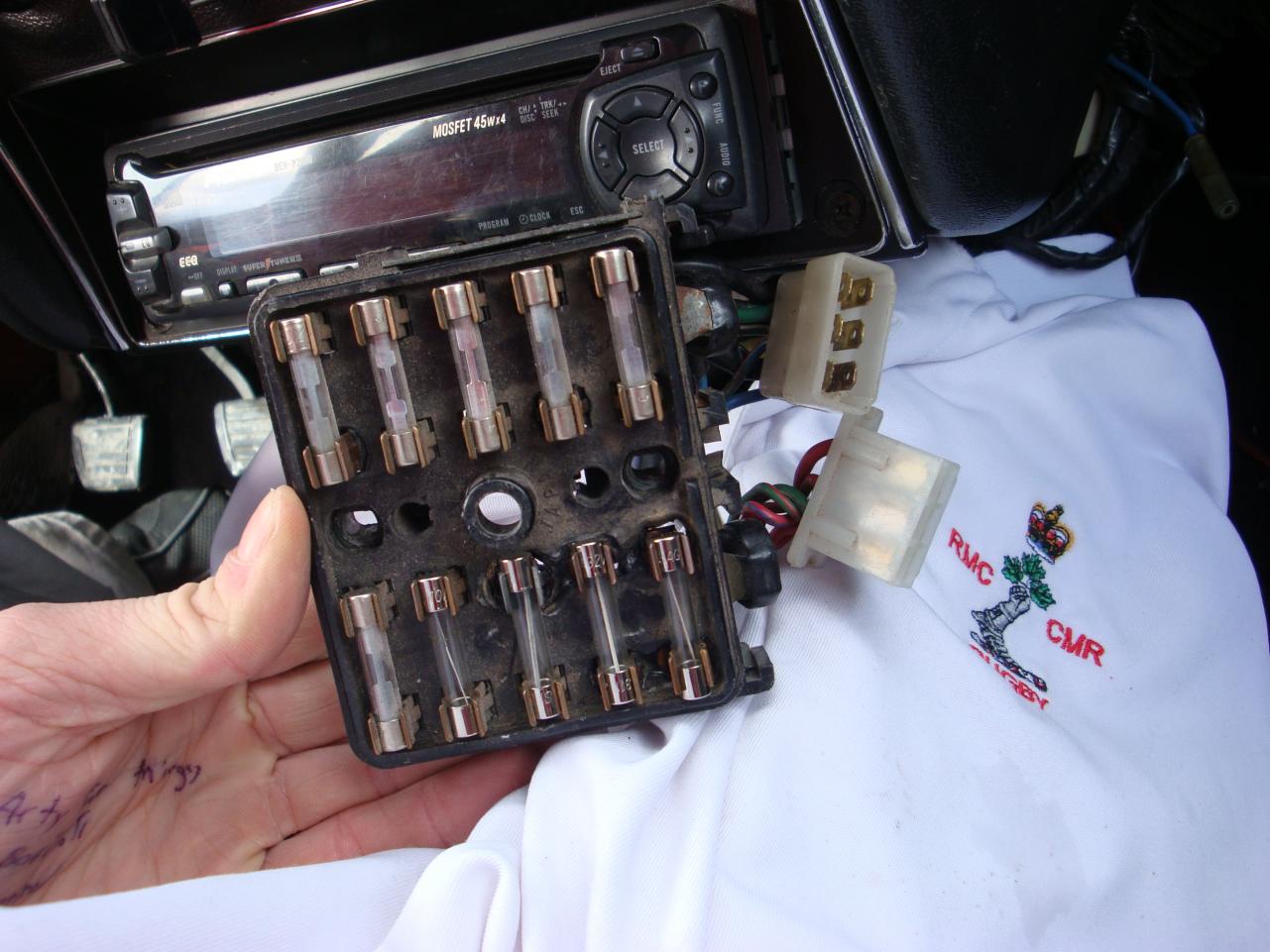

The "extra wire" comes from the rear of the fusebox, and is connected to a metal bridge, spanning one side of the (bottom right) three fuses. It almost looks professional.
This wire looks about 12ga. It's noticeably thicker than the others that connect to the fisebox. White with a red stripe.

I guess that would explain the little metal clamp-screw on the right side of the fusebox, and the hole I can now see drilled into beside where the other wires come out.
