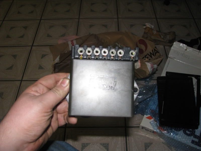

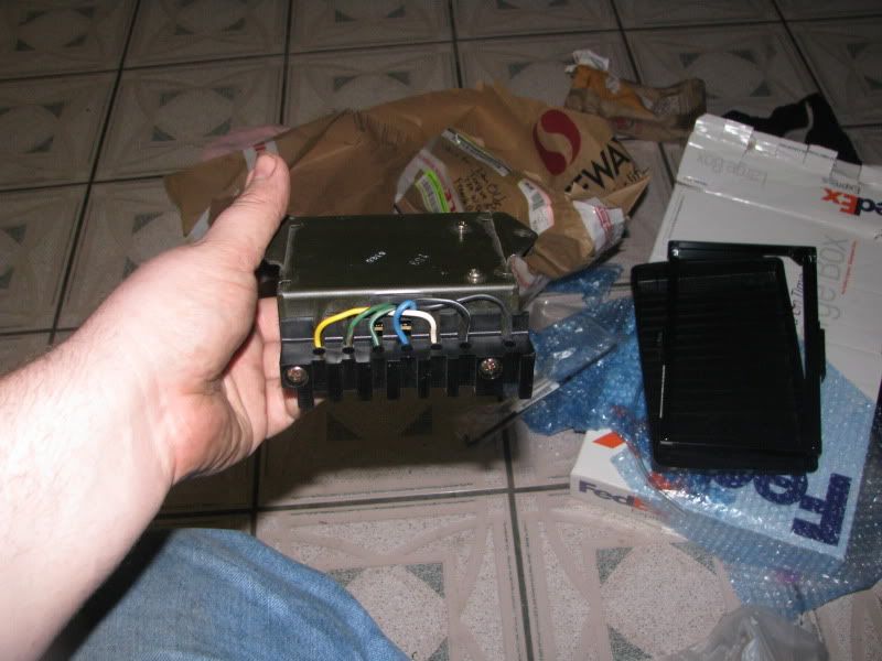

Now one peice i got for the car today has no writting on it and i cant make out the numbers on it
was wondering if i can get a little assist in identifiing what it is
