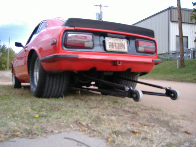

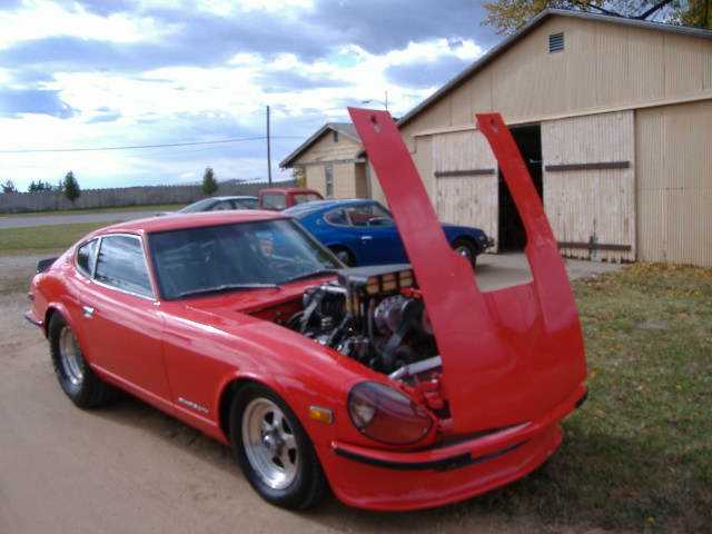

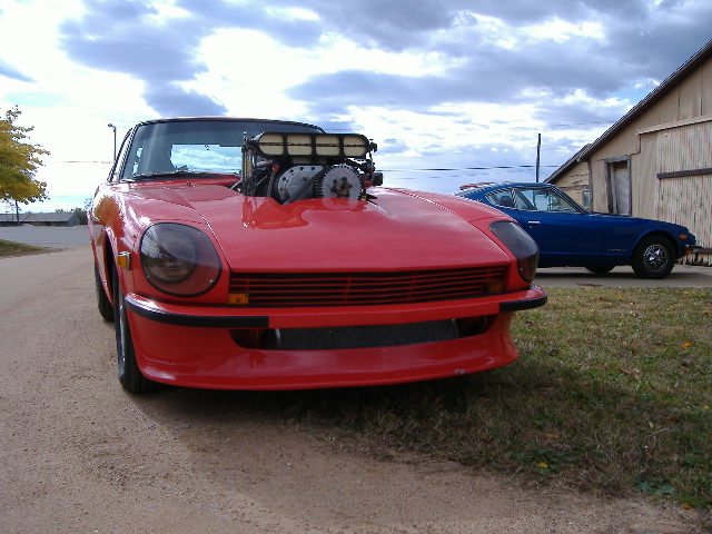

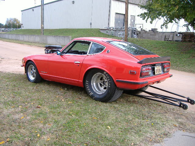

February 21, 201015 yr comment_310228 You might try this site for what he has done to this Z over the 30 years he has owned it. http://www.ratzun.com/ It might be the extreme Z. A 516ci engine with an 11-71 blower, running E-85, puts out about 840hp with as much torque, fastest 1/4 was 8.96, and it's Street Legal. (in KS anyway) Drives it to the track pulling a trailer of supplies. There is no Z metal left between the bumpers and rockers, full frame and cage. It was a joy to have it in my yard. Bonzi Lon Link to comment https://www.classiczcars.com/forums/topic/34820-v8-z-does-it-need-frame-bolstering/#findComment-310228 Share on other sites More sharing options...
