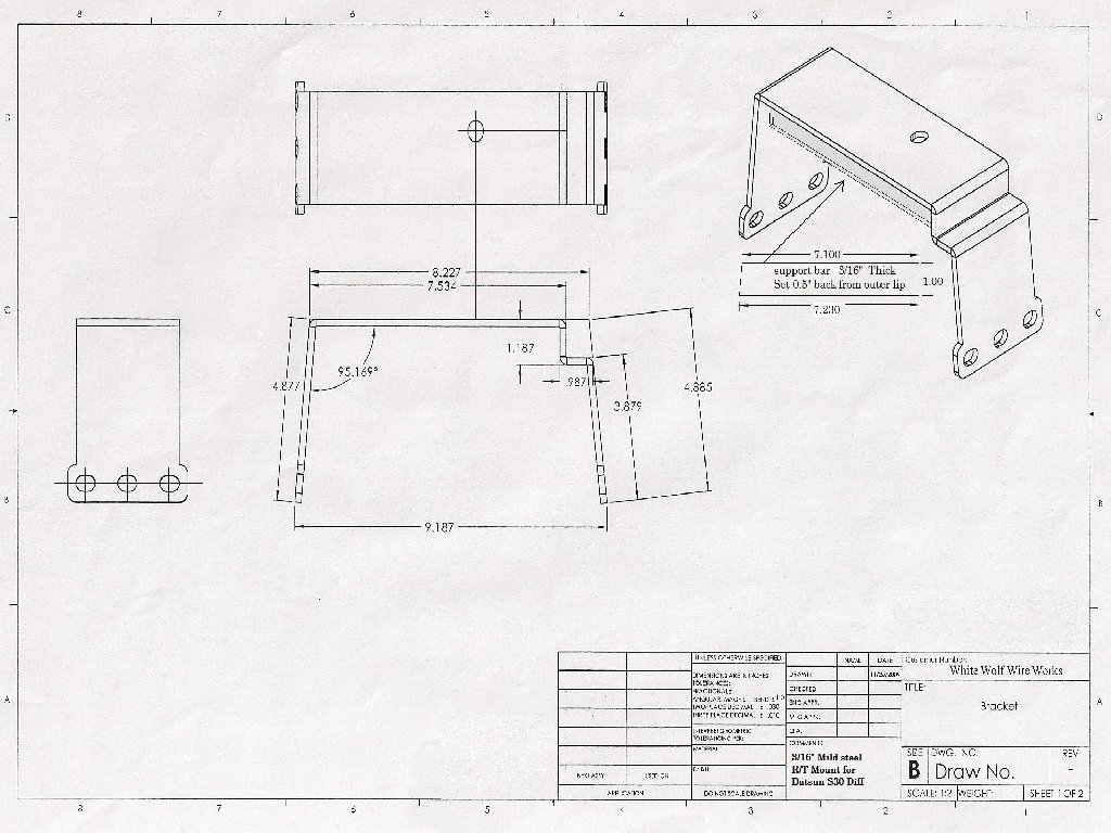

June 18, 201014 yr comment_322847 Anybody out there in Z land still have their R/T mount not installed yet...Looking for the measurement for the hole on the top from the right edge (see attachment) and the center to center measurement of the three holes on the side (see attachment) webdawg1 Link to comment https://www.classiczcars.com/forums/topic/34835-rt-differential-mount/#findComment-322847 Share on other sites More sharing options...
June 18, 201014 yr comment_322875 Mine is from the recent group buy. The top hole is 11mmX17mm oval, 67mm from the right edge (drawing) to center, up 50mm from the bottom edge to center. The 3 side holes are also 11X17mm, center is 12.5mm from the bottom, centers from left edge are 13mm, 44.5mm, 76mm. Hope this helps.Bonzi Lon Link to comment https://www.classiczcars.com/forums/topic/34835-rt-differential-mount/#findComment-322875 Share on other sites More sharing options...
June 18, 201014 yr comment_322932 Bonzi Lon, You da man... Got some folks currently working on a Solidworks drawing for the R/T mount as we speak...so I can take it by the metal shop for them to make reference to...etc...etc. One more question...when you say "50mm from the bottom edge"...you are making reference to what would be considered the rear of the mount (where the plate is welded in on the bottom) webdawg1 Link to comment https://www.classiczcars.com/forums/topic/34835-rt-differential-mount/#findComment-322932 Share on other sites More sharing options...
June 19, 201014 yr comment_322972 Bonzi Lon,One more question...when you say "50mm from the bottom edge"...you are making reference to what would be considered the rear of the mount (where the plate is welded in on the bottom) webdawg1 Thats right, set up like the drawing. The 'bottom edge' has the welded in support. I just noticed the drawings are in SAE. :stupid: My measurments should of been also, sorry. The width measurements appear to be missing on the drawings, or I can't see them . The overall width is 3", except for the ears with 3 holes, it is 3 1/2" wide, 1" tall. Bonzi Lon Link to comment https://www.classiczcars.com/forums/topic/34835-rt-differential-mount/#findComment-322972 Share on other sites More sharing options...
