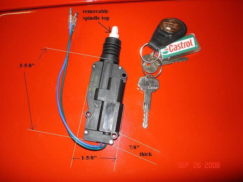

With the brand/model that the PO installed, there was no cutting of the door structures. There was one hole drilled for stabilizing the motor to raise/lower the arm attached to the door lock. It might be more what you're looking for.

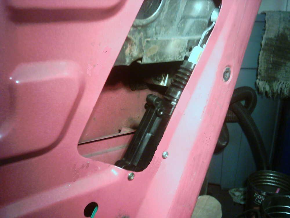

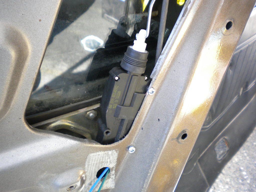

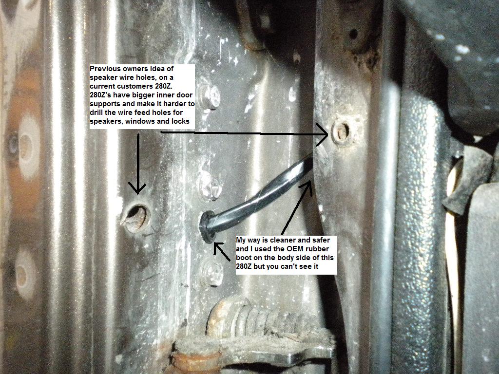

The drilling is the hardest part. I've done power door locks and power windows in over 20 Z's. You need a small drill to reach inside the door and drill from the inside out. 280Z's have an advantage of already having a small rubber grommet on the body, that will allow you to feed the wires into the car after the door is drilled and you instal a rubber or plastic grommet to protect the wires.
Also, you'll likely find you have to grind a flat spot on your lock rod for the actuator's rod Clamp to attach to the lock rod. You can kinda see what I mean on the 2nd picture.
Dave

Well, I found the box for the remote system. The receipt was in it, too. The PO bought it from (now) Black Dragon Automotive. It's the system pictured on the Door/Door Lock Kits page. The part number is 94-403, and the current price is $49.95.
