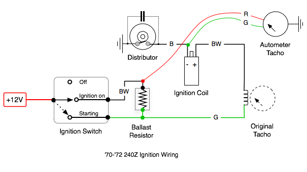

Posted February 27, 201015 yr comment_310839 i just installed an autometer tach in a 1971 240z, i am using the factory tach harness and i now use the green and white stripped wire as my tach signal. if i try to start the car with the green wire connected to the negative side of my coil my car cranks and cranks with no fire and the moment i remove it the car fires right up, i then attach the green wire back to the negative side of the coil and the tach works again. why wont the tach allow me to start the car but runs just fine when attached after the vehicle is on Link to comment https://www.classiczcars.com/forums/topic/34883-tach-wont-let-car-start/ Share on other sites More sharing options...

February 27, 201015 yr comment_310893 This might be a wiring problem, as the ignition does run with the tacho connected, but not while starting. I've attached a wiring scheme of the ignition circuit and added the Autometer tach, if your wiring is different you might want to try out the one in the attachment. Link to comment https://www.classiczcars.com/forums/topic/34883-tach-wont-let-car-start/#findComment-310893 Share on other sites More sharing options...
