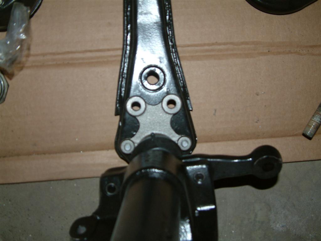

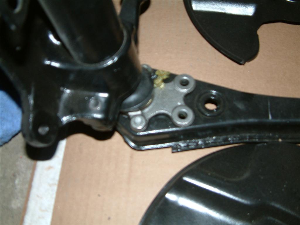

March 3, 201015 yr comment_311265 Sorry, I must have misread your post. So the ball joint sits on top of the control arm, you bolt in the 2 outer bolts to secure the ball joint to the control arm. You leave the other 2 bolt holes open so you can bolt the T/C rods to them once the suspension is back in place. Does this sound right? All 4 holes on the ball joint should line up. I did this 2 days ago and still have my suspension out. I've attached a couple of pictures. If yours doesn't match up like that then you either have the wrong ball joints or the wrong control arms. Can you attach a picture? John Link to comment https://www.classiczcars.com/forums/topic/34914-different-ball-joints-for-different-years/#findComment-311265 Share on other sites More sharing options...
