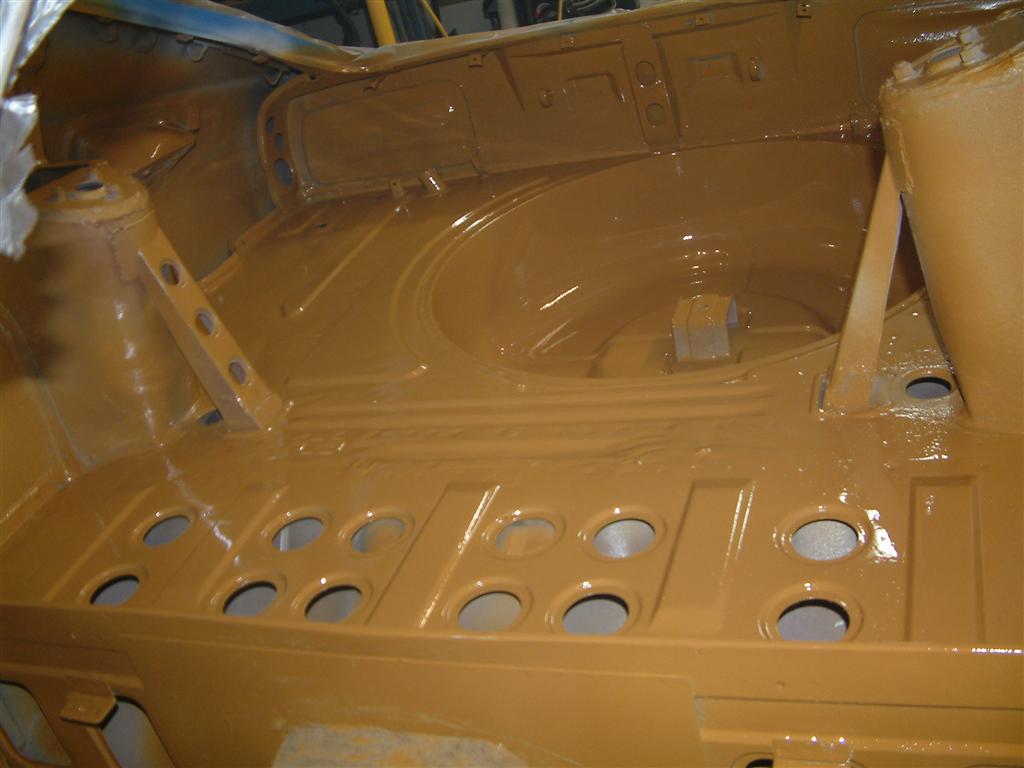

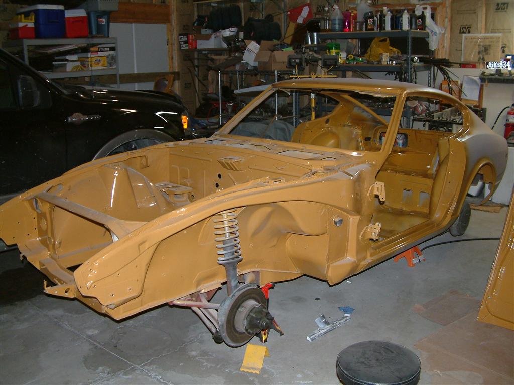

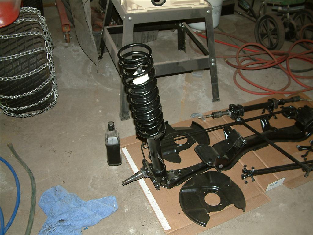

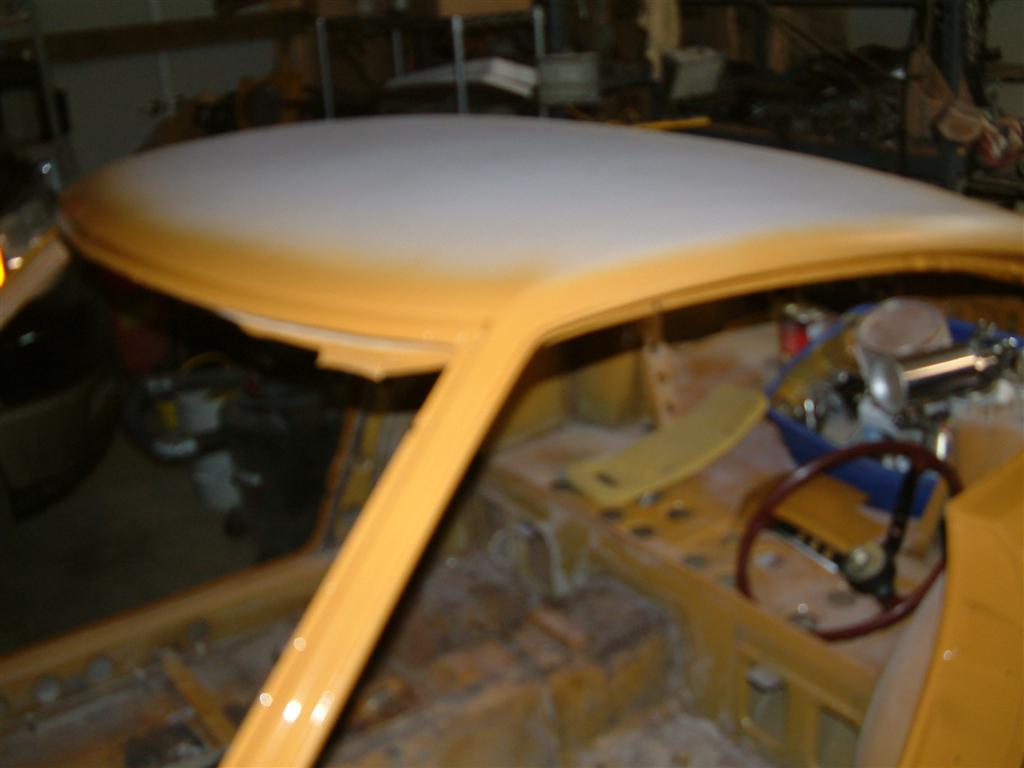

Not sure if you can tell from my avatar, but the entire car was stripped to bare metal and the interior, engine bay, wheel wells, window recesses and under side have all been painted already. I've attached some pictures to give you an idea of where I am at.
I guess I am just wondering what a body shop would expect when bringing it back in. My painter told me to drop in the engine, restore the suspension and put the body back together.
I just dont know what "Put the body back together" includes and he is now in Hawaii for the next 3 weeks and cant be reached.
