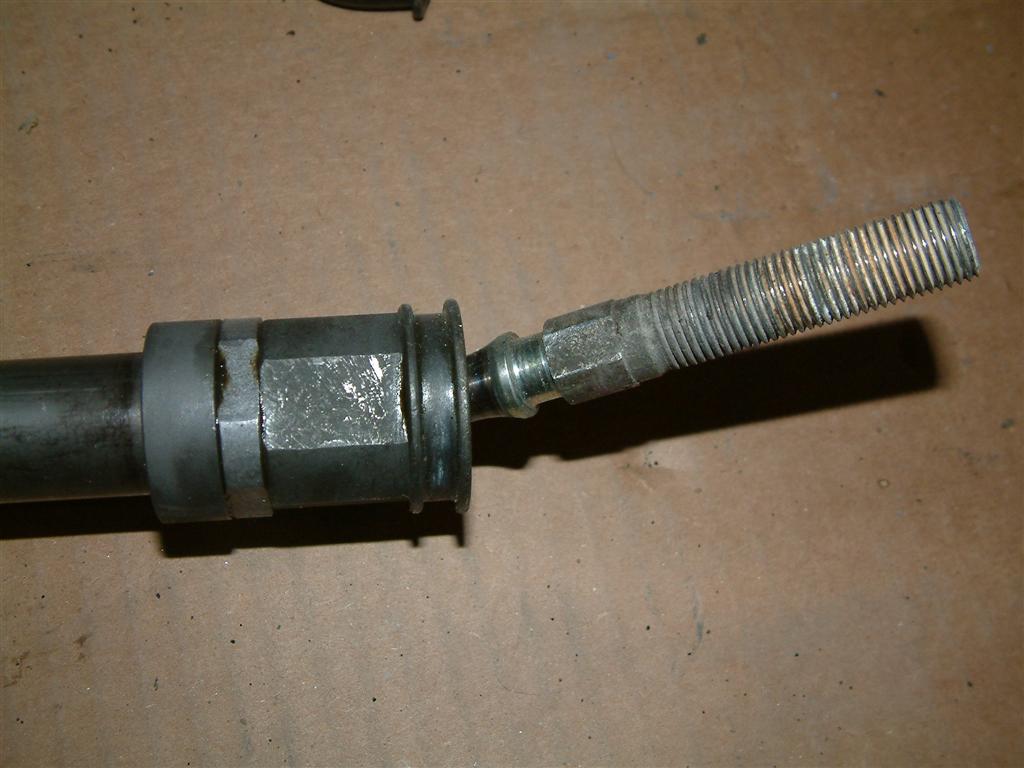

Posted March 6, 201015 yr comment_311657 So I brought my car in for alignment and the mechanic tells me that my wheels on both front sides have some play in them. He proceeded to show me by gripping both 3o'clock and 9o'clock sides of the wheels and shook them. He recommended that I changed the inner tie rod ends, and proceeded to tell me that they were super rare and his friend at the Nissan dealership could source a set for $150 EACH side (told me they were the same on each side). :sick: So I went home and decided to research on the internet a bit more, and came across these inner tie rod ends on rockauto.com: I ordered two of these, and also the Right and Left side outer tie rod ends because I figured.. do it once, do it right. When they arrived this morning I jacked the car up and tried to get a good idea of what I was looking at. I was following these instructions I found over the internet: http://www.biopatent.com/alignment.html When I pulled back the rubber cover of the inner tie rod, and was about to remove the needle and castle nut from the outer tie rod, I noticed the Left and Right Inner Tie Rods were COMPLETELY different than what I ordered... This was the Left (Driver side): and this was the Right (Passenger side): The ADELCO item I purchased from rockauto.com which was labeled for my year (1970 240Z Series I) is totally different from these two pieces. Furthermore, I was told that the left and right inner tie rods were IDENTICAL by the mechanic and another thread on this forum. Also, I am currently searching for the inner tie rods and I stumbled upon this ebay posting: http://cgi.ebay.com/ebaymotors/Nissan-240Z-260Z-280Z-280ZX-Tie-Rod-End-83-82-81-70-80_W0QQcmdZViewItemQQhashZitem439d2a8ff0QQitemZ290399621104QQptZMotorsQ5fCarQ5fTruckQ5fPartsQ5fAccessories This seems to be identical to the Passenger (Right) side inner tie rod that I took a picture of above, but completely different from the Driver (Left) side inner tie rod. Also, in the eBay posting, it says the item is compatible with: "240Z, 70-73 70-73 Front Right Inner, Steering Tie Rod End" I am trying to source the Driver (left) side tie rod, but I cannot find anything online that looks like the one from my picture. Someone please tell me I'm crazy :ogre: So I guess my questions are: 1.) Is the ADELCO product I purchased totally incorrect for my 1970? 2.) Are the right and left side suppose to be identical? 3.) If so, should I just purchase two of the Inner Tie Rods in the eBay posting, and ignore the fact that it says "70-73 Front Right Inner." 4.) If the two inner tie rods are different, is the eBay posting the correct item for the passenger (right) side? 5.) Finally, where can I get the Driver side (left) inner tie rod? Any help would be much appreciated :stupid: Thank you, spitz17 Link to comment https://www.classiczcars.com/forums/topic/34963-inner-tie-rod-help/ Share on other sites More sharing options...
March 6, 201015 yr comment_311665 I have an early Series 1 and they are both the same. See pictures below. Perhaps 1 of yours was replaced. Link to comment https://www.classiczcars.com/forums/topic/34963-inner-tie-rod-help/#findComment-311665 Share on other sites More sharing options...

March 16, 201015 yr comment_312586 Johnny, I appreciate your help... My friend told me the threads might be different for the left and right sides. I know for sure the outer tie rod ends are threaded differently... this would make sense if the inners were as well.. :stupid:Are your threads different? :disappoinSpitz, The outer tie rods are different (reversed) because the inners are identical. So even though the inners are flipped left to right, the outer tie rods will spin on the same direction. I just did mine last weekend and if I remember correctly they both spin on towards the firewall. To verify this, spin the nut that locks the outer tie rods on and you will see what I mean. Also, the microfiche shows one part for both sides:Socket-Side Rod Inner P/N 48528-E6000 QTY=2Section 102, Key No. 10 The microfiche doesn't show any supersession so I would imagine these are good through at least 7/73.Hope that helps.JohnP.S. I had to read my explanation 3 times to be sure it makes sense and I think it does. Let me know if you need me to break it down a little more. Link to comment https://www.classiczcars.com/forums/topic/34963-inner-tie-rod-help/#findComment-312586 Share on other sites More sharing options...
