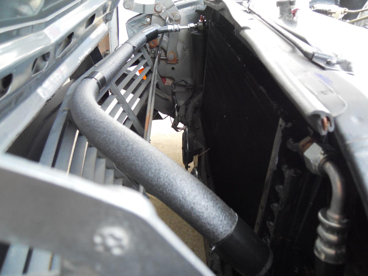

Posted March 7, 201015 yr comment_311724 This form is great. With the help of you guys I have been restoring a very original, zero rust 1973 240Z with 60K miles on it. In the last few weeks I have. 1. New Z-therapy carbs 2. New bushings front and back 3. Honda blower mod 4. RX7 fuel pump mod 5. Dynomat in key places 6. New fuel vent hoses 7. No more exhaust fumes! 8. New exhaust from the factory down pipes back 9. new radiator, mechanical fan and clutch 10. New struts 11. Lots of other bits and pieces Yesterday's project was to replace the old York R12 AC system with a new unit from Nostalgic Air. Nice kit. It included everything I needed to do the job. Here is a photo of my previous system... The entire install took about 7 hours with breaks including evacuating and charging the system. It seems to work well. The vents blow hard and I am getting a vent temperature of about 35F. However, the proof will be how it works in the Texas summer. Next job...blow it all apart and off to paint! Link to comment https://www.classiczcars.com/forums/topic/34968-successful-ac-install/ Share on other sites More sharing options...

March 8, 201015 yr Author comment_311859 congrats Steve!I am about to take my AC out of my car. I know some say its crazy to remove a working factory AC, but I never use it, and my Z is more of a toy than a daily driver. I would love to see your nostagic air upgrade though. Can you show us some pics? Also, I have a question.. how hard is it to remove the interior bits of my AC system? I would think I can do this in one day.. what is your opinion? My car came with the original 1973 dealer installed AC unit. I removed it the day after I bought the car. It took me about 30 minutes to remove the entire system. Very straight forward. The Nostagic air system looks the same inside the car. Under the hood the old York compressor is replaced with a smaller, modern 134a unit that goes either below or instead of the smog pump. In other words, under the hood is a cleaner install, under the dash...not so much. I will say the system blows super cold and strong at the moment (35°F at the vent 70°F ambient) but I will reserve judgment until it is 100°F and 75% humidity here in Texas. I will get some photos uploaded soon. Link to comment https://www.classiczcars.com/forums/topic/34968-successful-ac-install/#findComment-311859 Share on other sites More sharing options...
March 8, 201015 yr Author comment_311860 hey steve! nice looking 73! i have a 73 also and i just recently installed a/c and an aluminum radiator. i bought the a/c unit from courtesy nissan and installed everything myself, going today to have my uncle charge it up.I would be interested to see how you routed your hose to the dryer under the hood. It looks to me like Courtesy and Nostalgic use the same system. The way I have it installed, the Nostalgic hose is a couple of feet too long from the evaporator to the dryer but I may not have them routed correctly as the photos in the instructions were impossible to decipher. It works the way it is but I plan to clean up the installation when I blow it apart for paint so any advice on routing would be great. Link to comment https://www.classiczcars.com/forums/topic/34968-successful-ac-install/#findComment-311860 Share on other sites More sharing options...
